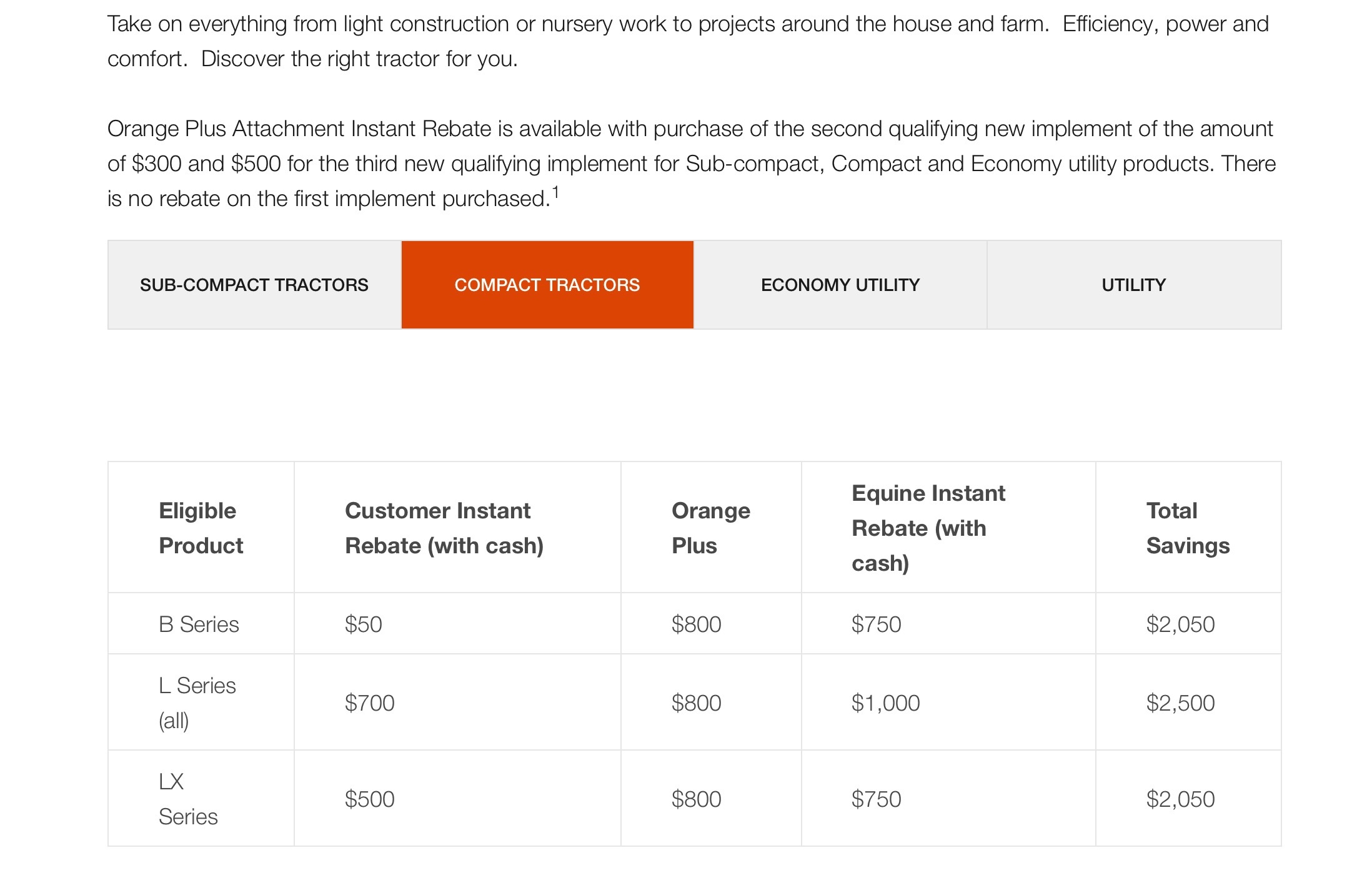

Awesome.
I remember when Kubota was offering 20% discount on the tractor and implements using the NCHA membership.
Those were the good old days :)
