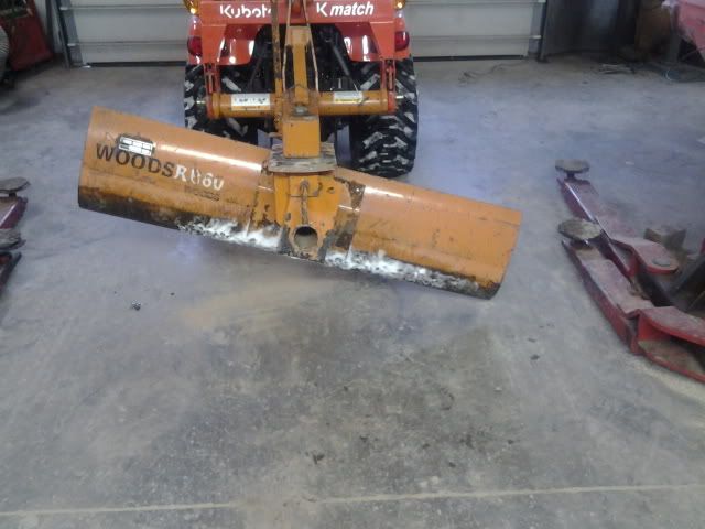

I put my draw bar on and raised my lift arms up all the way and measured the center, its 24 1/2" will a tilt blade work?

That was how I measured mine. Was that measurement to the quick hitch or lift arms. I am going to have the blade on toady I will raise it to 24.5" and see if mine will tilt.

Roger, I got my quick hitch on, I raised it up as high as it would go and measured from the center of the draw bar to the ground and that's 24 1/2".

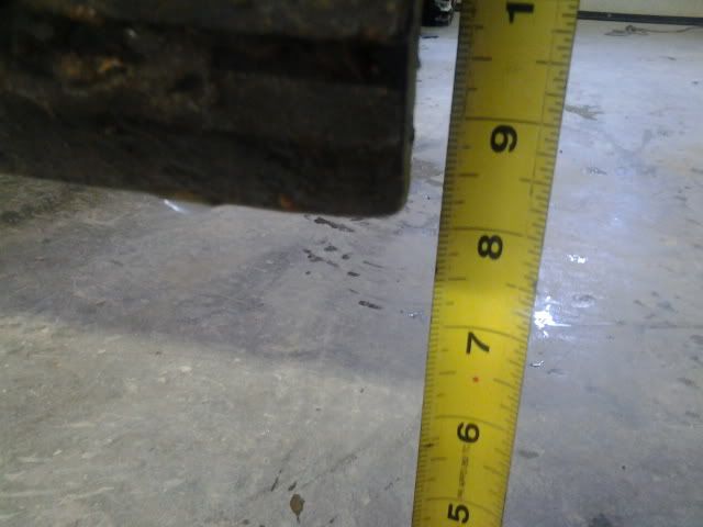

Here is how the blade was sitting before I raised it. It is sitting a little low in the front but it is close to level.
Here is the blade @ 24.5"
A closer shot, a 2x4 just barely slide under it so there was a hair more than 1.5" of clearance
This picture is without the blade tilted.
You can use these pictures as a idea. It may vary some on your tractor.
