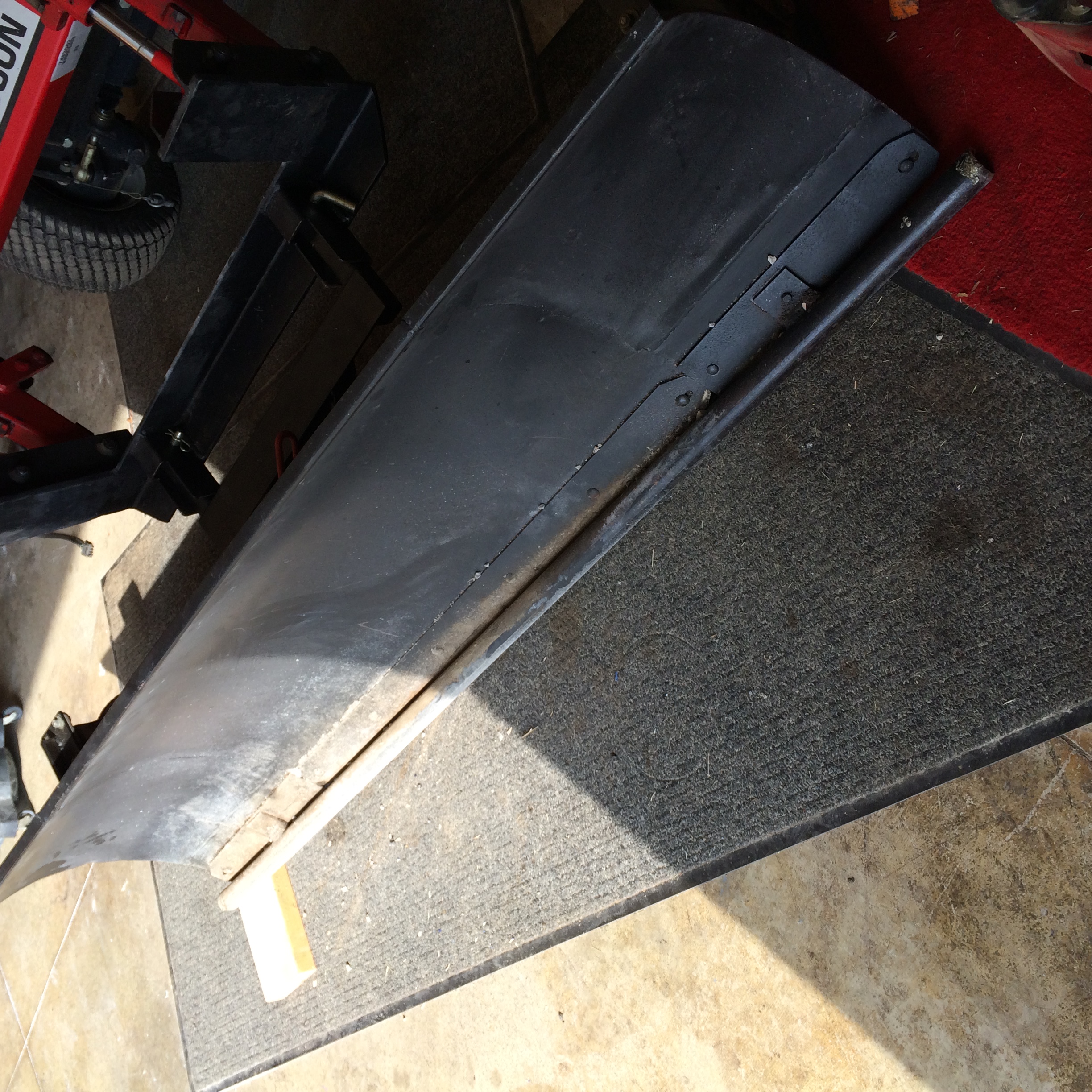

Stupid question which has probably been covered in another post, but how do you cut the length-wise slot in the pipe? I don't have a cutting torch so is there a mechanical method that isn't too terribly time intensive?
The question isn't stupid. But, slotting the pipe is. It's totally unnecessary.
Weld on some tabs, and use the bolts that hold the cutting edge on, to hold the pipe on. Or, drill some holes where you would like.
Very simple job.

It's a good thing someone is here to let some of us know how "stupid" we are. "Stupid" me looks at the picture and thinks a tractor of any size or weight is just going to bend those tabs up so the pipe is not only not protecting the surface being plowed but it is interfering with the flow of snow moving across the blade.
I guess I need to git me some book learnin.

I did the same thing several years ago and it has been fine:
I used 1/4" bar stock for the tabs. Been through three winters with no issues.
First, I didn't say you were stupid, I said cutting the slit is stupid. And, sorry, after 8 years of use, it works just fine, pushing or pulling the plow.
However, you could weld on 10 tabs, made out of 3/8 plate, if you like. That's still much easier than trying to cut a slit in a piece of steel pipe, which is still going to need something to hold it on anyway, when you're finally done.
Suit yourself.
