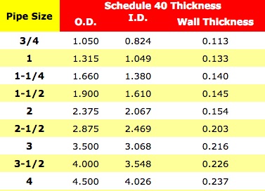

You posted a chart on tubing, not pipe
Edit: I didn't pay close attention to your chart but you are correct in the OD sizing. My original post was concerning the statement that schedule 40 was one OD while Schedule 80 was larger which is not correct. The OD on both schedules of piping is the same regardless of thickness. Tubing OD changes with the schedule thickness so that the ID remains the same. PIPING OD doesn't change regardless of schedule thickness until it reaches 14" nominal pipe size when the ID remains the same just like tubing.

View attachment api spec 5L.pdfSee table 4 of attachment on API 5L piping standard.
   / What size pipe did you use for your rear blade’s cutting edge? #15
The point I was trying to make with s219 is when I said I am using 1/2" pipe, I'm not talking about the outside diameter, I am talking about the inside diameter which is how you buy pipe. I should say, nominal inside diameter so I don't get called out on that too.
I can see in the charts the O.D. doesn't change according to what schedule pipe it is, but it is still called 1/2" pipe and is .500 plus inside diameter.
   / What size pipe did you use for your rear blade’s cutting edge? #16
I suspect nominal pipe sizes were once accurate inside diameter, when the walls were weak, thick lead. Later iron pipe needed to be the same outside diameter to fit the fittings.
