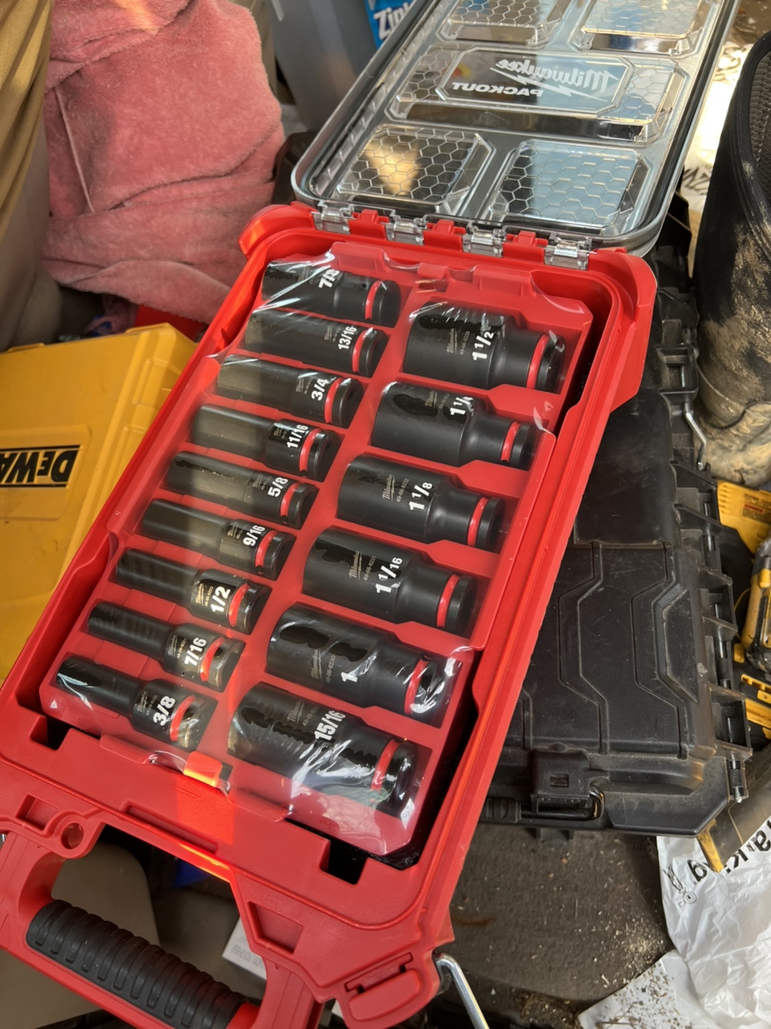

The metric set I picked up was this one, seems pretty go for the even low price.... Think I payed the full $50 price...
/ What size impact sockets are needed? #8
These packout sockets aren’t the best value, you could get a harbor freight set for under half the price but it’s worth it to have them organized vs falling all over the place.

These packout sockets aren’t the best value, you could get a harbor freight set for under half the price but it’s worth it to have them organized vs falling all over the place. View attachment 807984
That case would be broken in 3 days in our work environment. lol
If it's branded 'Milwaukee', I run away quick. 'Milwaukee' stuff is over priced generally.
I like the Milwaukee pack-out system for sailing gear, all the organized bins to sort pins, shackles, ring dings, bobbles, and the big bins for lines, foul weather gear, etc. Great to be able to wheel it off the truck and right down to the dock. Also, relatively weather-proof, so all your gear stays dry, even in nasty coastal salt-water environments.
But I wouldn't even think of using that plastic crap as an actual tool box around tractors and equipment! Like Hay Dude, I think I'd break it in less than a week, and that comes from someone who actually owns a bunch of them.
Yeah, they've got an insane mark-up on that crap, they'd probably make a killing selling it at half of market price. But for a very portable and stackable system that keeps gear dry in the bed of a pickup sitting by the boat ramp in salt spray and rain, it works better than other things I've tried.
