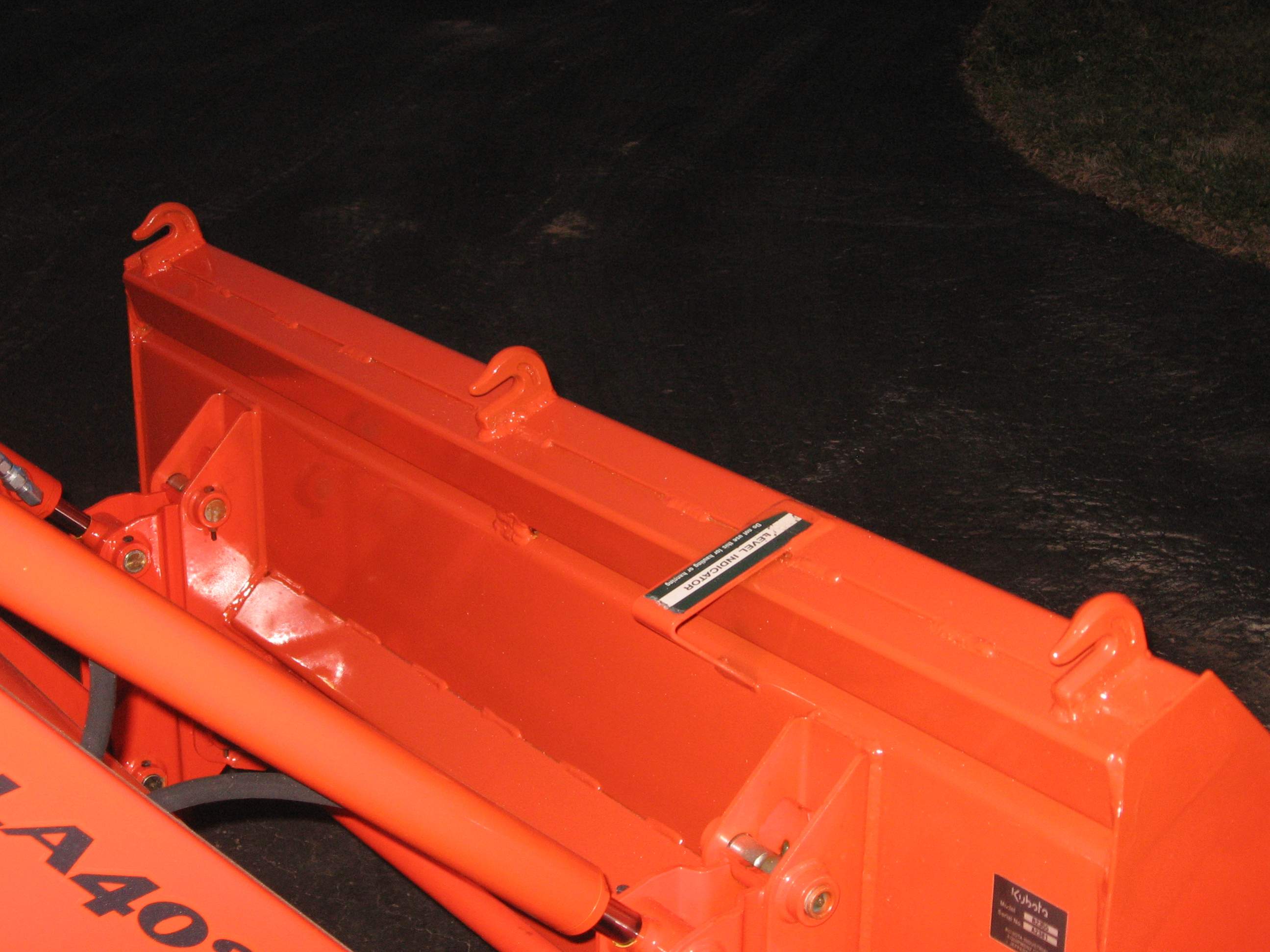

I find that every hook and projection welded to the top of a bucket gets used.
I've set up my last few buckets with a length of heavy wall round steel tubing welded across the top instead of angle iron. The stuff I use is about twice the wall thickness of normal steel pipe. It's Pricier than steel angle, but nicer to look at and easier on the chain
I like a "clean" installation, so my hooks are usually welded to a piece of steel mounting plate which is then bolted to the bucket. That allows me to put a plate or some really heavy large washers inside the bucket which farther spreads out the stress.
Plus there are a couple of closed rings mounted close to the ends of the bucket. These are for tying rope or hooking the ends of nylon straps for when I'm roping a large item into the bucket to take it somewhere.
I've got a some heavy chains for ultimate strength, but usually end up carrying and using a couple of 12 foot lengths of quarter inch lifting chain with grab hooks on each end. This chain is light enough to handle easily and strong enough to big chain all day. I like a chain with short wide links for flexibility and prefer either no coating or galvanized over (ugh) paint or plastic coating.
good luck, rScotty

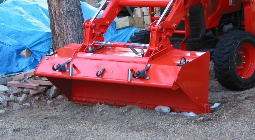

Here's my B3030 with weld-on hooks and reinforced.
/ What size FEL hooks #9
That's a real nice job. I like that angle iron idea like so many people reinforce with. My old eyes probably won't let me weld that good anymore but I gotta glob some on some way some how.

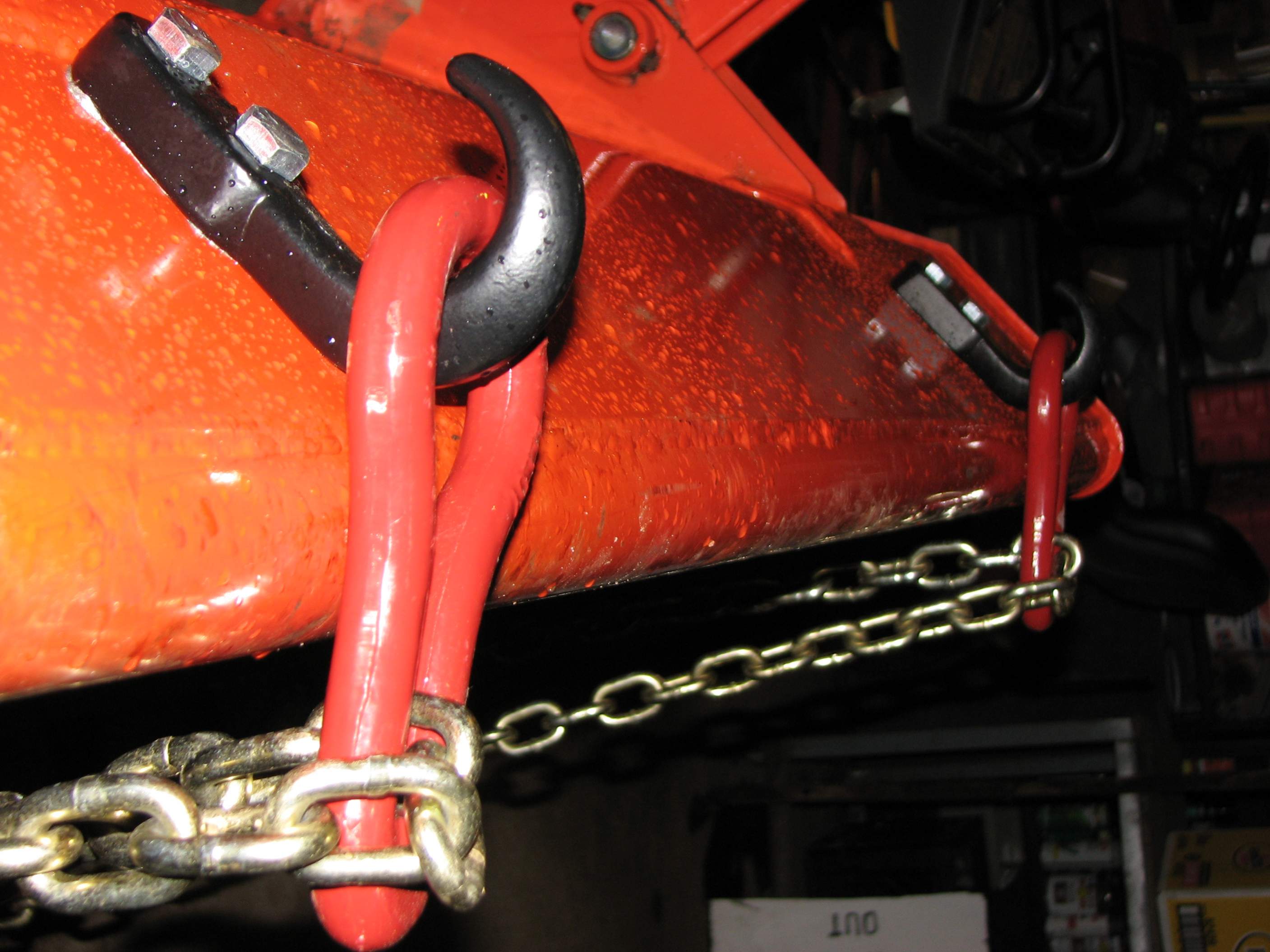

I used RV style slip hooks from TSC - about $10 each, I think. At the time I didn't have any welding equipment and drilling & bolting was a quick solution that has work well for the past 3 years. Like Easygo, I prefer to work with ropes most of the time. They weigh a lot less than chain and are much easier to work with - especially when you are dealing with lengths of 25 ft (or more). If there's a lot of dragging to be done, or abrasion is a concern, then I switch to 5/16" chain and use grab links on the slip hooks:
