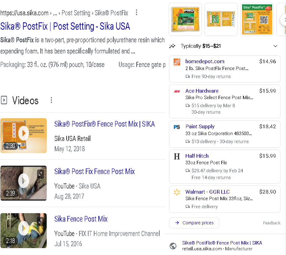

I've seen 3x the size online but nobody seems to do that in real life. What size bit would you use for a 4x4 post? I will use either concrete or the foam stuff, probably the foam, so maybe the hole should be smaller diameter?
The hypotenuse of a 3.5" x 3.5" post is 4.95" so you would need a 5" auger. A actual sized 4"x4" size requires 5.66" or 6" auger.
