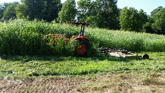

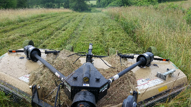

im running a 12ft batwing commerically with no issues. Any thing that is really tall and think I just slow down a little ForumRunner_20150718_172030.pngForumRunner_20150627_071738.png
