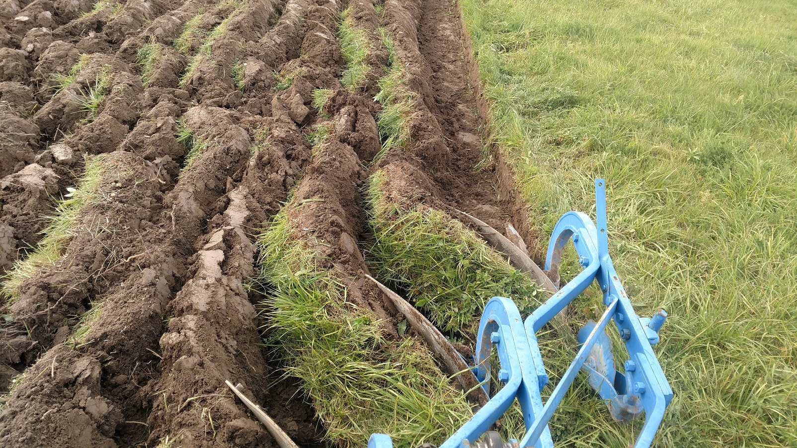

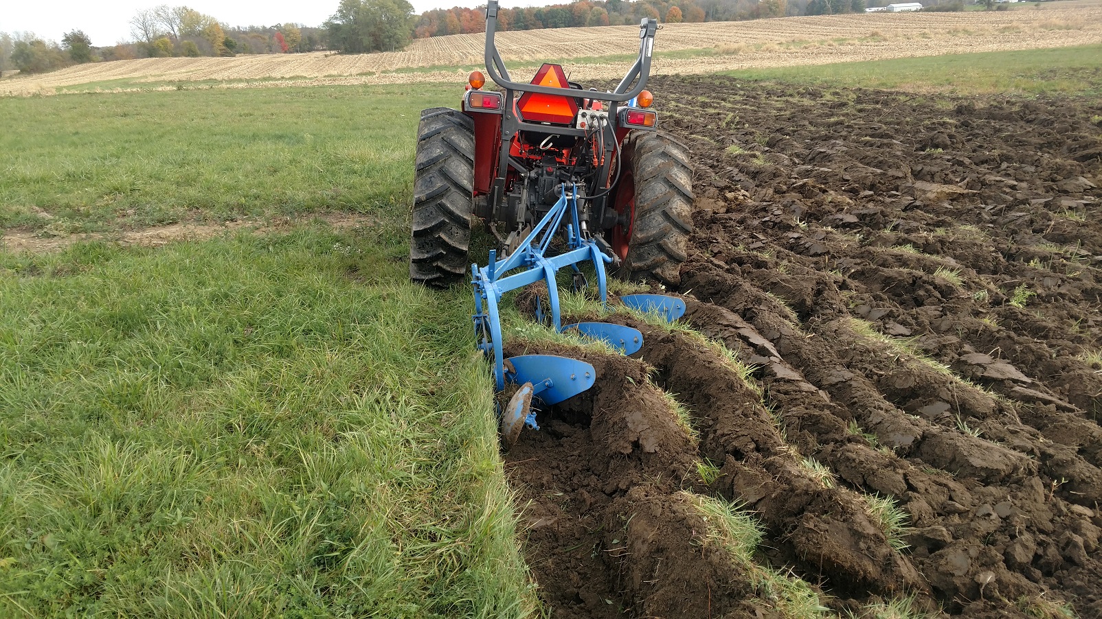

What type or brand of three bottom plow are you pulling?
Dont know. Either a Ferguson or dearborn, But I think ferguson. I am may have mis-spoke earlier and it may be a 3-14, really cant remember now. But the manual is just way too conservative across the board.
