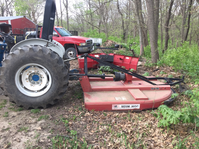

Found a bush hog 287 in my home town. Will my ford handle it fine with FEL on the front to knock down brush? Asking price seems steep at 2500 as well...

I'm listening to the advice here on the locusts and will hire that out. The bush hog would be for the timber which is pretty thick with honeysuckle. And then for the pastures when i get the locusts removed.

Bought it (bushhog 287). Little dusty in the picture from trying it out but put it to the test tonight with honeysuckle and it ate it right up. It's heavy and I feel it back there but my tractor seems like it handles it just fine. Probably helps to keep the FEL on.
Using the FEL to "feel" my way through through the brush and weeds works amazingly well. Now if I just had a grapple to lift up the brush and logs when I run into them... I smell another big purchase coming :)
