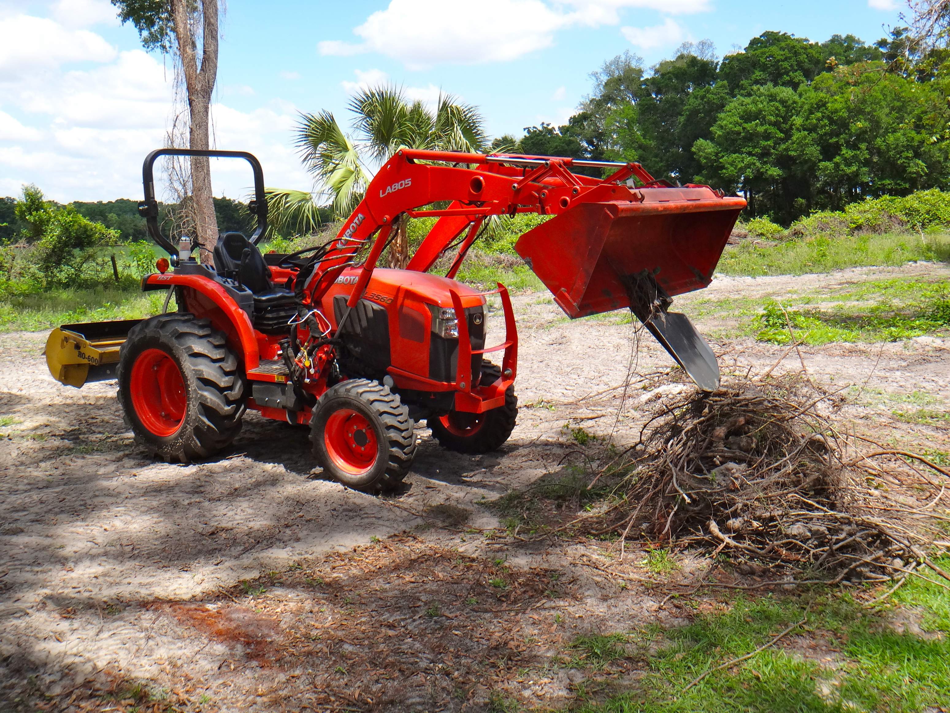

For removing Multiflora Rose corms and small saplings a $400 bolt-on Bucket Spade for your FEL is an effective attachment. I have dug TONS. (Some of the corms I have dug are 70 pounds; 20-30 pound corms, daisy-chained together or in clumps, common.) With a strong backed helper and a disposal trailer you can remove a lot of corms in one day.
A Tooth Bar will be slow for this type removal because it will dig corms in pieces and you will spend too much time sorting through a large volume of dirt trying to find the pieces. With practice a Bucket Spade removes corms entire.
LINK: http://www.tractorbynet.com/forums/attachments/328798-bucket-spade-today-fel-bucket.html
See Post #11 in LINK for corm removal; also review blue SIMILAR THREADS BOX at foot of page.
