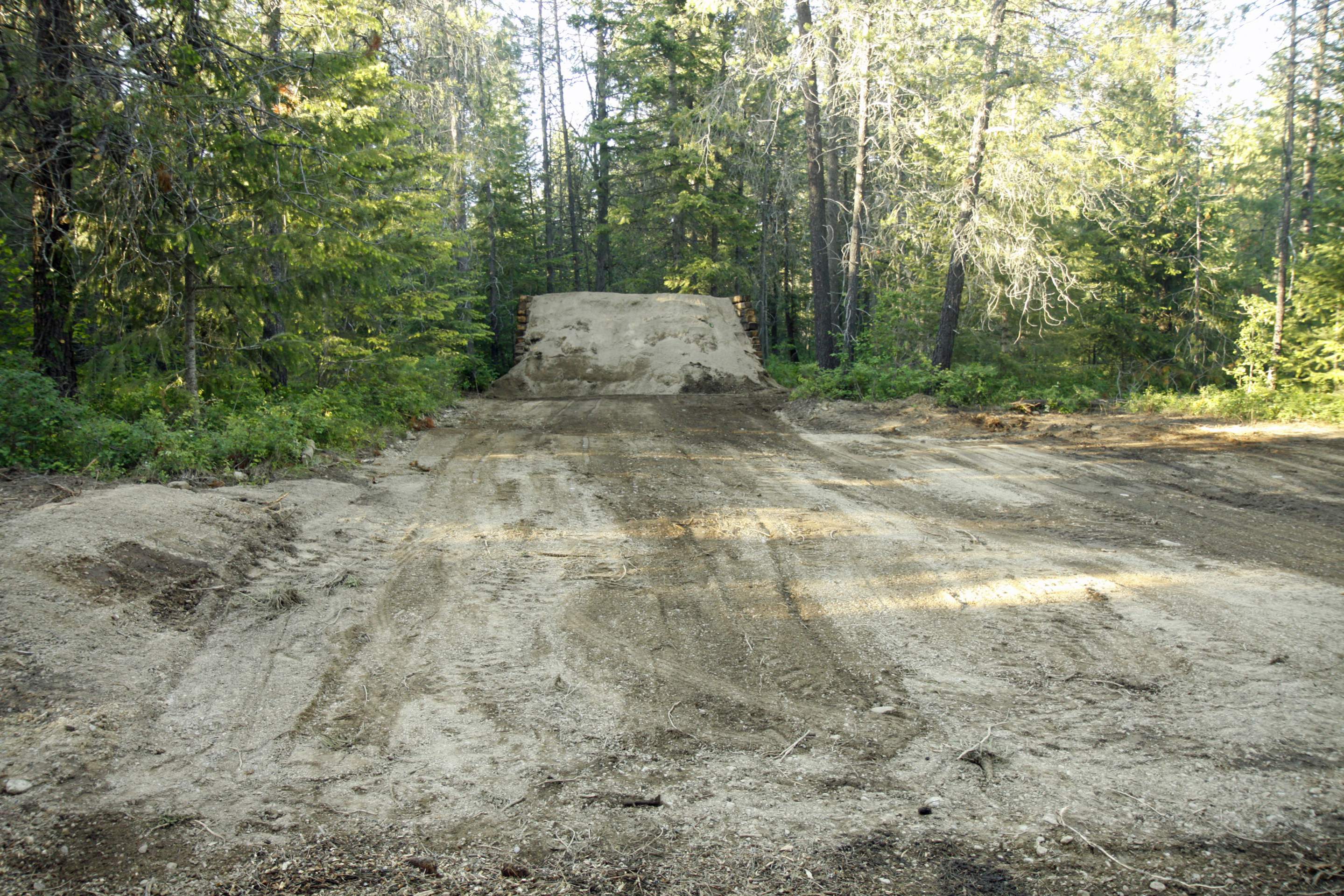

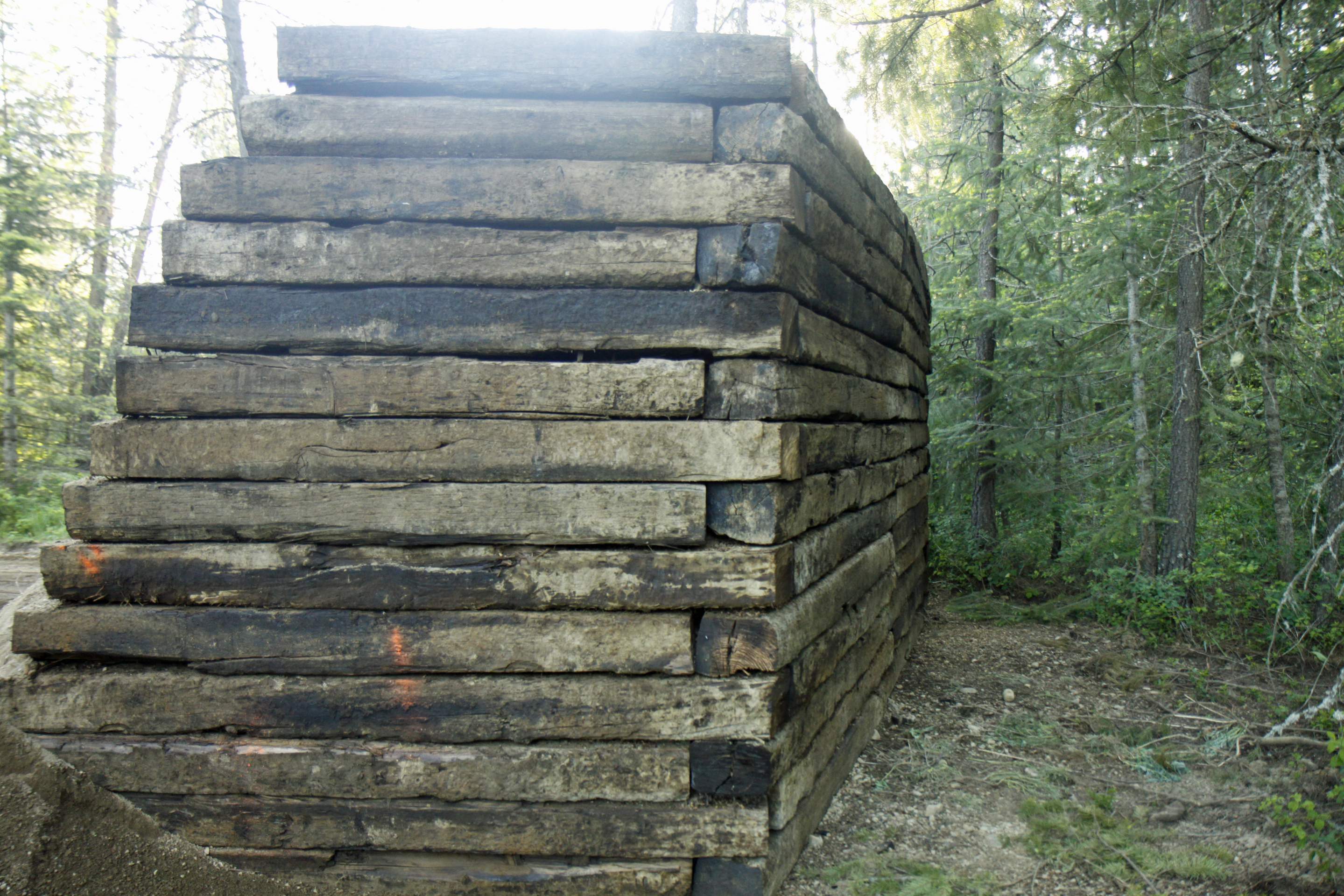

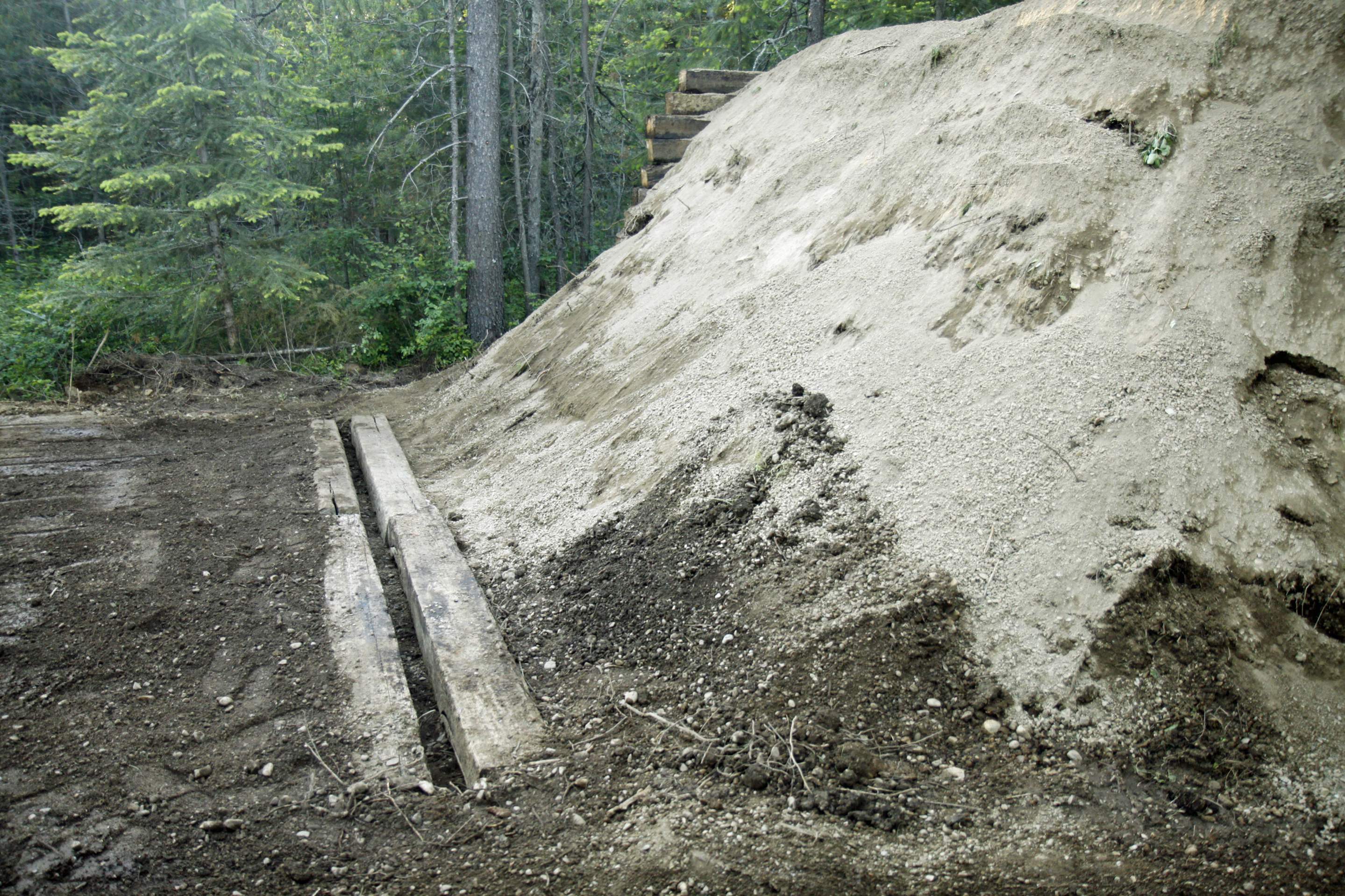

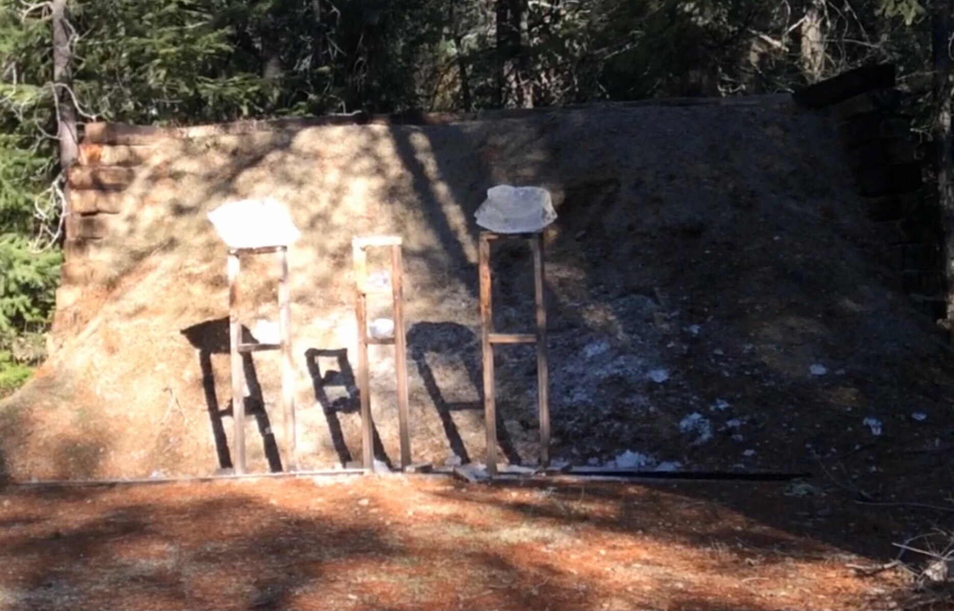

On my target range, i arranged a double row of rail road ties and buried them. left a 4” gap between rows. I can simply make my 2x4 shooting frames and simply place them inside gap.then i place a small x piece of scrap 2x4 at base and screw the upright posts to base. Extremely sturdy. I use the small base crosspiece to straighten the stands….gives me a bit of adjustment.
