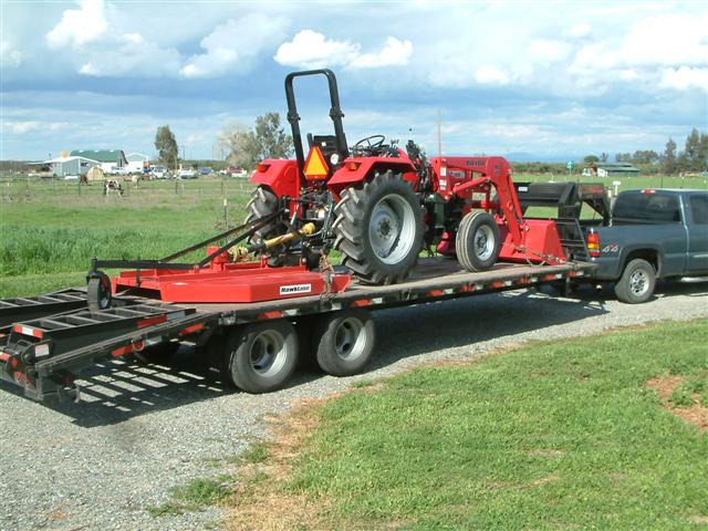

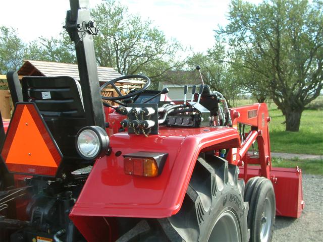

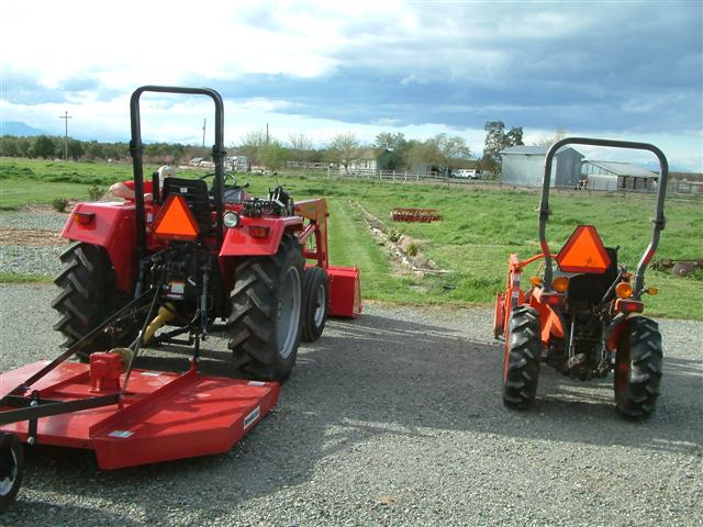

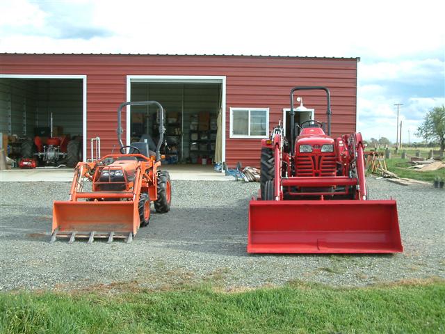

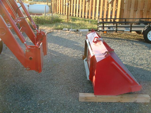

My go-to tractor that I use for most work around my place is a 2008 Mahindra 5525 (54 hp engine, 45 hp pto, 2WD, gear tranny 8F/2R, power steering, triple hydraulic remotes) with the ML250 FEL (6-ft wide bucket,2950 lb lift to 10.5 ft height, three chain hooks, skid steer quick attach option). Cost: ~$19K new. It's probably worth $14-15K now. The mower is a 6-ft brush hog (aka bush hog, slasher, shredder) that cost $1100 when I bought the tractor.
DSCF0051 (Small).JPGDSCF0061 (Small).JPGDSCF0062 (Small).JPGDSCF0067 (Small).JPGDSCF0110 (Small).JPG
This info will give you a reference point on cost for a 3-year old tractor in the 40-50 hp range with typical options you'll want/need. If you want a hydrostatic tranny, add a few $K. Cab with A/C, heating: add a few more $K.
