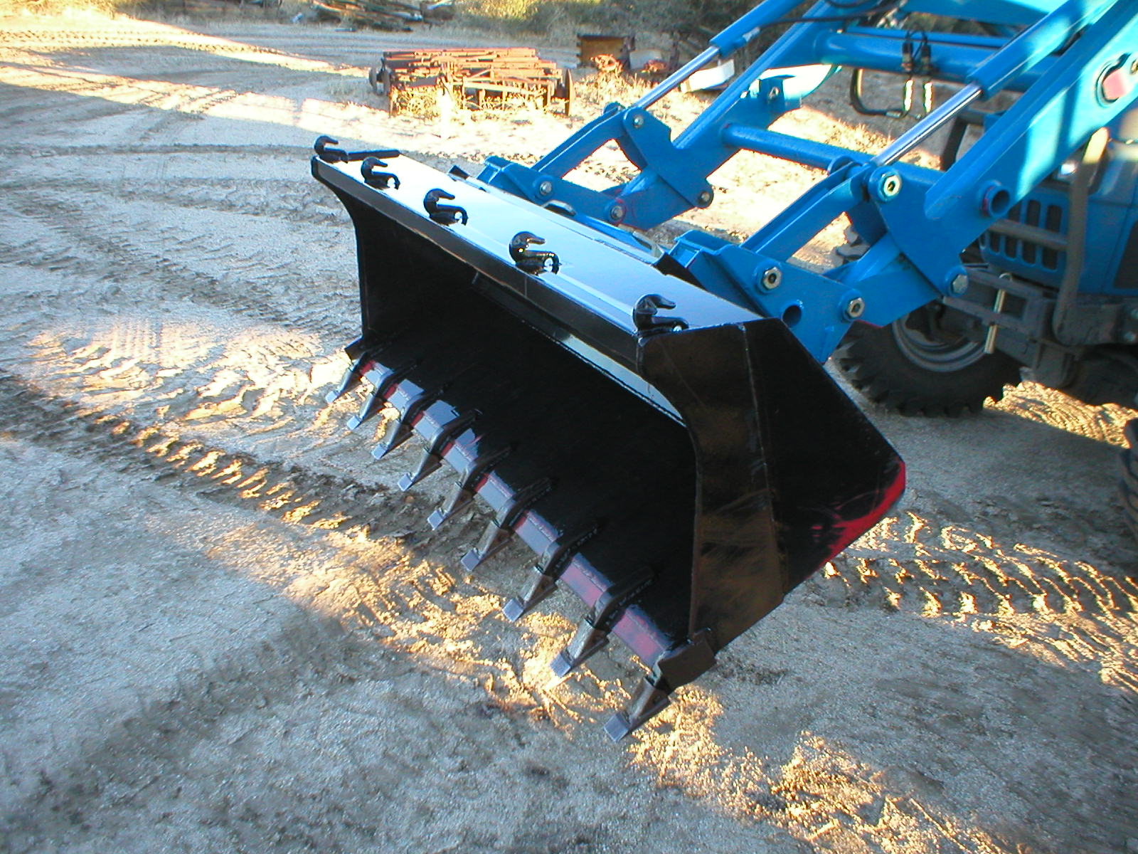

David, I put 5 on my 78" wide bucket and those are over an added 3/8" 2"x2" angle. Best to keep things straight while you can. I also added some 3/8" plate to the sides. ;)
NIIIIICCEEEE!!!! :thumbsup:
