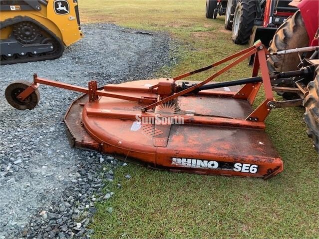

I also see a Rhino "SE6" for sale for $1,500,,,it is a 2010 model. Don't know anything else. tried to go on Rhino's website but it was confusing. I didn't see the SE6 , maybe they don't make it anymore. I have seen some good reviews on here for Rhino. Just trying to figure out the specs of it and if it is more heavy duty than the BH. It also has a slip clutch. With it being older they will probably work on price more
