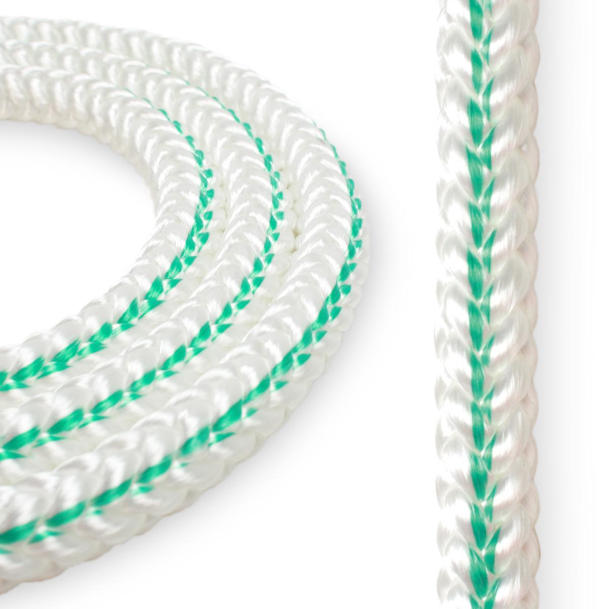

Growing up with a avid rock climber I knew lots of knots and lots about rope. We would generaly use old climbing rope for tree work but that ususly just ment getting the trees on the ground. I recently got a 5/8 static (dosnt strech) arborist rope to pull some trees a direction I wanted. It does just as good as a old dynamic climbing rope.
Dynamic ropes (stretch) ropes can be nice because once the tree moves theres still a load pulling against it. Where as with something like a chain the tree may only need to move 12in and the chain is slack.
For moving of logs on the ground I use chain. Anything over head i use rope.
Something like this arborist rope would be a good all around rope for someone starting out. I wouldnt get anything shorter than about 120' any where in the northeast.

I second arborist line, especially because I get it so CHEAP.
90% of my use is felling trees or strapping stuff down for movement.
Bought it from CMC Equipment & Training | Rope Rescue, Access, SAR, Height
It's sold as short sections for something like $75/50 lbs of rope and it was a mix of diameters, colors, etc. It was SUPPOSED TO INCLUDE some small diameter ropes (cord), like 1/4 inch but never did. But each box included about 4 to 5 hundred feet of rope, shortest piece about 10 feet, longest about 110 feet, all ideal for my uses. All the rope I received was very useable, and well worth $1/foot. I must have bought 3 boxes over the years and given a lot of it to my sons.
Heck, in researching this response I decided to buy another box. Now they are charging shipping, so it come out to ~ $110 for 500 feet of rope.
