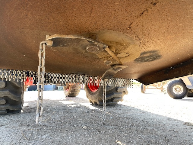

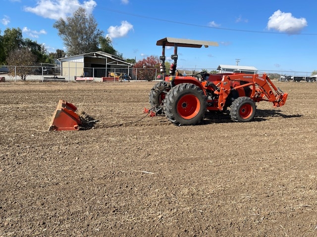

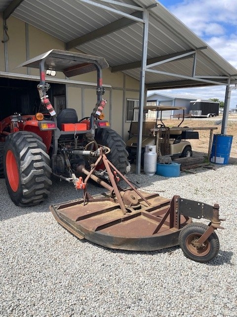

I have a flail with the hammer knives shown in previous posts. I mowed the neighbors rocky field it cost me $400 for a new set of hammers. This was the motivation for the chain mower conversion. It works so well I use it on my non rocky fields as well.
Small rocky fields can be groomed and cleared of rocks.
