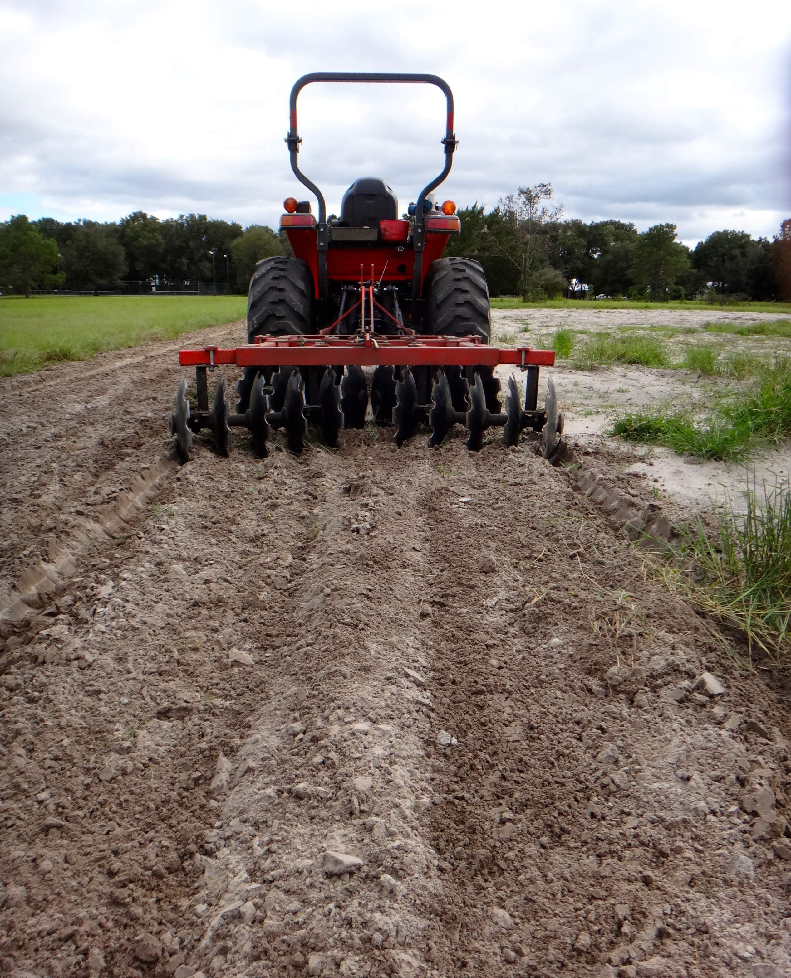

Note: OP pulls his 8' X 12" Disc with 20-hp and 2-WD.
While not entirely clear, the OP's Disc Harrow apparently has 12" diameter pans. It would useful as a smoothing Disc for use after a 12" Moldboard Plow but I expect OP needs to make several secondary tillage passes.
In my experience, having owned both sizes, the lightest Disc Harrow which is effective has 18" diameter pans, with 20" diameter pans first size which is really effective. With a Disc Harrow with 20" or 22" diameter pans and annual use, the OP could cease plowing after breaking the ground once with his plow.
A 8' X 22" Disc Harrow would require the XU5055C to pull it reliably.
