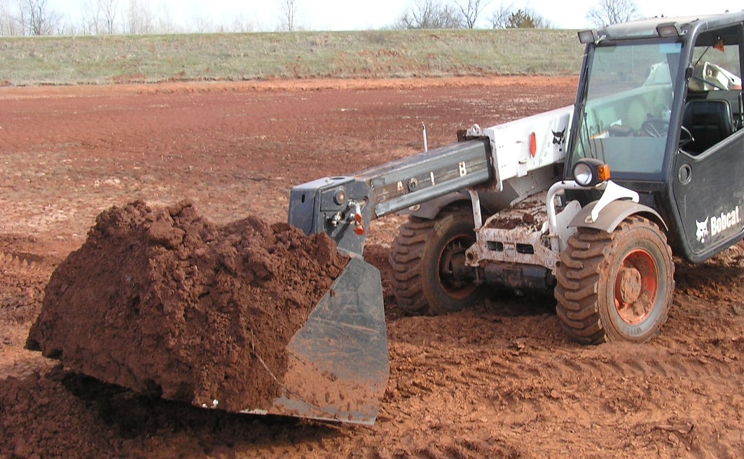

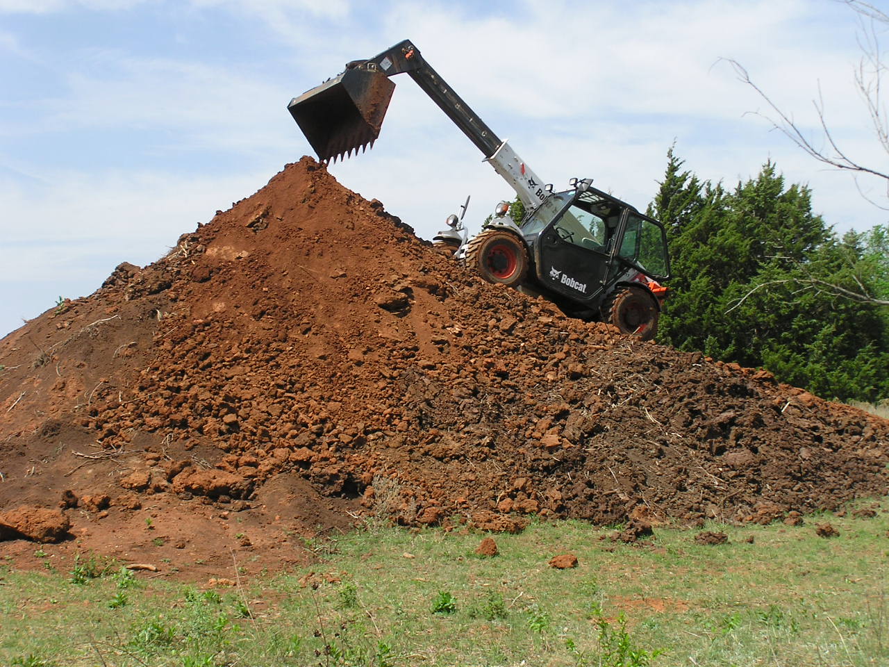

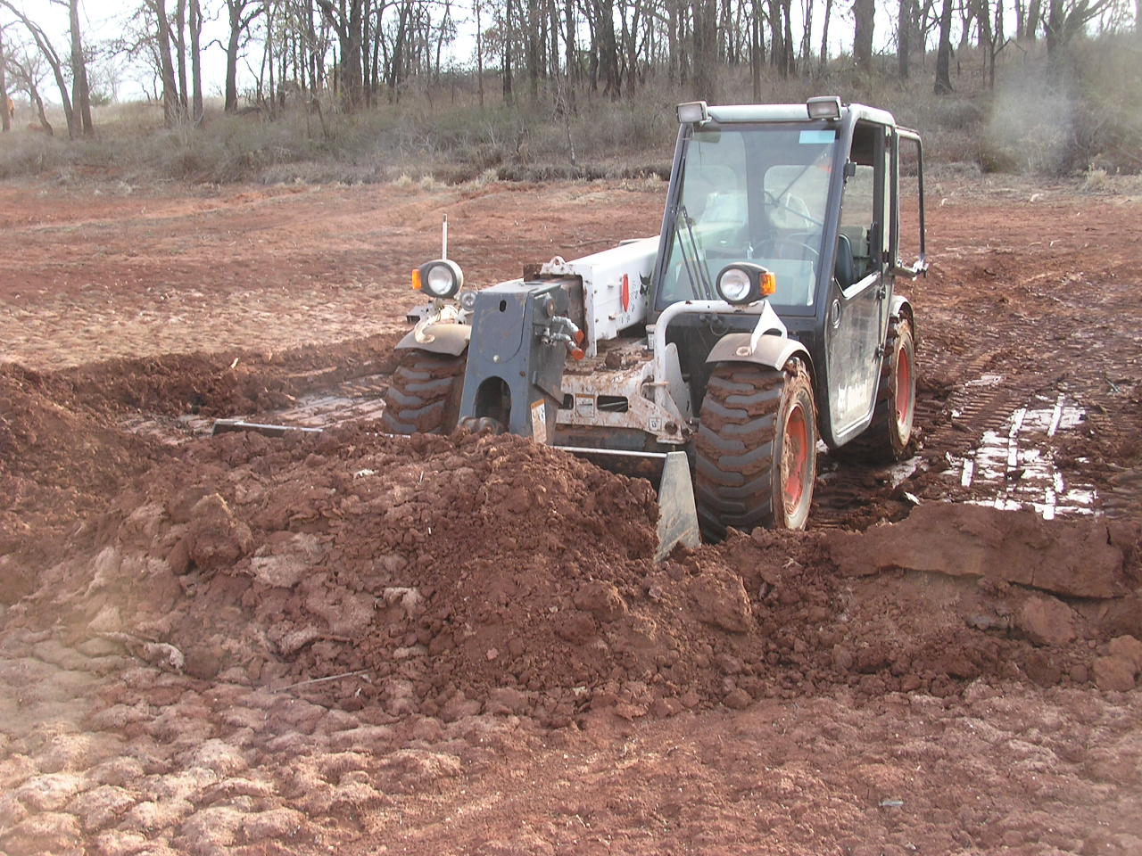

True for full size but a Compact Telehandler will out dig a CTL. I know that from personal experience with both machines using a one cubic yard toothed bucket:
https://www.tractorbynet.com/forums...pact-telehandler-post3243370.html#post3243370

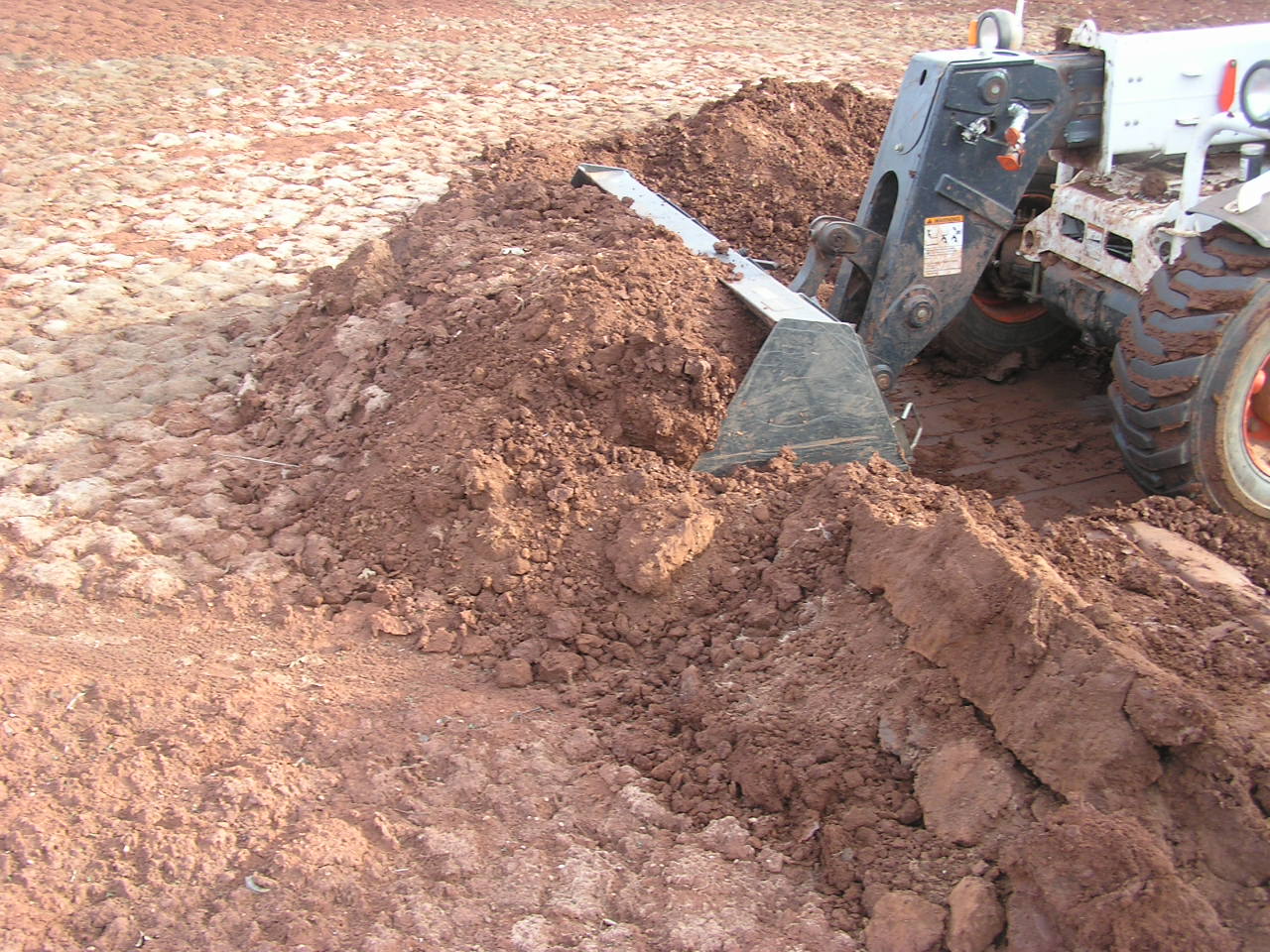

I don’t think they’d compete with a skid steer for precision dirt work like spreading fill in a garage or spreading fill against the house for drainage and finish grading a yard. They’d definitely be better for setting trusses. I’d say the loader is a little stronger than the m59 but not as strong as the 310. I don’t think the m59 loader will be a problem and will do everything I want. Another thing I don’t like about the skid that the TH wouldn’t be any better at is 360 visibility. It’s exhausting to work a skid in tight areas and constantly have to be aware of every corner position.

/ What machine would you want to do this task? #16

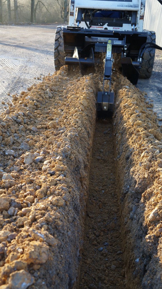

They can't dig a footer or utility trenches. So I'll still need the mini excavator or backhoe.
They can dig a footer or utility trench:
I have used the stump bucket to dig drainage trenches:

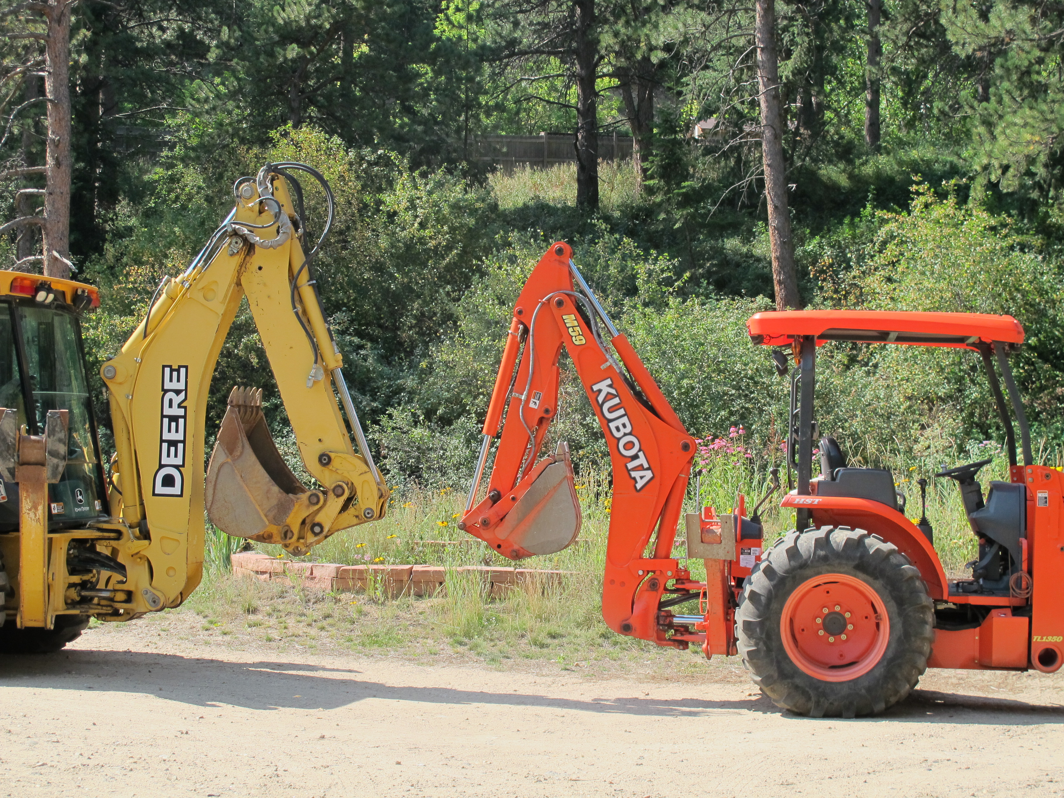

That's what I would do. For the past 5 years I've owned both a JD310SG with 6000 hrs and an M59 with 1000 hrs doing flood repair, landscaping, and some general backhoe work.
First things first: reliability. Both machines have been reliable - although right now the 310SG has some sort of problem with it's temp gauge that I can't seem to find & I'm too stubborn to call out the dealer. I sure wish there was an online forum as good as TBN for JD310 TLBs. If something similar went wrong on the M59, there's a ton of people here on TBn with knowledge who can help.
Otherwise, both tractors have had their main boom hydraulic cylinder rebuilt, but for different reasons. The M59 had to have a throttle cable replaced. And that's about it.
Both start and run fine. The M59 has a 6 range HST and the JD310 has the 4 speed powershift. Both are MFWD. The M59 is better on snow and ice. The M59 transmission is much handier for loader work than the 310 powershift. The 310 is much better traveling down a road with a load in the bucket. It would be better anyway, but the 310 has comfort ride & I didn't add that to the M59. Should have done so. The 310 also has an air seat which the M59 lacks but sure could use. In spite of that, we use the M59 a lot more just because it is nearly the power and much more handy. I ought to add those things to the M59 & maybe will someday. Or not..... :)
The 310 with a tall vertical exhaust sure beats the M59's low exhaust in the fume-eating department. I keep meaning to put a vertical stack on the M59, but it is nice not to have it there to hit things.... tossup..
The JD can lift and carry more than the M59, but you almost never need to. The M59 has a 1 cu yd bucket & 4000 lb lift capacity. Even heaped up you just can't stuff much more than 3000 lbs in that size bucket - which the M59 handles with ease.
The JD310 has a much heavier 1.3 cu ft FEL bucket & 6000 lb capacity, but not nearly as good visibility as the M59. The M59 can load it's bucket fuller and quicker with less hassle and damage to the surroundings. The JD carries a load without bouncing so much.
Both machines are can lift a full load high enough to load a dump truck.
Same for the backhoe. The JD is more powerful, but the M59 has plenty of power for the hoe. Both hoes have plenty of power to pick the machine up and shake it like a dog with a bone.. The M59 has a thumb and the JD doesn't. Big difference there. Lots of time it is the thumb that makes the difference. Having a hydraulic thumb is almost like having a whole extra machine on site. I don't have a 36" BH bucket. Both tractors have quick change BH bucket attach - but I usually use a 24" bucket.. But I'd guess that either tractor has enough backhoe power to use a 36" bucket in average soil about the same. The M59 doesn't care whether it has the 24" or 12" bucket. More than enough curl and lift power. I use 24" on either machine in rocky soil. It's about the same.
The M59 has an open platform with a thick insulated canopy versus the JD310 which has a cab with heat & AC. I am lucky because I can choose to work on nice days. On nice days the open platform M59 is much more convenient for actually getting work done and I really like the big insulated canopy. It's usually plenty. But in nasty weather the JD310 wins hands down - as long as you aren't always getting in and out of the cab. If so, it's a pain.
The 6-range HST on the M59, thumb, and smaller size plus nearly as much power as the 310 but with half the weight all mean we use the M59 more. It's always the first choice unless we need the extra reach of the JD backhoe's extendahoe. Then we use the 310 and glad to have it..... but after that extra reach job is done we usually park the 310 and get back on the M59.

Are they really nearly comparable machines? On paper the 310 is nearly double on every aspect which is why I bought it to start with. I don’t like the 310 bucket or any other tractor loader bucket. The 90 degree triangle buckets on a SS are much better. If I can convince my dad to buy a M59 instead of a ctl we could run them side by side and decide for ourselves but if I buy the m59 I’d have the sell the 310 first.
/ What machine would you want to do this task? #20
Of course they aren't comparable on paper or on ultimate power. Saying the 310 has double isn't quite right, but it does have double the power (and weight) some places. It would be more accurate to say that the 310 had about 50% more lift power, and more than double the pushing power. In general it doesn't have double the ability everywhere, but it does have more than 50% more.
But ultimate power doesn't mean much when I'm working. All that extra ability doesn't matter if you don't use it. And the truth is that for most work I don't use the machine at full RPM and full power. Maybe that's just the way I work, but I'm usually at about half power or maybe two thirds on the M59. Both machines have auto-throttel so the motor powers up when it hits a load and returns to idle when you ease off.
So the reason I say they are about equal in power most of the time is because when doing real work I'm rarely using full power on the M59 or on the 310. So for me they are surprisingly equal in power.
For example I had to remove a bunch of stumps with deep root balls on some 24 to 36" diameter trees. That's tough work. I used both machines. They were about the same as far as digging and moving dirt. There was one time I remember when I got into some lateral roots that were too big to rip out and the backhoe would just try to lift the whole machine off the ground. Both machines were about the same power there too. Neither could slice the root, and either one could hook onto the root and lift the rest of the machine off the ground. So what does it matter that the 310 with twice the power could lift itself that weighs twice as much? Sometimes you can't use the power.
Where the M59 really shines is in being fast and handy with sufficent power. It's lighter, but it's a serious commercial tool and no toy. It's just so much easier to maneuver into tight places and zip around. With the 310 I'm always concerned I'm going to knock into something.
Here's something to think about. Look at those photos I pictured. A lot of the 310's power comes from being built so heavily that it can't ever hurt itself even if it is being run by an idiot. To move all that weight and bulk you need the extra power. The M59 is a more precise tool and needs less weight and ultimate power - but it does not have the near-invulnerability of the 310. An idiot could probably find a way to use it's own power to damage an M59 easier than he could damage the 310. The 310 is definitely able to handle more deliberate abuse...and also dish it out.
If I were you, I'd see about renting an M59 to see how it works on the job. It just doesn't look as sturdy next to the 310 in the photos. You have to try it to like it. Also, some people really like skid steers because the visibility is way better than any TLB. But for me, having a BH and thumb is huge, and I just prefer running a TLB to a skidsteer. Especially on rough ground which is where I usually am.
The reason I have both is because sometimes I need the extra reach of the 310 extenda-hoe. I didn't get it for the power. If I had to do it over again, I would get the 310G, not the SG. And I would get a manual tranny with reverser rather than the powershift on the 310.
