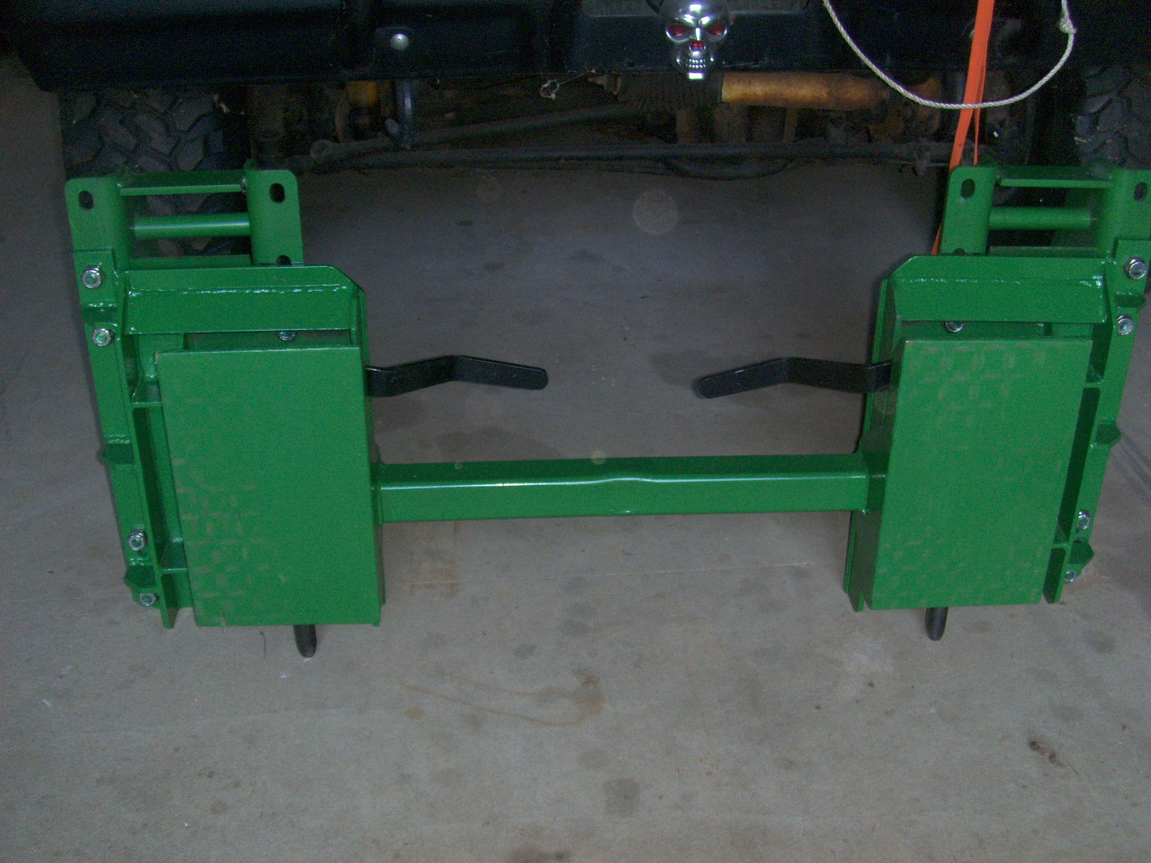

Many thanks Steve, pretty much solves the mystery. Thought I got a sweet deal on the TT75A but think after upgrading to SSQA won't be so sweet:-( Also think the longer we wait the more attachments will wind up 'slightly modified' to fit only that machine. Likely we will wind up with a skid steer in the near future so guess its time to take the plunge and order the proper bits, ouch. Not looking forward to explaining that one to the misses/accountant!

Is it a New Holland loader or an aftermarket? A loader make/model number would be helpful if you have that info.
It looks like the SSQA kit would set you back + $2.8K. The fact that Travis did not recognize your setup tells me that attachments that use that setup must be scarce and thus probably a lot more expensive than those using the SSQA design.
I say go for it -- your loader isn't going to be of any use if you can't attach a bucket, forks, etc. Regarding the Missus, I've found after 45 years of marriage that asking forgiveness rather than permission works. Well, at least sometimes.:)

I think this kit is designed to convert pin-on buckets. The manufacturer is a member here -- see http://www.tractorbynet.com/forums/attachments/270316-quick-attach-conversion-kit-need.html.
Steve
From the link you posted, they do have the conversion kit. I bought one and made an adapter out of it so I could use SSQA on my JD 640 loader.
By adapter, I mean I put it on the JD 600 series Quick Attach then can use SSQA attachments. Take it off and I can use JD 600 series attachments.
OP could buy one and bolt or weld it directly to his loader's current mount and then use SSQA attachments.
