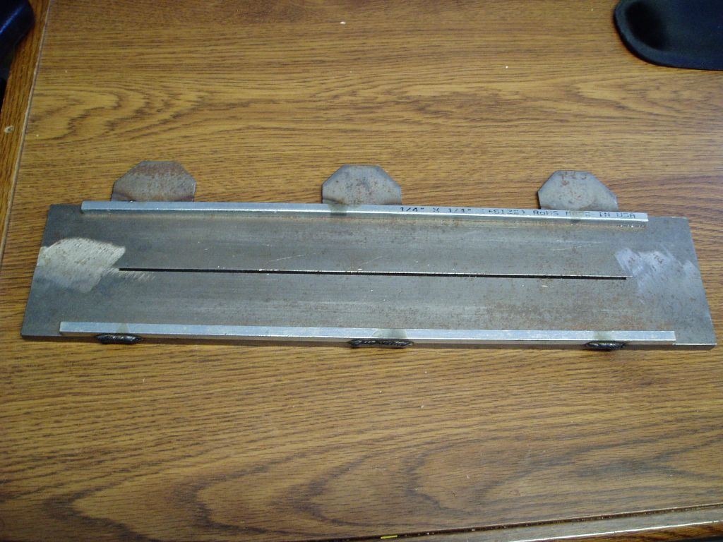

Another thing that will help a lot when cutting thin material is a saw guide to keep the material from vibrating with the saw blade. I made two of these to fit my saber saw. This is the 12" one, the other one is 48" long.
That or clamp/tape some wood strips to prevent vibration.
Fine blade, slow speed forward, tape on both sides.
