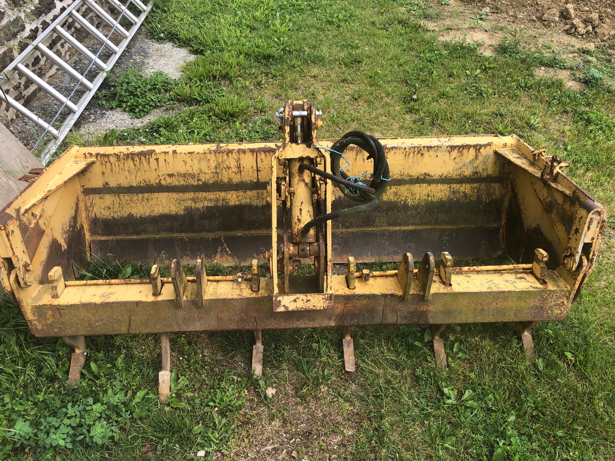

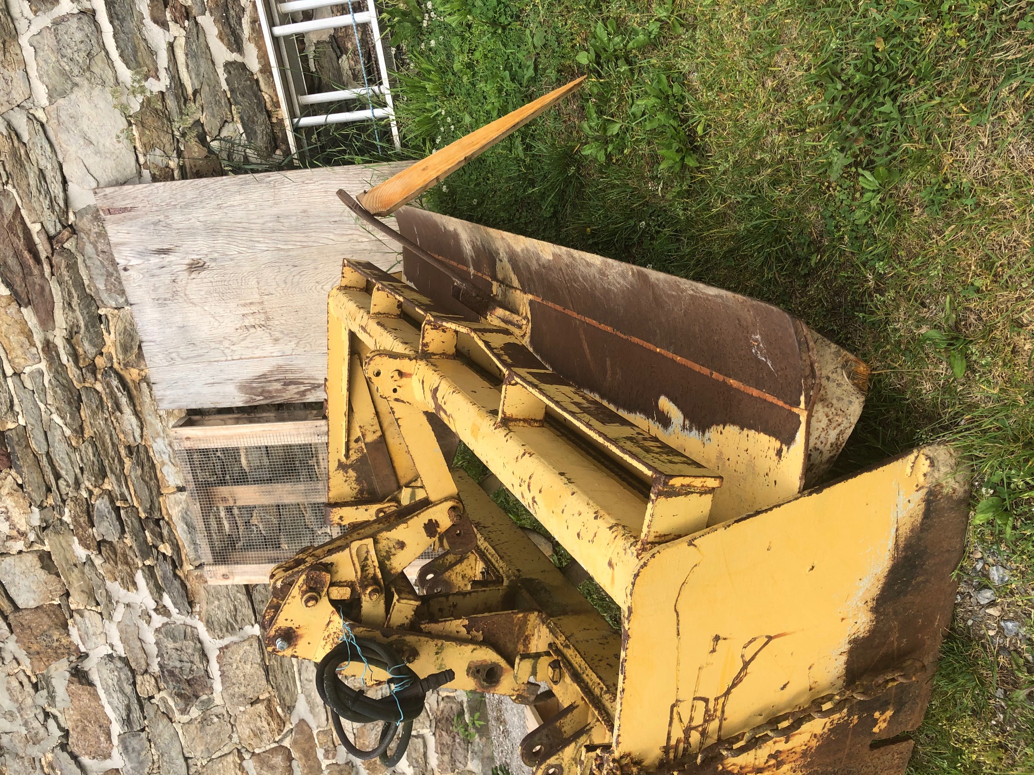

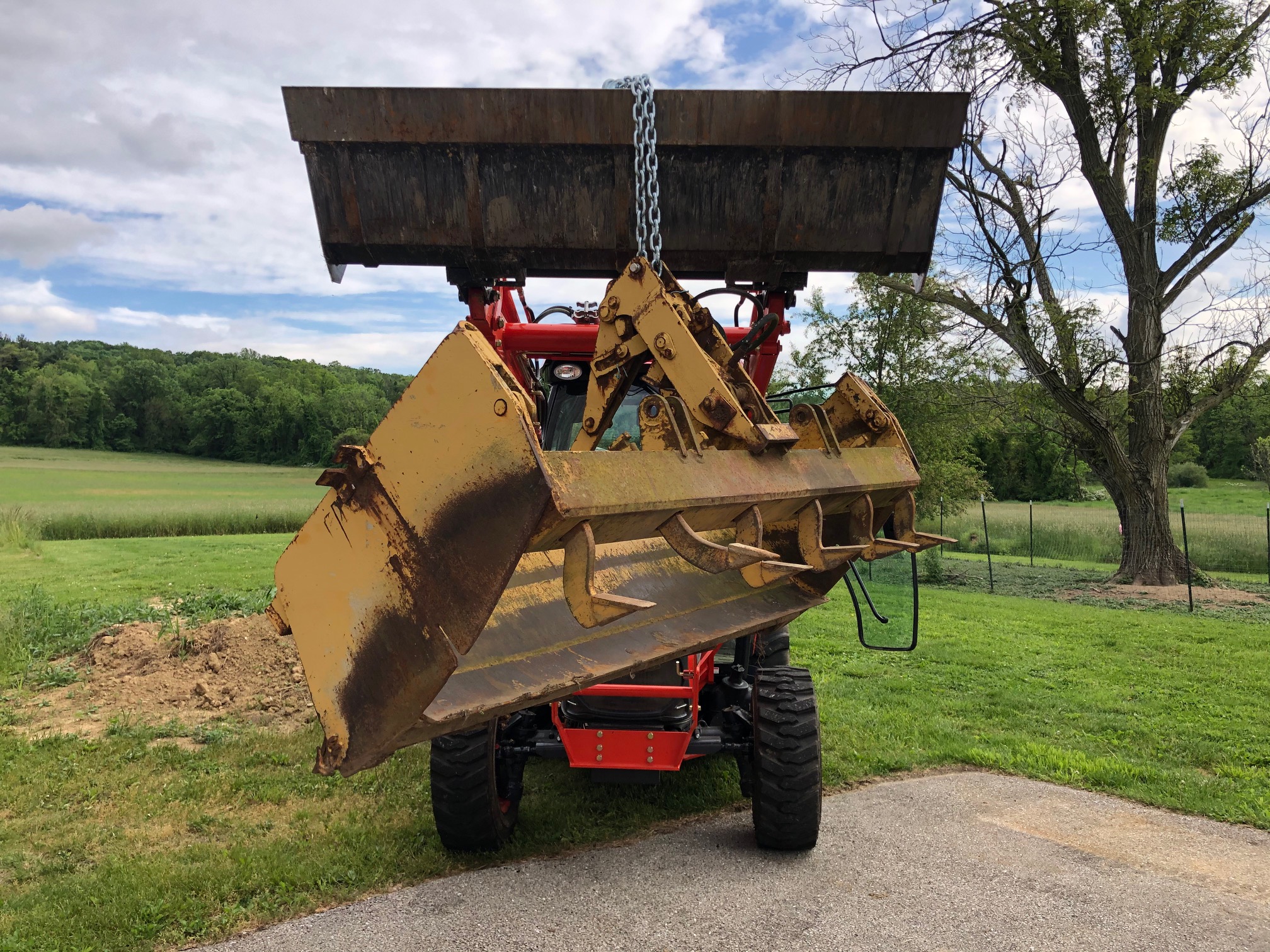

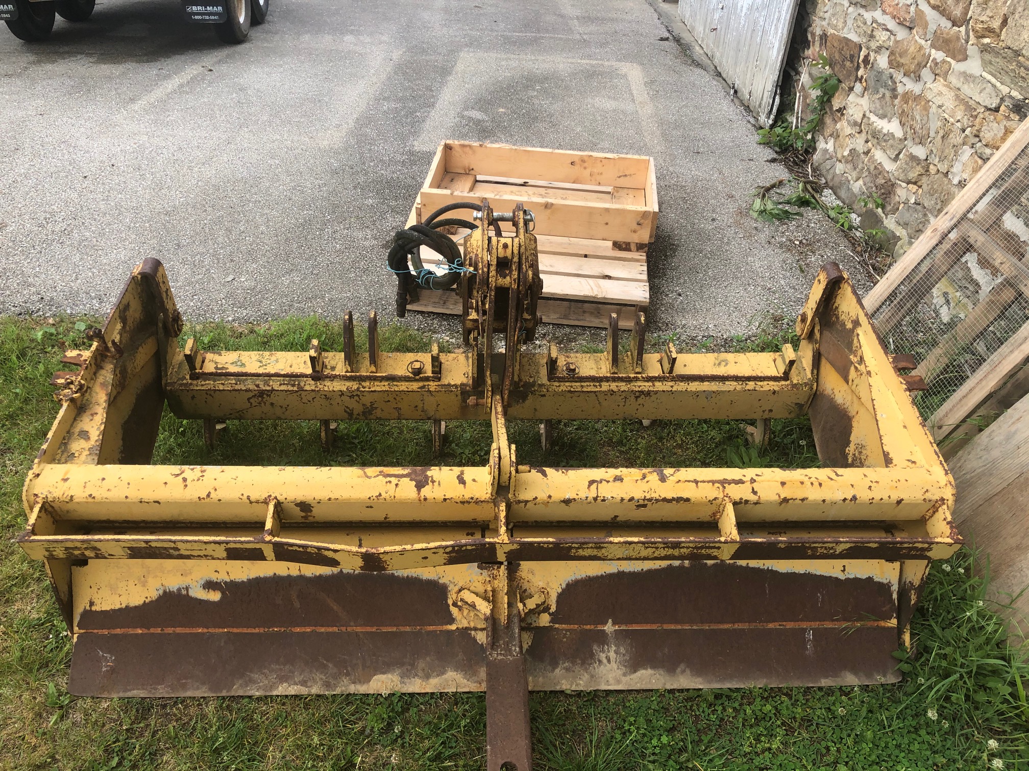

I bought this the other day and it seems different than any other Hydraulic box blade Ive seen on the Internet. Seller bought it for resale so didnt have much detail. Said it was an old Gannon brand. I bought it because it looks real heavy duty and I also needed something 1000lbs plus for rear ballast.
My questions are have you ever seen hydraulic rippers mounted like this? Ill have to change out the lines before I can test it out.

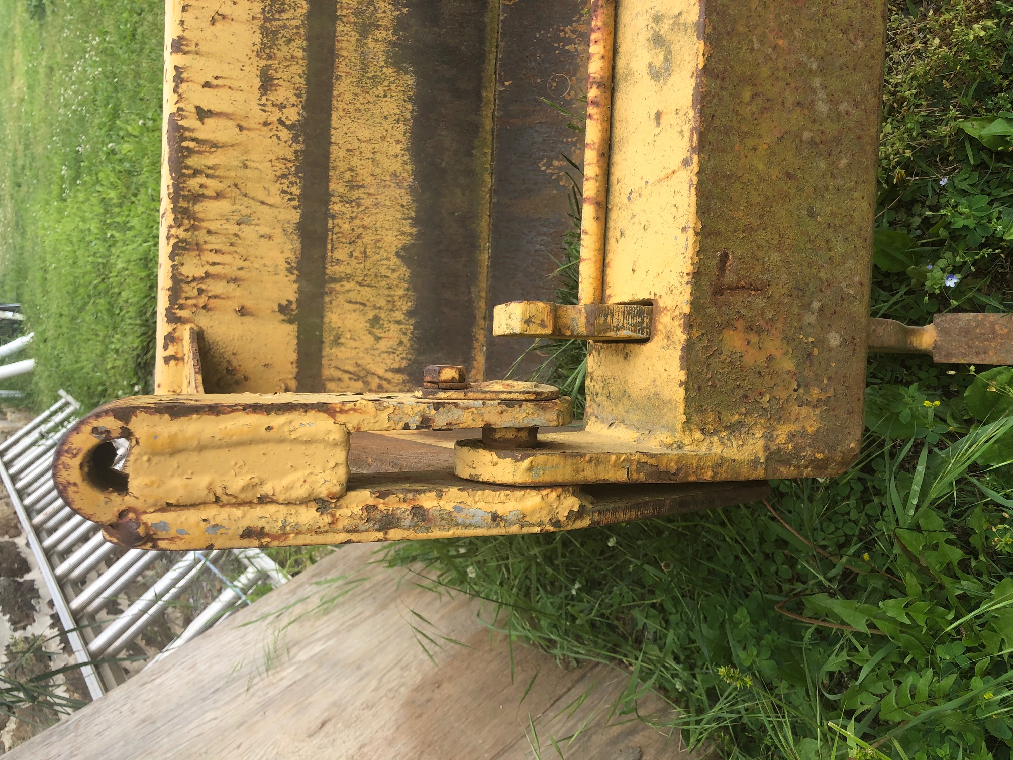

Also the rear blade floats but doesnt seem to lock down ? Would it be a good idea just to weld it shut ?
Let me know your thoughts on this thing.

Sure looks like a Gannon , my second guess would be a Rhino .......................

Also the rear blade floats but doesn't seem to lock down ? Would it be a good idea just to weld it shut ?
If you get it on a flat hard surface, you will probably notice the rear blade sits lower than the front blade. That allows you to use the rear blade as a cutting surface without interference from the front blade, allowing it to cut deeper. Leave it alone.

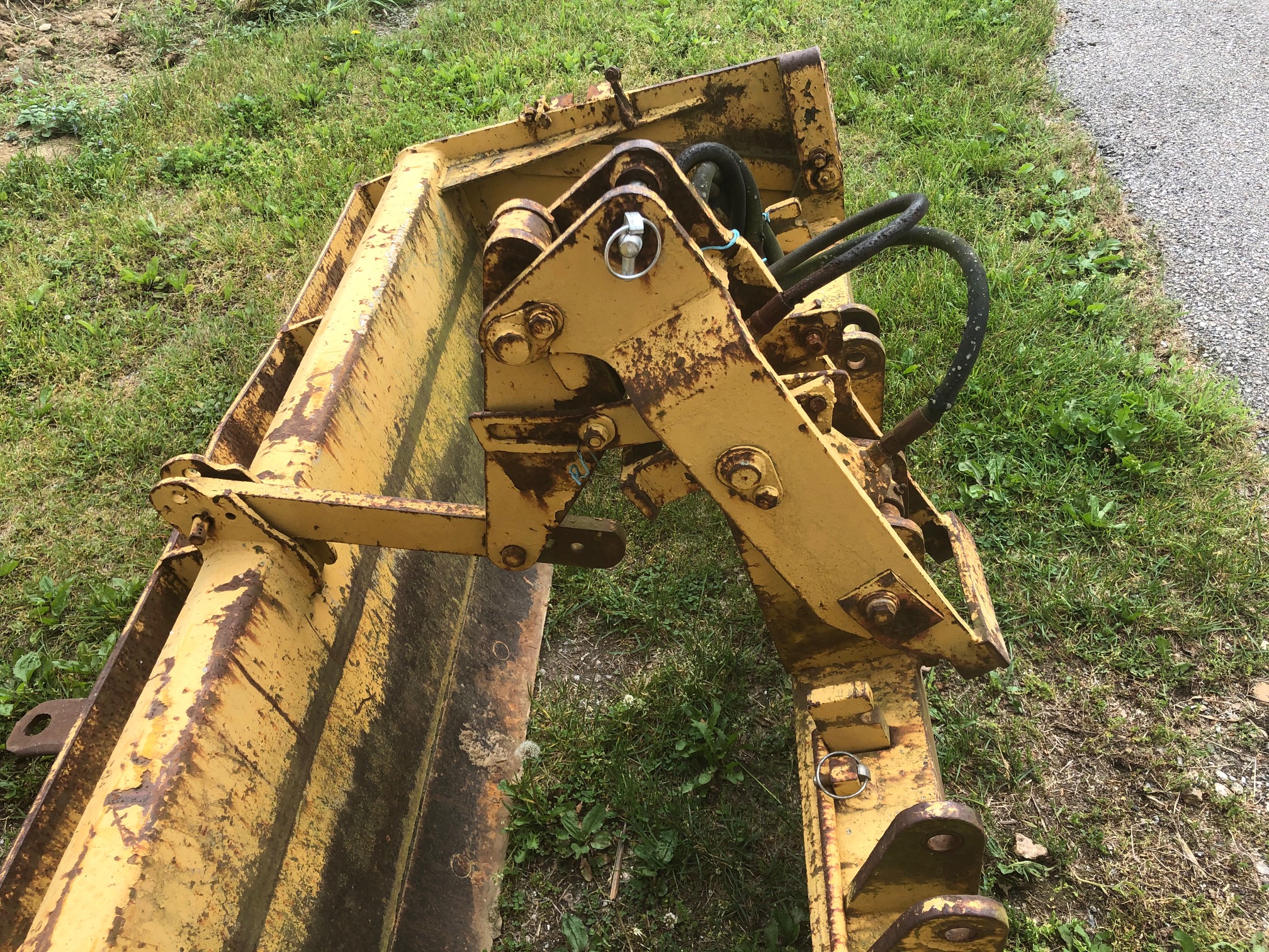

Do you guys see how the lower links connect to the hydraulic scarifiers mount and not a fix bar mount. Dont you think thats weird? I cant visualize how it will move with the links attached without actually hooking it up.
   / What kind of box blade is this thing?!? #8
Looks like you have stumbled into a really fine implement. I would not modify anything until it has been positively identified and you have an Op Manual for it. Yes - the scarifier setup is unusual. This could well be one of its better features. Floating rear blade in not unusual.
