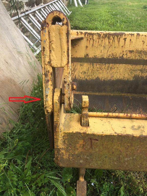

Xfaxman thanks for the pics with showing pivoting points. I was trying to make that point that it pivots oddly but your arrows help other people see that. The welds don稚 look clean enough to be factory so you are probably right it痴 some kind of custom job. I have not hooked it up yet hurt my neck pretty bad so I cant visualize how it痴 gonna work when moving the rippers with the 3 point hooked to it. All others like you said have that ridged bar for 3 point then separate bar for rippers.

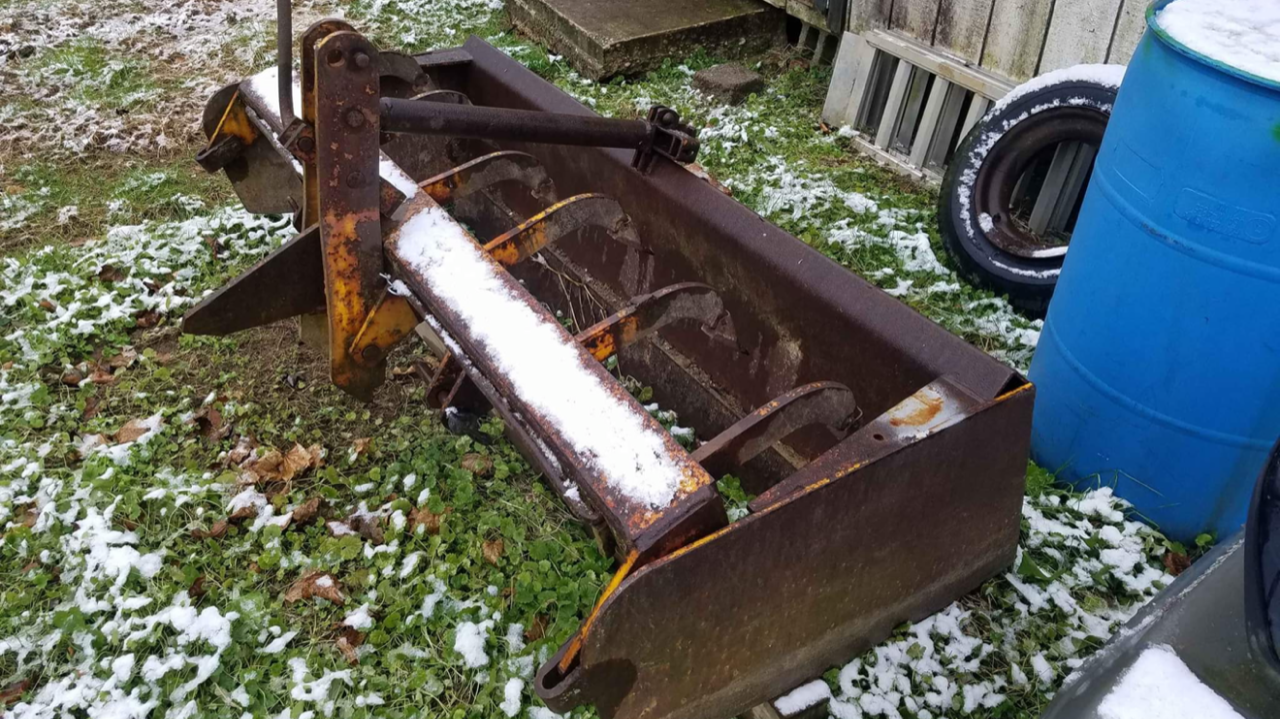

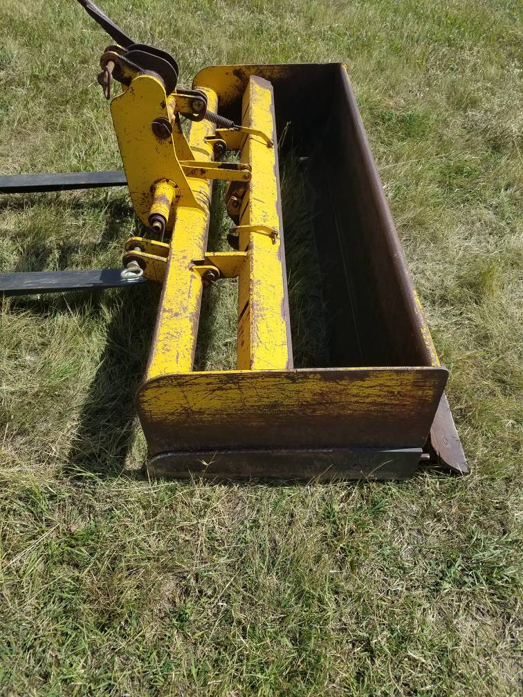

First picture attached I found that box blade locally for sale that looks very similar to mine in the way it rotates just with out the hydraulics. Asked the seller what brand and he didn't know. I am still stumped on who made mine. He was asking 450.00 for it I almost bought it for a back up!

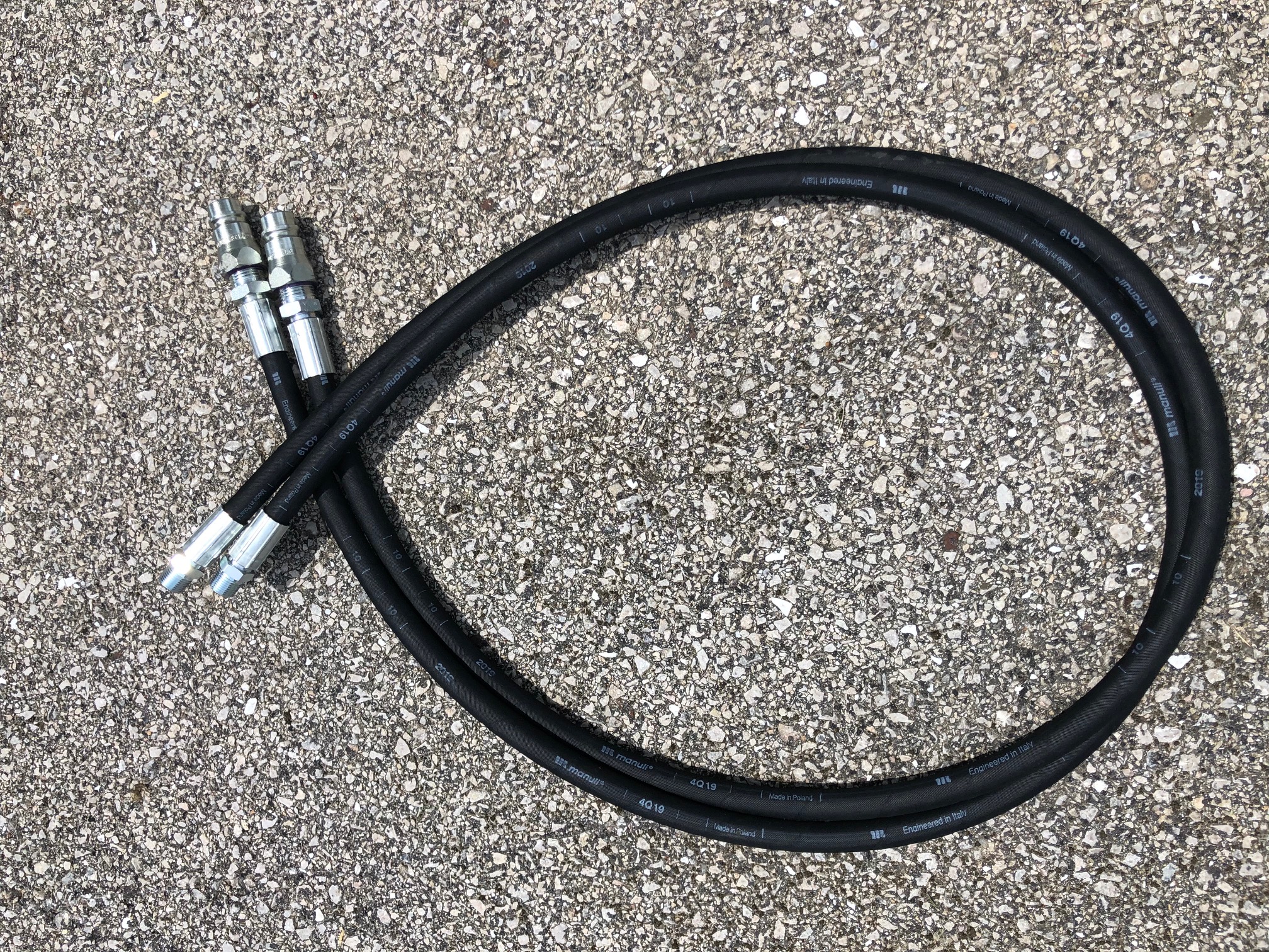

2nd pic are the new hydro lines I had a local shop make up for me. They were 90.00 for two 5 ft lines/fittings. I supplied the male pioneer ends that go into the remotes. Do you think that was a fair price?

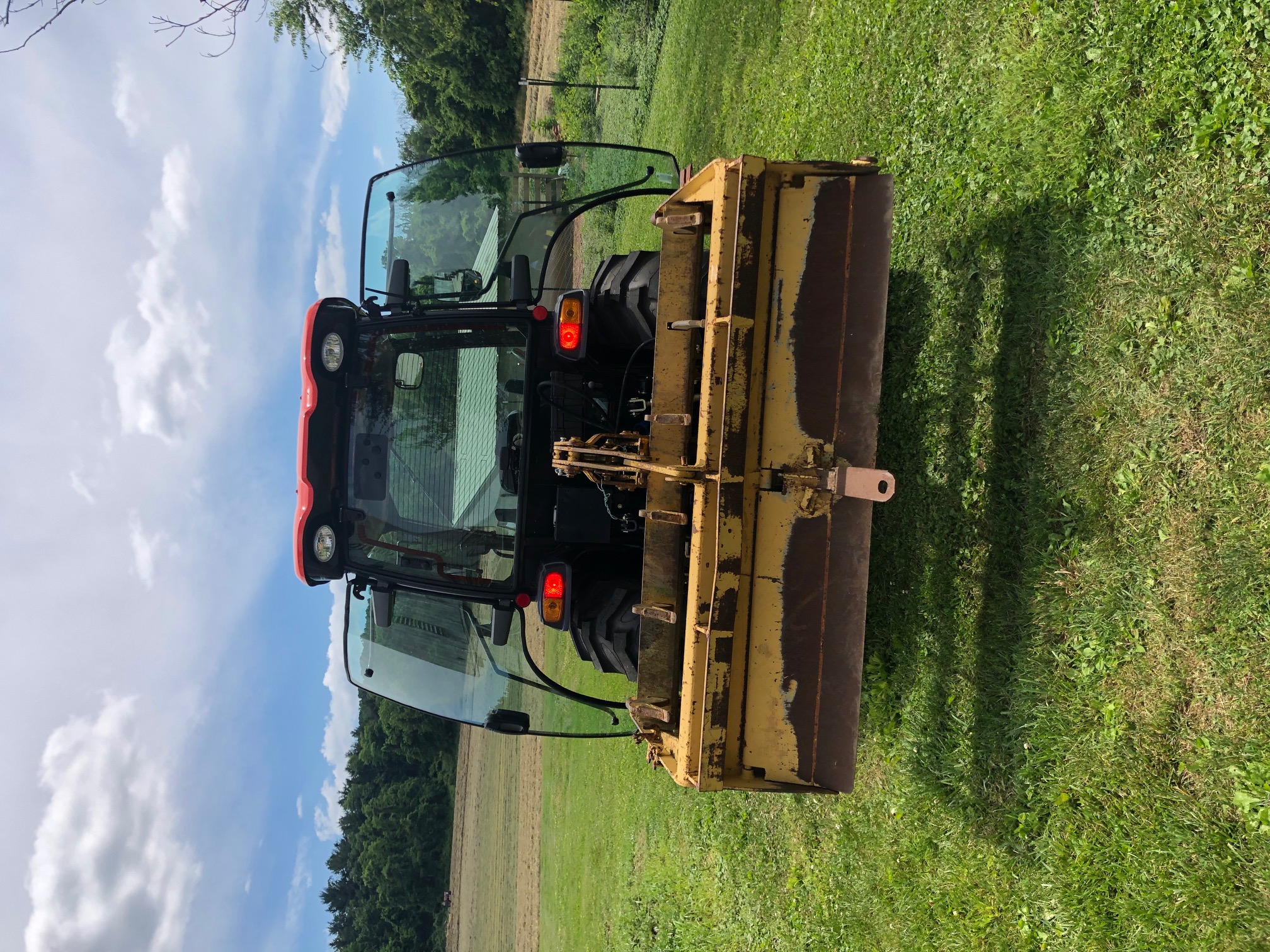

3rd pic shows her hooked up. I didn't rip with it yet waiting on a couple more pins that need replaced. I did move the hydraulic scarifers up and down and they work great. I would like to know if anyone knows where/how they lock into place so there wont be pressure placed on the hydraulics. I cant seem to find any locking mechanism.
4th pic shows it does have bolt holes to lock the rear blade. Can I just use a pin with lynch pin or do you think it would need a bolt?
Hoping to get this into the dirt soon, but definitely would like to know how to lock scarifies in place so I don't damage anything.
Yes, just had 2 hoses about same length made at NAPA for around $90. old hoses 3000psi rated, replacements 5800psi rating.
