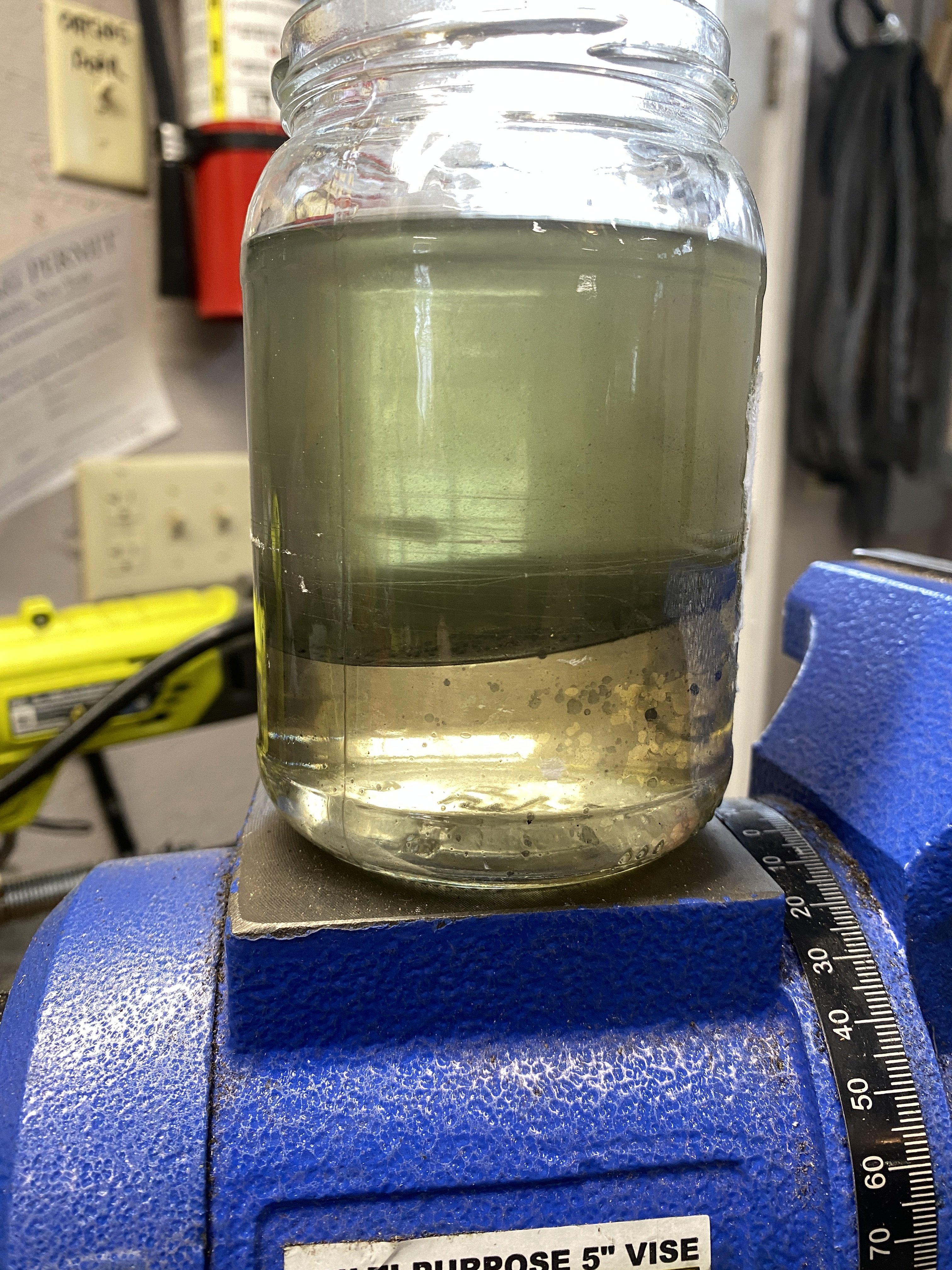

I have big pond built in 1995 (2 acres) with a long story, condensed version, my major spring actually reversed when pond got full after 2 years. So I pumped the water out and brought in an excavator to dig out the spring and pack it with bentonite to seal it. I was not willing to wait another 2 years to find out if the fixed worked, and I had the pump so I ran roughly 700 feet of 2” black plastic water line from a seasonal creek on my property and pumped it full. Victory!..Sort of. The natural head on the remaining springs is about 3’ below the overflow. Each year I “top it off” in the spring. I rigged a 6.5 gallon Northern Tool generator tank so the pump wiii run roughly 50+ hours on fill up. I change the oil every 100 hours using 10-30 syn-blend, with no particular brand loyalty. By my rough calculations I am approaching 6000 hours on a Honda GX 120. It still starts on one pull, but it does feel like it is starting to lose compression and uses a little oil. I dropped a note to Honda as a testimonial, and heard…crickets. My biggest source of problems over the years has been contaminated fuel. for the last 6 years I have been purchasing non ethanol rec-fuel in a Tractor Supply 50gallon tank that I rigged for easy loading into my pickup. I have a water removing filter on the tank. That had solved the problem until this 76 year old goofball somehow left the fill cap off the “day” tank, and it rained. I drained the bottom of the tank and but I would still occasionally have the motor quit on me. I had added some Stabil Marine I had on the shelf to help purge the water. I had tilted the tank so the gravity feed was not the low point and that seemed to solve it. When I broke down my set up this fall, I set up the tank back in my shop so that the feed was the low point and drained fuel into a glass jar. The photo shows what I got. Maybe the Stabil was out of date, but it was definitely not impressive.

I've never had any issues with fuel I've treated with it, but it's rare any I have around goes unused for more than a year or so. 6 years seems like a long time...
Expecting it to deal with water that leaked into a storage tank is asking a bit much IMHO.

Right you are, my post was probably too deep in the weeds on background, but it was the obvious water/Stabil/gas separation in the jar I thought was interesting, so I shared it. I had assumed the Stabil dispersed in the fuel.

Try some Star-Tron fuel treatment. It's been used in the RV/Marine areas for many years.
You might also want to use the Goldern Rod cartridge filter on your tank. It has a water drain on the housing. Have that on a 50 gal diesel tank.

Good points, My filter on the storage tank does not have a drain but it is for particle and water removal. The drain sounds better. I appreciate the feedback. I obviously overshared and muddied my point, which was that I was surprised to see that the Stabil had not dispersed in the fuel. The water was self inflicted and now that the “day” tank is drained, cleaned and dried I don’t anticipate any problems.

Stabil don't do anything for water. All it does is postpone phase separation and only the blue Marine Stabil. You need to rethink your procedures and be more cognizant with putting the cap back on your fuel tank.
My bad, when I reread my post I realized I did not make it clear the tank I had water in was the small 6.5 gallon “day” tank not my storage tank. I agree that Stabil will not correct my mistake, but what I found curious is the blue Marine Stabil did not disperse in the fuel. So I shared it.
