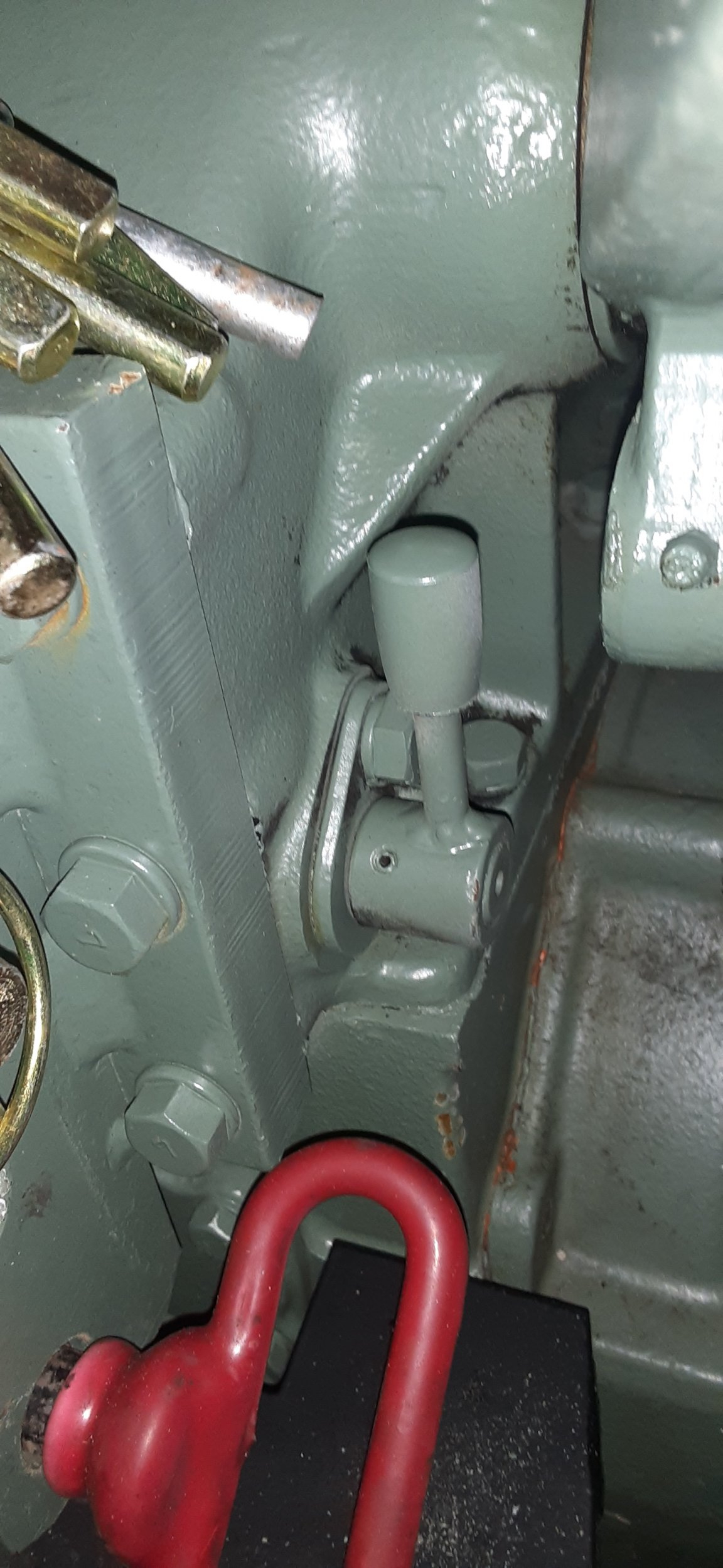

In front of the seat I have the 3 Point Lock valve.
Under the seat I have the 3 point speed valve.
Behind the seat on the side of the top link mount there is another handle/valve that moves about a 1/4 turn. What is this? Nothing in my documentation explains. I did not have this in my 155D.
Thanks guys for you input.

Ah a fellow YM2610 owner. That sir locks the 3PT. And it pinches fingers too if you are not careful. ;)
Thank you Sir. I figured you would be the first one to answer this question. So I assume this is a mechanical lock as opposed to the valve lock to the front?

It does seem to be this way. Just be glad our machines are not like the F-FX Series with the 3PT UFO confusing controls.

You got me to look at it again today. Yep, it's there. Just a lock-stopper at the back end to keep the 3PT in one position.
Wonder if a machine with a loader can still work up front and the 3PT can be locked. Makes sense as the knob under the seat would turn off both.

I tried closing the valve under the seat once, the tractor screamed at me to turn it back on. I don't think it plays well with the FEL spliced in the system.
