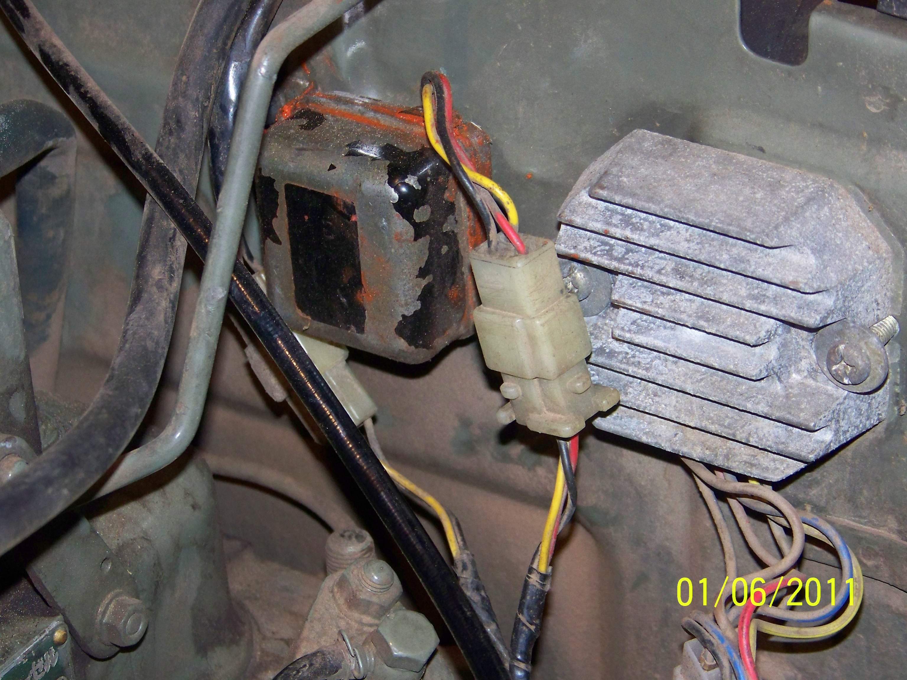

hello friends, I disassembled the dashboard of my yanmar 1610dt and I find this element that is not what it is or what it does.
Can you help identify it?

Looks like it might be the flasher unit for hazard lights.

If I remember right, the 1610 has a " current Limiter" and a relay to turn the dash light on. Most others have it combined.

Here is my glow plug module. May be what that is on your 1610.

winston1 yes that's, where I can find parts of this piece?
   / What is this element in my yanmar ym1610dt? #9
Doubt you can. You can see from the red sealant I had mine apart. Can't remember exactly what I soldered in it but something had came loose. I re soldered it. put it back together and my thermostart light started working. The thermostart actually works whether the light comes on or not. I believe that it someway times how long the thermostart stays on. My light will come on and automatically go off after a period of time. Don't really know if ambient temperature has an effect on the time or not.
