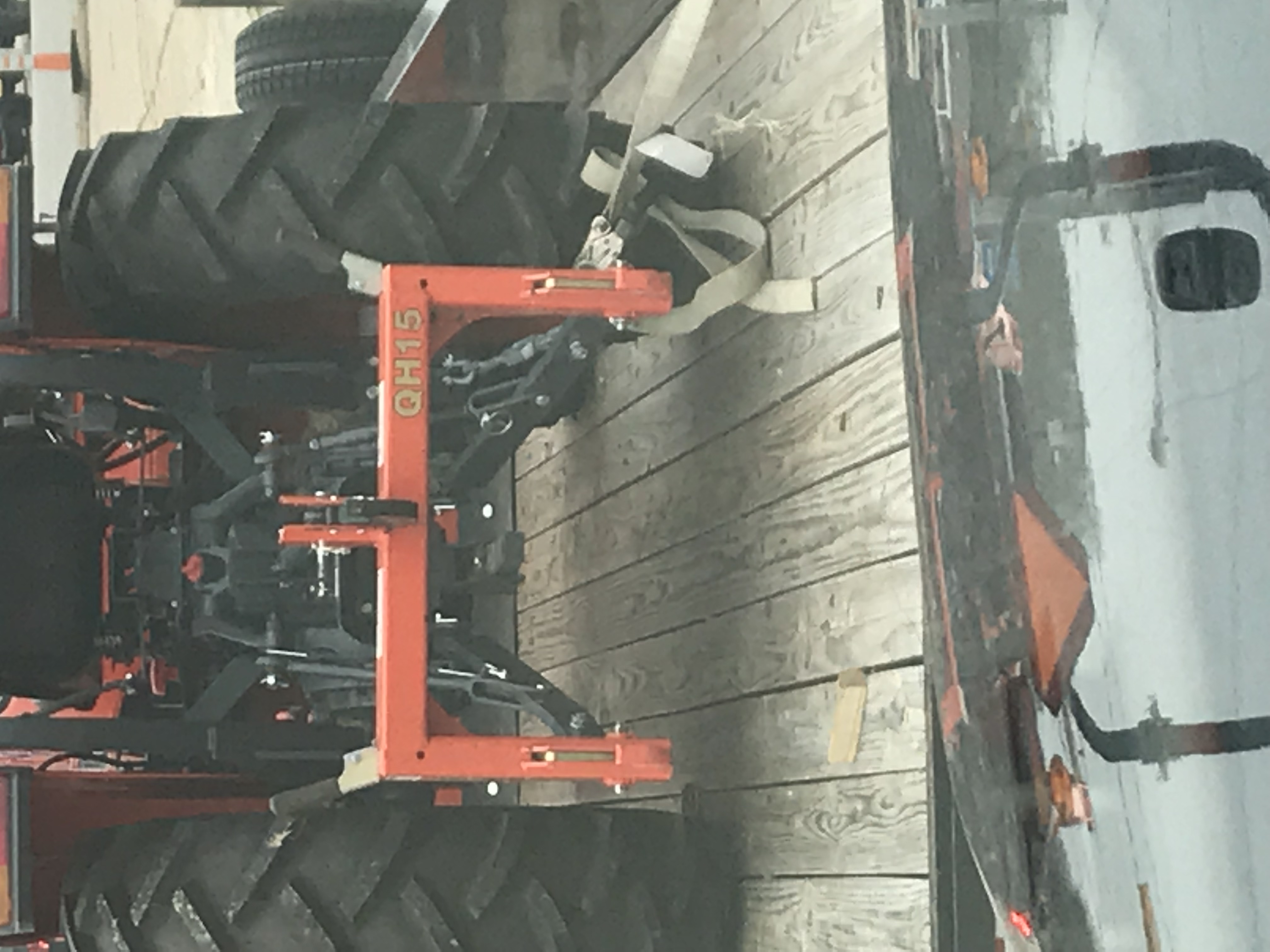

Saw this today. Don’t think I’ve ever seen one before. Looks like quick attach levers but what for? The bottom of the pic is hood of my truck.

Looks like a standard 3 pt quick hitch to me.
What am I missing here?
/ What is this 3pt attachment? #5
Land pride quick hitch

To the OP's question.....in a perfect world, this attachment allows the tractor to quickly hook onto a implement just by lifting onto the 3 pins. No more getting off the tractor, lining up the arms, installing pins, and installing clips. In a perfect world..........

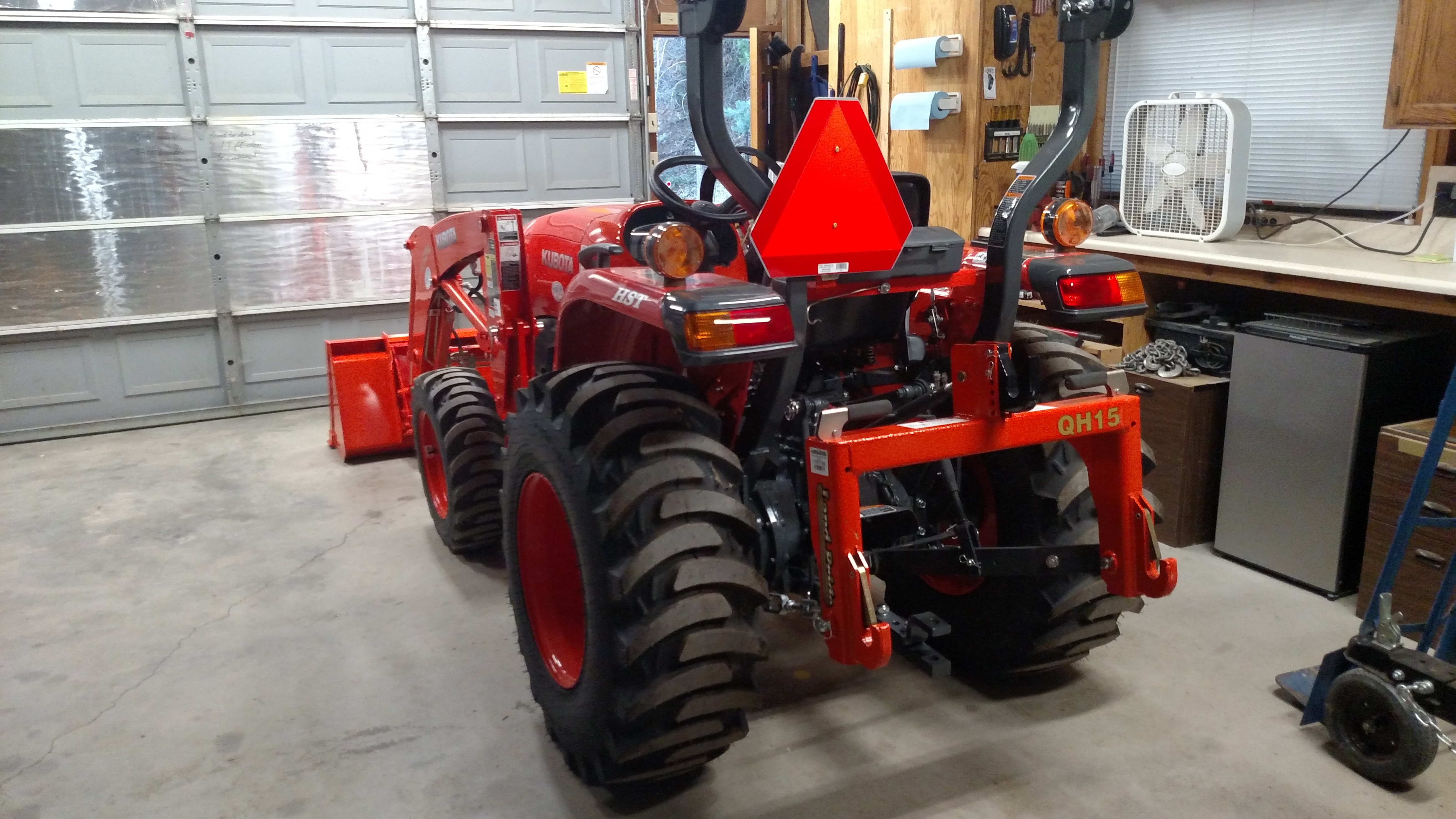

I purchased my 3032E with the JD I-Match at the dealers recommendation. I cant imagine not having it. I can be hooked up and gone in a couple of minutes.

Loader quick attach is different concept from 3 point quick hitch. I don't know how many of us have 3 point quick hitches, but it's a lot.

Just keep in mind if you add the quick attach 3 PT you also have to have the implement set up also with the correct attachment pins. So it's not just buy the quick hitch, a little more to it than that.
