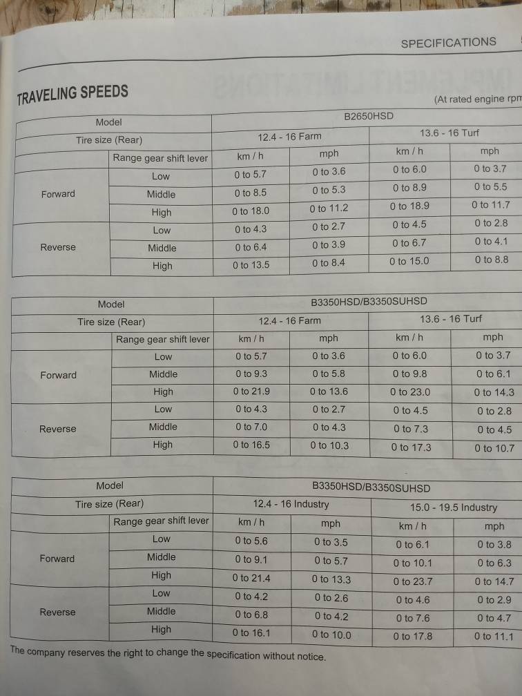

   / What is the value of 3 range HST vs. 2 range? #45
Kioti publishes speed in each range, so it’s easy to figure relative gear ratios for different models in a roundabout way.
Kubota keeps that information secret, and I haven’t checked the others.
Transmission gear ratio isn’t everything, though. Tire size, rated engine speed, and final drive ratio all come into play.
The tractor with the slowest road speed in low range and the fastest road speed in transport mode has the widest overall ratio spread.
   / What is the value of 3 range HST vs. 2 range? #46
My BX2370, Forward low 3.7mph, hi 7.8mph -- Reverse low 2.8mph, hi 5.9mph
B2650, Forward low 3.6mph, med 5.3mph, hi 11.2mph -- Reverse low 2.7mph, med 3.9mph, hi 8.4mph (12.4-16 farm)
B2650, Forward low 3.7mph, med 5.5mph, hi 11.7mph -- Reverse low 2.8mph, med 4.1mph, hi 8.8mph (13.7-16 turf)
Had the B2650 opened up on the road Monday, felt faster than 11 mph. Guess most of my tractor work between 4-5 mph. I mow with the BX at max speed.
