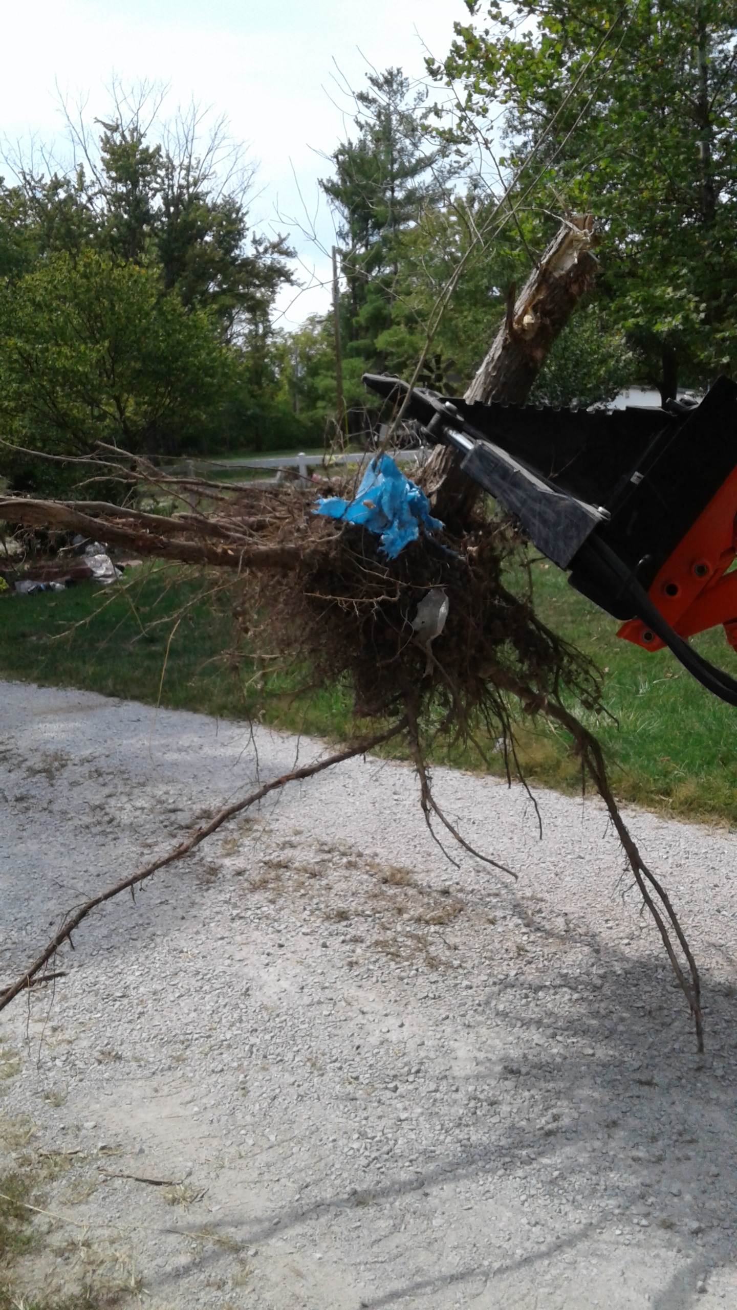

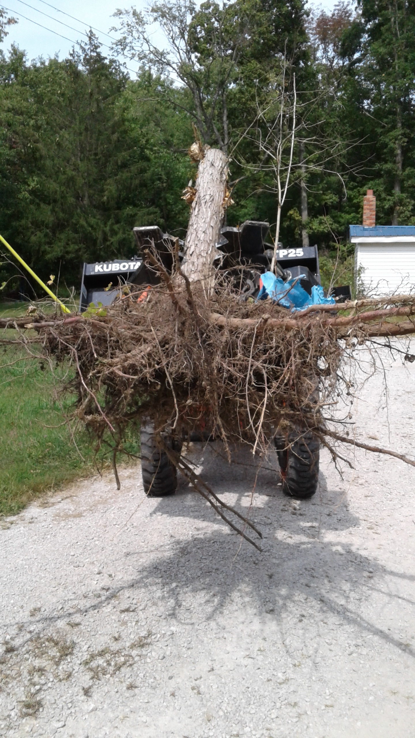

Have B2650 with loaded tires use Medium most of the time, but Low comes in handy when pulling stumps
