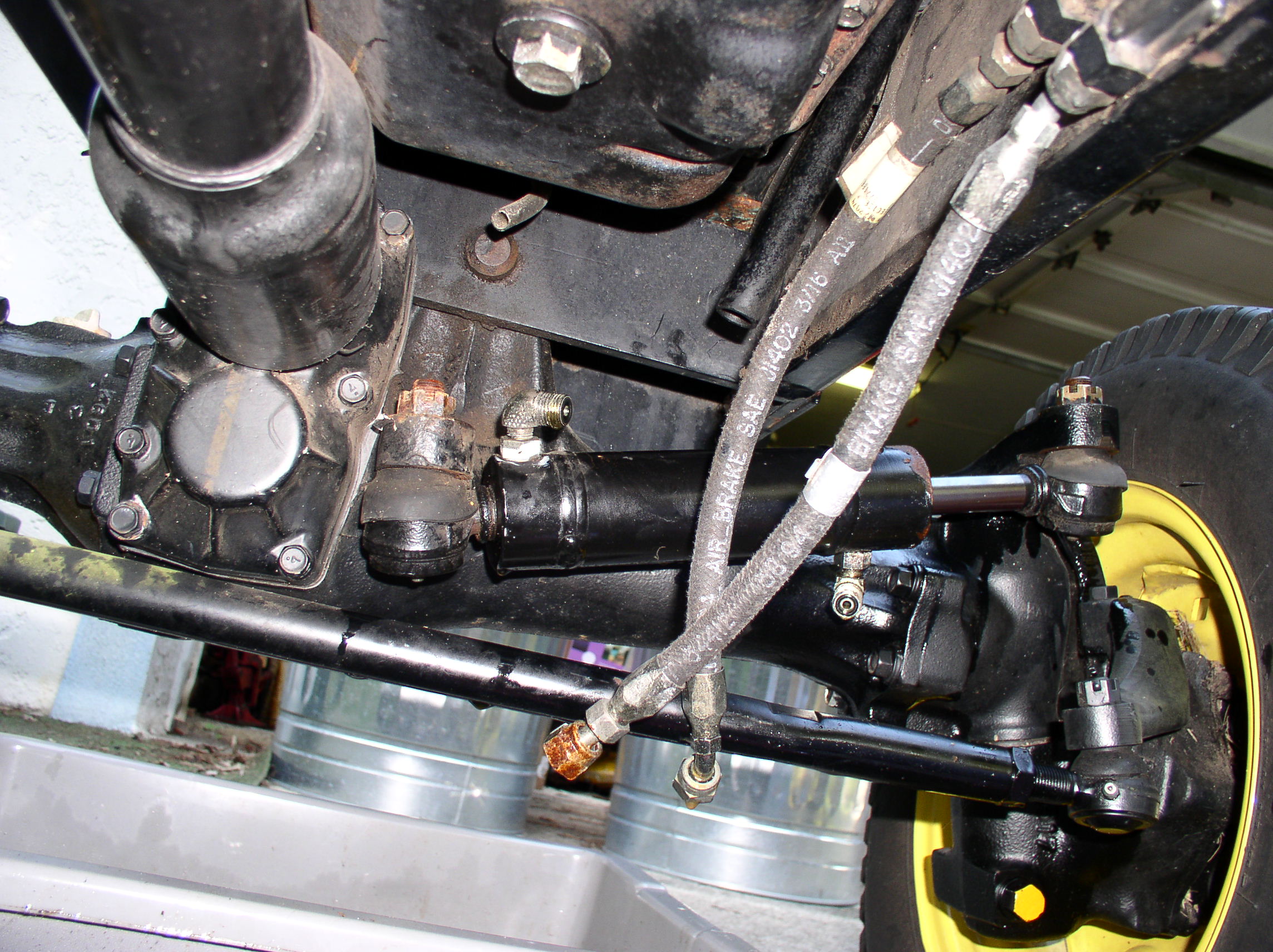

Hey everyone!
Even though my JD855 is a '95 model and i bought it new, i'm doing my first "major" repair. Nothing has gone wrong until now if you don't count my wife running a rear tie off the wheel, and some other minor stuff [broken sway chain, etc]. I recently blew the steering hydraulic cylinder--leaking at the ram seal. Found out they are not rebuildable, so after looking around quite awhile, i ordered a new JD part. The local JD dealer quit and now i have to go 40 miles one way to get 'em. This really happened because i have pix:
Anyway, i got started, looked easy enough. Got the system drained, unbolted the lines and the "tie rod" ends--then nothing. The d@#% thing is frozen solid in the bolt holes.
What is the trick to getting that cylinder off? Do i need a pickle fork [tie rod fork]? A few shots with a 3 pound hammer didn't work--so i backed off to ask the experts.
Once that's out, it'll be a piece of cake to put in the new one. Won't it?

Soaking a while with your favourite penetrating oil is never a bad thing.
I use an 8lb club hammer for this type of thing - hit the side of the mount (the part the bolt goes through), a few good whacks and the "tie rod" ends should drop.
IE. - don't beat on the threaded rod ends - that seems logical, but doesn't usually get you anywhere.
Rgds, D.

I've had the best results using a tie rod puller. If that doesn't break it loose, put pressure on it with the puller, then tap it with the hammer.
When you use a hammer, try to hit the tie rod socket in a direction that does not try to break it off the housing. If you can't, then use another hammer or something else heavy behind it as an "anvil."
Bruce

Generally the best way is to hit the "socket" end of the mounting arm/bracket - hitting the end will expand the hole just a bit and most often the tapered bolt will then just drop out. But I can't see what the axle end of the cylinder mount is fastened to, not always a good idea to pound too hard on anything cast, or fastened to cast material. But I'd give a few good whacks, then if that doesn't work use a ball joint fork or a puller. Since you're replacing the entire assembly you don't have to worry about munging up the boots or the ends themselves.

Thanks all.
I've tried beating on the ends every which way. I guess that i'll try the pickle fork as soon as i can get one. I'll let y'all know.

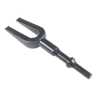

Yes use a pickle fork.
   / What is the trick? Newbie repair question #8
OK i know this may be a dumb question but why do i still see the nuts on?:confused3: While your waiting for your pickle fork or a puller keep squirting it with a good penetrating oil. Also applying some heat then spraying with the oil also works well. Use caution !!! :fiery: Just a hint when using a pickle fork when you do back the nut off don't remove it completely, leave it on a few threads. It keeps parts from dropping and flopping around.

Use one of these and an impact.
   / What is the trick? Newbie repair question #11
Is that for an impact gun??? Looks like the shank for an air hammer/chisel
Sent from my LGL35G using TractorByNet
Yes, that and a Snap On PH3050 make quick work of any stuck rod ends. I have one that setup and love it!

I put the nuts back on after i whacked on the ends awhile to no avail. I also reconnected the hoses to keep gremlins out. I never know how long it will be to get back under ther with thunderstorms and 90+ temps.

Just a stupid question, but if he could get in there to pry or hammer, would it be a BAD idea to thread the nuts on a few threads to protect the threads, and then pry or hammer down on the end? with or without heat, PB Blaster, Liquid Wrench etc.?

That's how I get most ends, put the nut on to protect the threads, then hammer it. If that fails, time for the pickle fork.
Here's the air hammer attachment kit I have....
Lisle 41500 Fork Kit : Amazon.com : Automotive

Don't know WHERE in the "sunshine state" you're in, so I just picked Daytona Beach for a search -
OEM/Pickle fork set (25261) | Air Tools and Accessories | AutoZone.com
This one's a bit fancier than most - as long as you have compressed air, any cheap HF $10 air hammer will do the job. I use one of the HF ones fairly often to drive 1-3/4" pins into/out of a full size Case backhoe with no problems.
In my experience, the air versions are more likely to work and less likely to damage other stuff than the "BFH" approach, unless you can support things to eliminate side stresses to surrounding parts.
The hundreds of hits of an air hammer sets up a vibration in parts which seems to help break apart rusted fittings in a lot of cases.
IMO, if you walk into an auto parts store and get a blank stare when asking for a "pickle fork", you should walk out and try a different store - preferably one where they DON'T ask if you'd "like fries with that" :laughing:
Good luck... Steve
