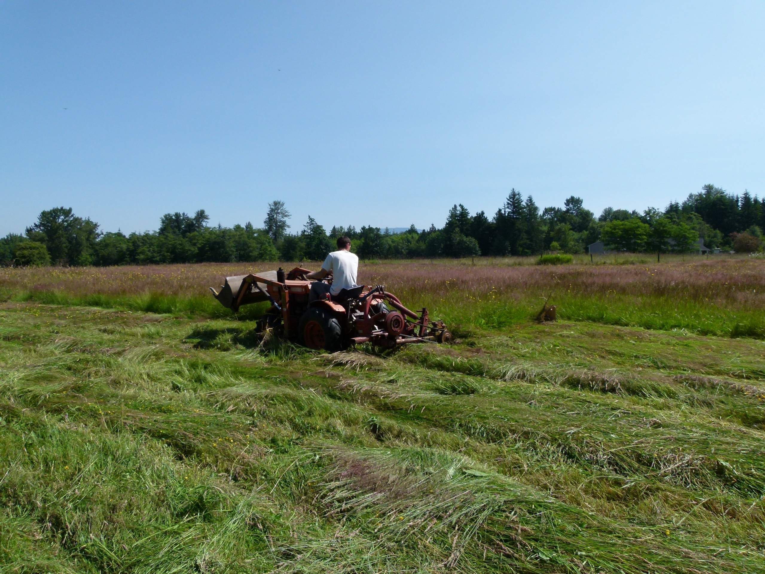

I don't know about a swather, but I can run a 7ft New Holland 451 sickle and a JD14T and JD24T baler with my old 4x4 Kubota B7100 with not much problem. The tractor only weights 1000lbs, plus about 500lb for the loader, and has 18hp (I replaced the engine with a D950). Tires aren't filled. Baling uphill makes it puff a bit of smoke, but on flat ground I can run the baler at rated speed. As others have mentioned, be careful (or avoid) going down any hills with a light tractor and a baler behind.
I bought a bigger tractor this year, an old IH B-275, 38hp diesel, 2wd, live PTO, probably weights around 3500 lbs. Although the B7100 did the job, it's nice having more than "just barely enough" power and weight since I moved up from doing 8 acres to 20+ acres this year. If I was just doing our 4ac, I would have stuck with the Kubota.
