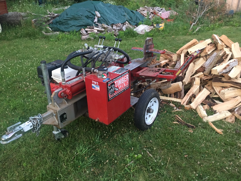

I have been planning a new splitter build the last couple of years.Mine is 27 yrs old,works great in the single vertical split mode but when I put the 4 way on it leaves quite a bit to be desired when I hit knotty wood.I was going to switch out to a 5" cylinder for the time being to give it some more oomph.But since it is close to the ground you need to work in the stoop over mode which gets old after awhile.My new one will be a combo Timberwolf and some of my own features.But I also have been worried about optimum wedge type.All the demos have straight grain oak.So I will be watching threads and posts on wedge design also.

That's kinda my plan. A combo of the timberwolf with my own features. I currently plan on using an adjustable height 4 way wedge.

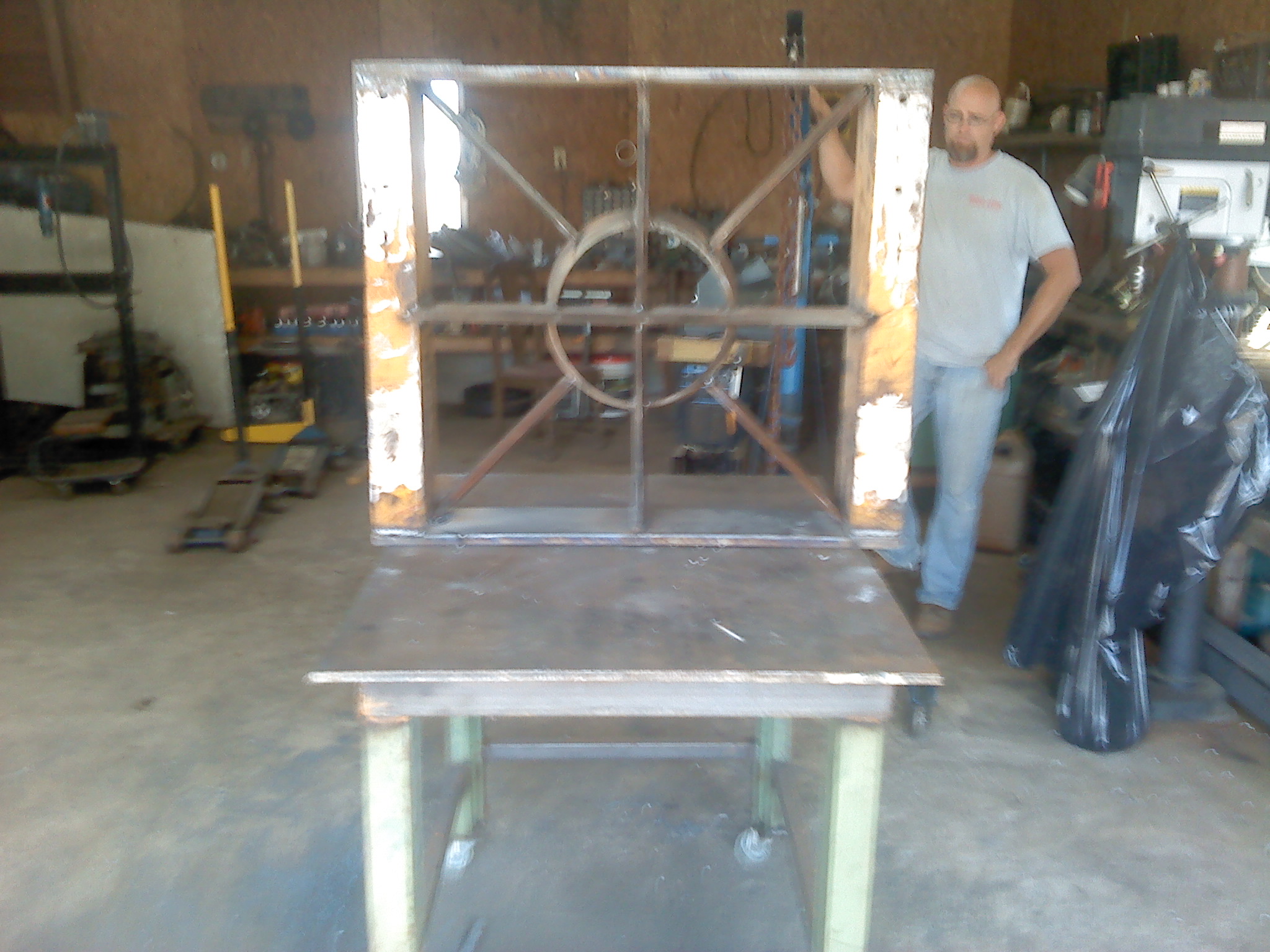

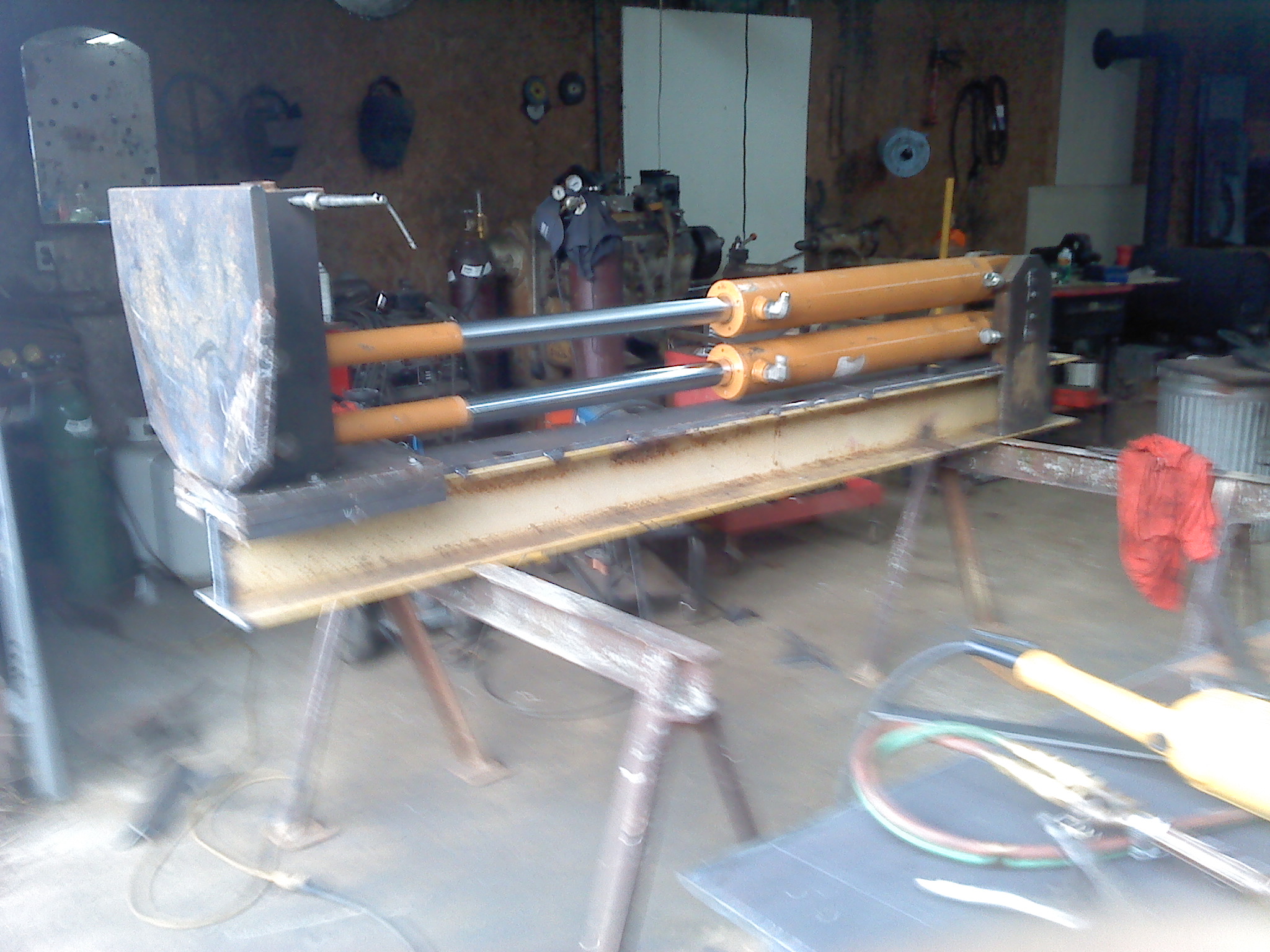

w
hile my splitter build is currently on hold, here is a pic of the wedge I will be using. 1017161503.jpg and the rams to push the wood thru it.1210151640.jpg
