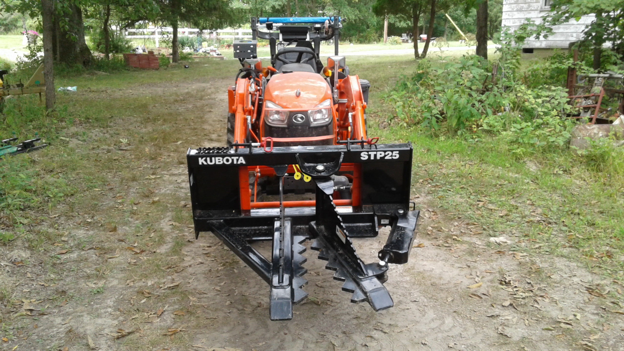

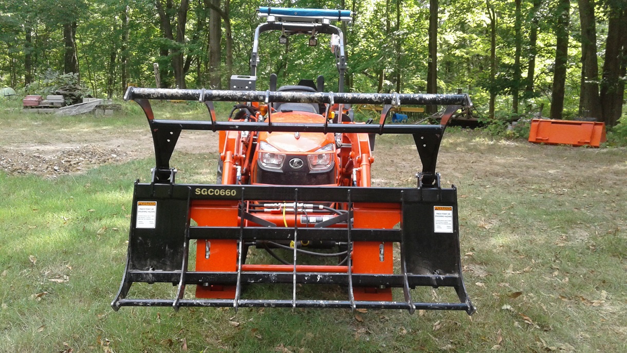

If you don't have a grapple, it will become a most used tool.
It can clean up the mess created by a tree puller
Flat land, recommend the grapple. Slopes the puller may be the better tool.

The root grapple was my original thought as I can use it for several different projects in mind (mostly in the woods). Just need some arm twisting to swallow the cost.

Since the last two I can try without buying anything else, I'll give them both a try. I do have a wicked tooth bar on order so its hard to justify a ratchet rake. If the bucket alone or with the chain don't work I'll wait for the tooth bar. After that its probably grapple time.
