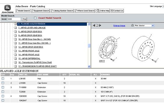

Deere doesn't officially condone the use of wheel spacers
Sure they do...they make wheel spacers themselves, and show their use in tread width setting charts! Up to 4" per side is offered by Deere for my tractor.
-Phillip
