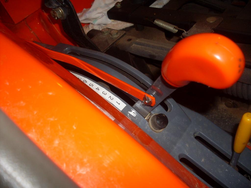

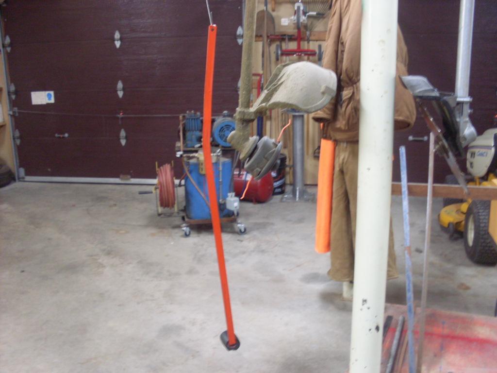

I was always jealous of these and I decided to try and add it too my tractor, so here is a picture while the paint is drying and I'll post one in a day or so of it attached. They are usually on the larger tractors but not the compacts for the most part.
Have fun with it
Steve

/ What is it? #2
Bucket level indicator.
or
Auto bucket leveler.
/ What is it? #3
Dang I'm stump,how about couple of vowels. ;)
/ What is it?
Your close, especially the one about Tiger. Here's a couple of vowels, well letters, well numbers, 3ph.
Pics later today
Steve
/ What is it? #7
Some sort of handle to reach back and trip and implement? I need to phone a friend :)
Dave.

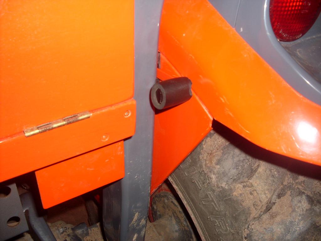

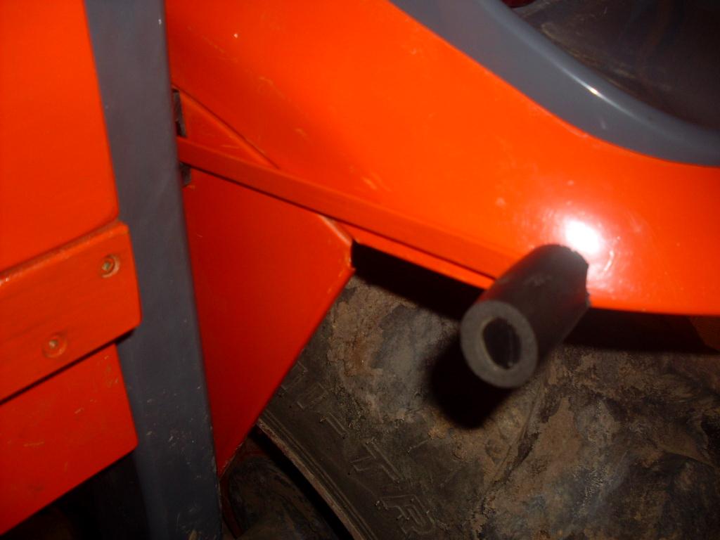

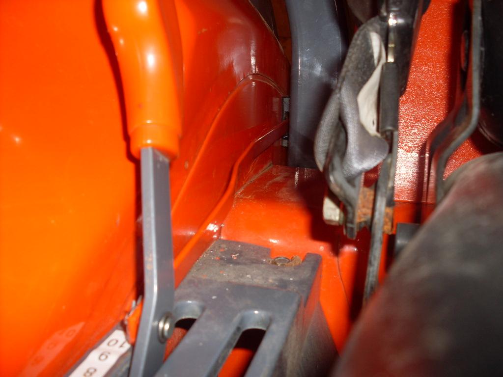

/ What is it?
Here it is, crude but simple. Got tired of reaching around to attach implements and this was the cheapest alternative for my reasoning. In is down and out is up.
Steve

/ What is it? #12
Excellent post. Much more original then "bucket hooks".
/ What is it? #17
I had no clue what it was at first. Now that the "secret is reveled" great idea, I want one!
Larry
