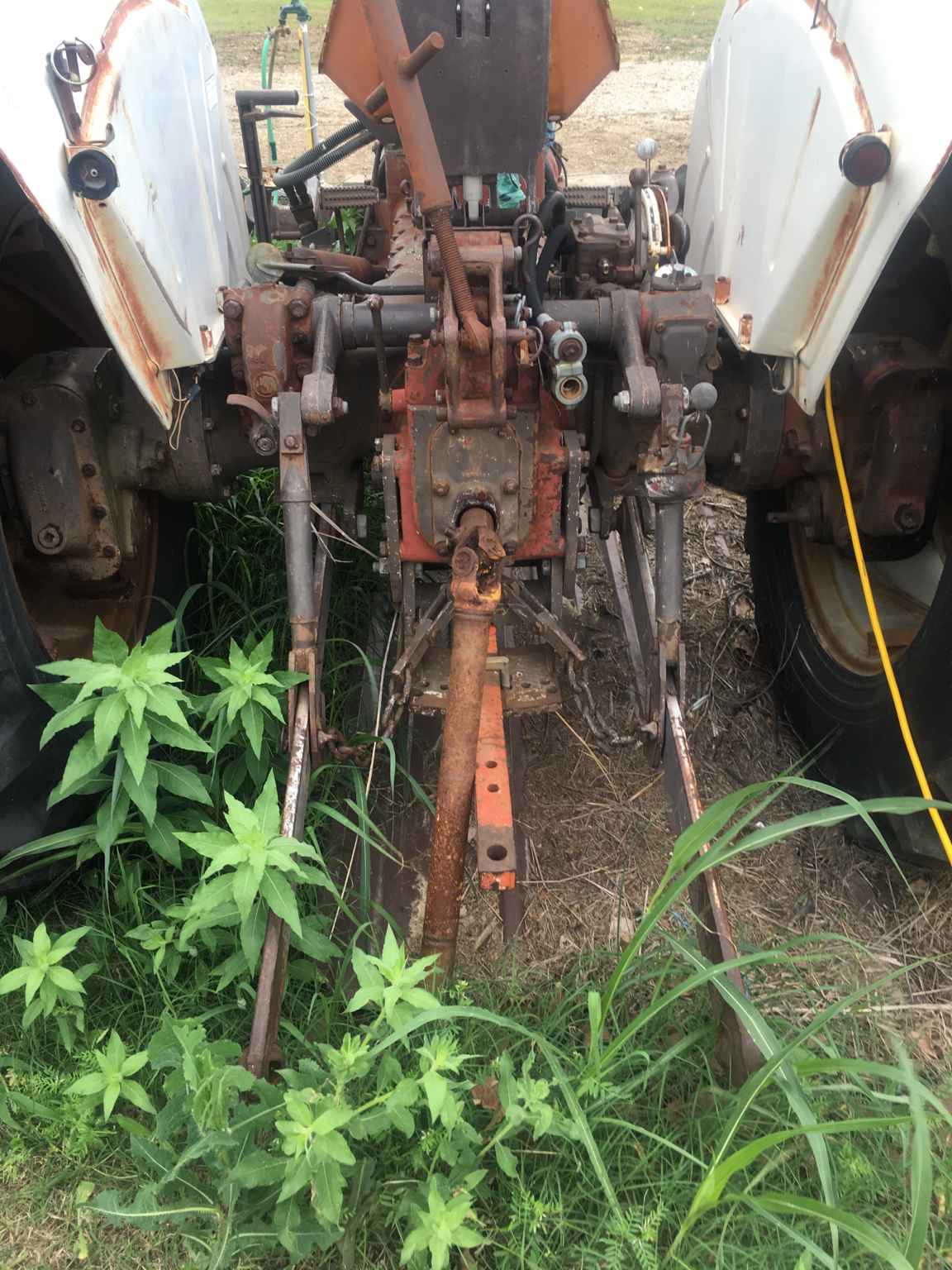

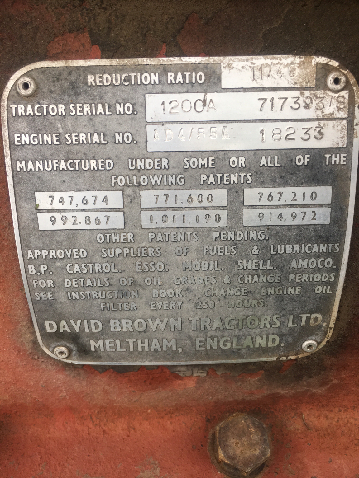

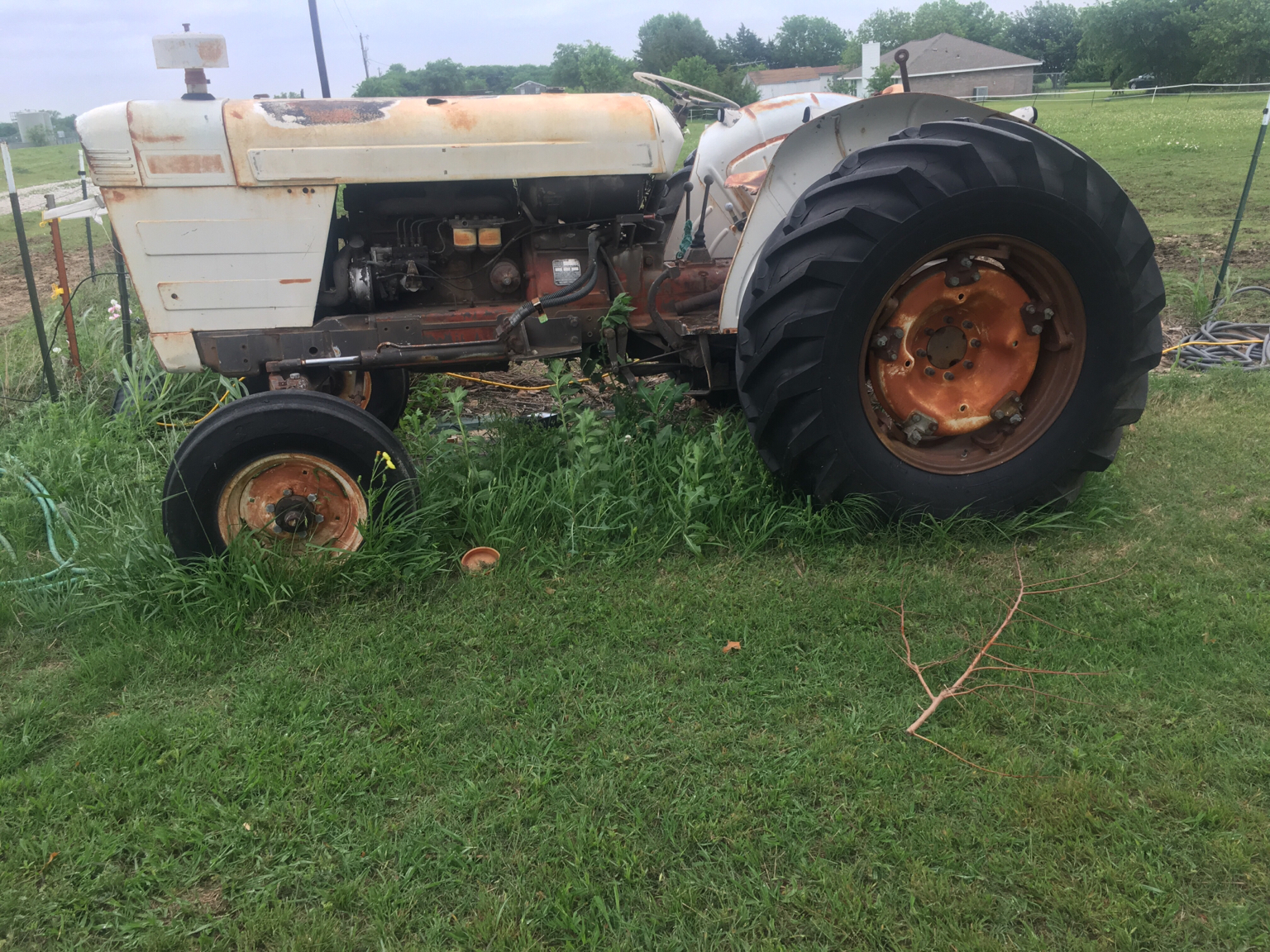

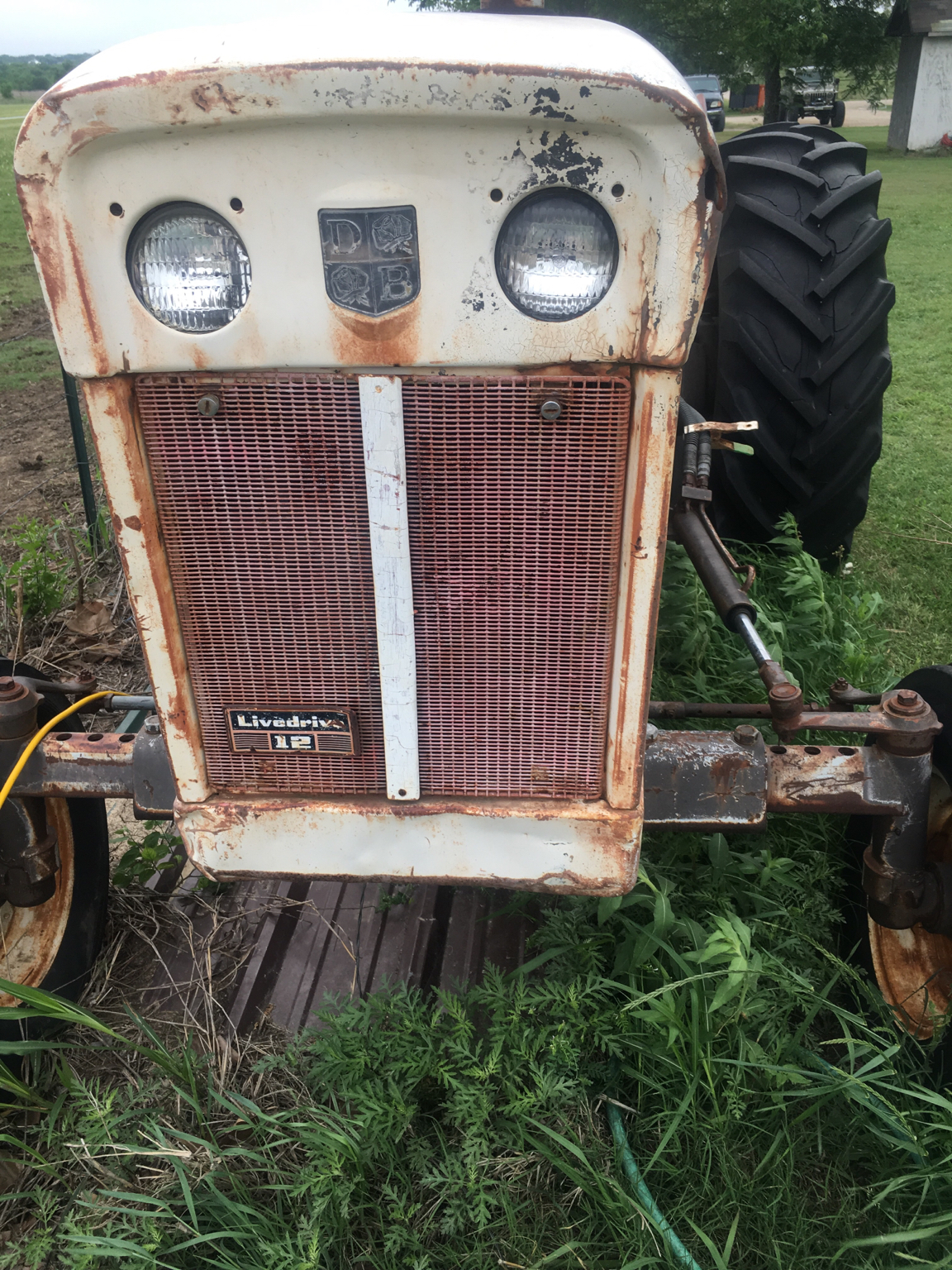

My elderly neighbor of 20 years gave me this tractor last year that my dad and brother were supposed to fix up for me.
I'm doing my best to learn how to fix, build and maintain stuff on my own, but I haven't got to the major engine stuff yet beyond checking oil, replacing filters etc... honestly, I really don't have the time to restore a tractor and I'll grow old waiting on a man to do it ;oP I also really need the money...
So...What is it? What is it worth as is? Is there small, cheap and easy fixes that I could do in a day or 2 that would significantly increase the value? I believe it's diesel that used to run on butane.. I was told they got it running a couple years ago but that is all I know.

Google searching told me it is a 1971 David Brown 1200 LiveDrive 72 HP which has some pretty decent reviews over the SelectoMatic tranny which was lower on reviews. DBTC Forum is dedicated only to David Brown tractors and has a pretty good following so many of you questions should be answered. I would start there.
Parts seem to be plentiful.
What is it worth? Not a lot with your description of it. Running and operating, TractorHouse has them for $3k to $6k. If it was mine I would check all the fluids, make sure it HAS some and nothing is dry, change the oil, drain the fuel and add 5 gallons fresh fuel, stick a good battery in it and start cranking. That Old Iron might surprise you and would be a nice size for your needs.

Also remove the PTO driveline that's hanging off the back before you start cranking!

looks like a nice old tractor, pictures can be deceiving, but if she runs, and you have a use for it, keep it. anything else you buy used will still require DIY'er knowledge / ability to repair. as stuff breaks down / needs repairs.
if you had a truck and trailer the haul the tractor to a local repair shop already for fixes that you can not do yourself. maybe keep, if not having repair shop come out and pick it up and then fix and haul it back to you, the hauling charges may eat you up on repair bills.
if you are like my mom, i show her were to check oil, were to grease, check fluid levels, how to change oil, and she does it, but once it gets to eletrical issues, and engine issues. then forgot it. and time to bring someone else in. normally me, if i can do it ok, if not time to bring someone else in before i mess things up more.
if it is beyond you to deal with, sell it and get something you can use.
you didn't say how many acreage you mow / use a rotatory mower (lamen terms bush hog) a tractor generally will move faster than a skid steer.

I have a buddy that has a similar David Brown. While a tough tractor it isn't very user friendly. Have you given that clutch a press yet? The clutch and steering on the one my buddy has are very taxing. Very hard to use finesse especially after running it for a bit. That tractor was made to hang an implement in the ground and run all day.
Also it has no ROPS.
Check the transmission case closely for water. I see a cobbled up gear shift boot that may be letting water in.
With the condition you describe I would sell and use what money you get from it towards a better tractor that you will enjoy using instead of wrestling with the David Brown.
I would say to get that PTO shaft off and set it aside sooner than later. That PTO shaft hanging loose like that is an accident waiting to happen.

Free 72hp tractors don't come along very often. I'd see if you can get it running, then use it to mow your 62 acres until you decide what other tractor you want to get. You may find that it's perfectly fine for mowing lots of acreage, and then you would've saved yourself spending ~$50K on a new 72hp tractor.
I still mow my fields with an 1952 8N and it does that job just fine.

Before you spend much on it, make sure the 3 point lift is strong. Many David Brown lifts began to get weak around 3500-4000 hours and the parts to repair them are now hard to find. Ken Sweet

I'm going to guess your a horse person. Depending on the condition of that tractor you may be better off selling it than trying to get it running. Before you replace tires make sure you can get it running and that the hydraulics work. Then by all means if it needs tires consider replacing them.
/ What is it? What's it worth? #13
This thing is 6000lbs+ and 65hp at the PTO. 3500lb 3pt lift capacity if the hydraulics work. It should push an 8ft bush hog no problem or even larger if you wanted to.

It is going to take a lot of coin to replace that with a new machine. I would bribe the brother and father with a good meal and some beer to get it fired up and a clear list of anything that it might need before entertaining what to do with it otherwise.
I have some old stuff that everyone else thinks is junk but fact is a fresh battery here and there and they just keep on working without complaint. A little quirky steering or a hard lever to move or shift is absolutely nothing when compared to the cost of a newer replacement that will when it gets as old not be cost effective to repair.
/ What is it? What's it worth? #15
Welcome to TBN - I see that the muffler is detached & lying near the floorboard. If the rest of the exhaust pipe wasn't covered, I'd be concerned that rainwater may have got into the cylinders after it's having set, uncovered & unused, for a spell. If there is water in the cylinders, then there's a risk of hydro-locking the engine when someone tries to start it, which could damage the engine. Highly recommend having someone who knows their way around a diesel just check that it's not a problem before anyone turns the key. Good luck, and let us know how things go!
