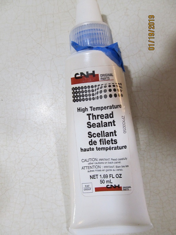

I'm going to use thread sealant for the first time and am looking for pointers. Pic below. With tape, I wrapped three times and left the first two threads with no tape.
With thread sealant, how important is to leave the first two threads clean? How much sealant do I use and do I have to put it on all threads? How tight do I tighten? What else?
Most important, will it reliably seal my loader connections? I have to replace the connection where the loader hoses disconnect when you remove the loader. I'm replacing the junction box with a quick disconnect lever setup and don't want any leaks. I mean, I could still use tape. Advice welcome.

I'm the OP on this. Is the sealer in the first post OK for hydraulic fittings? I can't recall but think it's the only sealant they sold. Anyone know?
   / What is correct way to use thread sealant? #7
I’m sure it will work fine. It should say something like water, fuel and oil. Teflon will work with oil.
   / What is correct way to use thread sealant? #8
Can't tell 'dogs. What does it say on the back of the tube? Pretty sure teflon type will work with most all oil products, Besides - if it's the only sealant they sold - what have you got to loose. Try it. If it works - great. If not - keep looking.

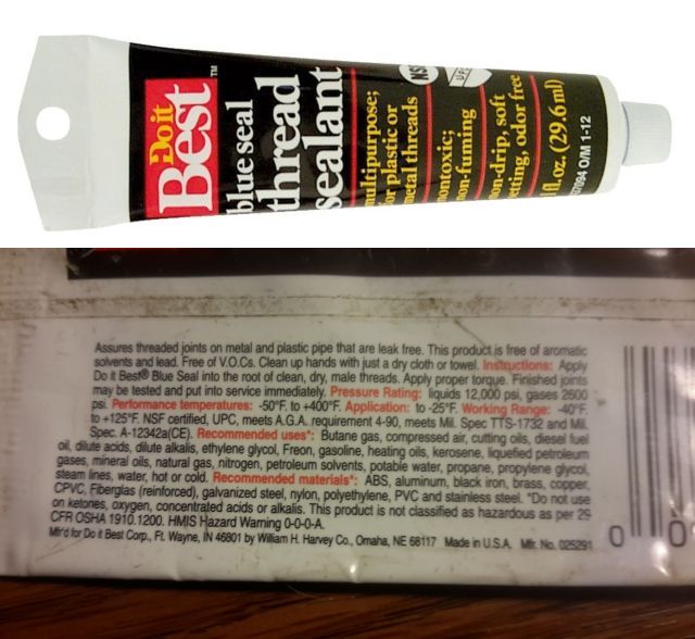

Read instructions on container..... This is my go to.. Use it on most everything....
Not a fan of PTFE tape always ends up a problem for me...
