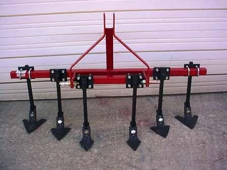

Tool bar with cultivator shanks,
With these arranged in an overlapping pattern.

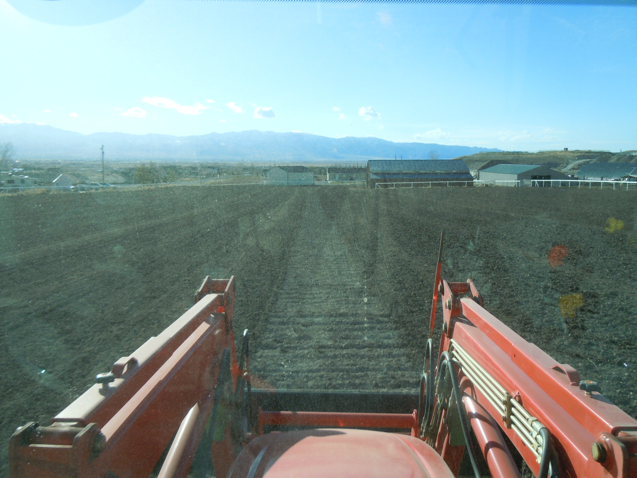

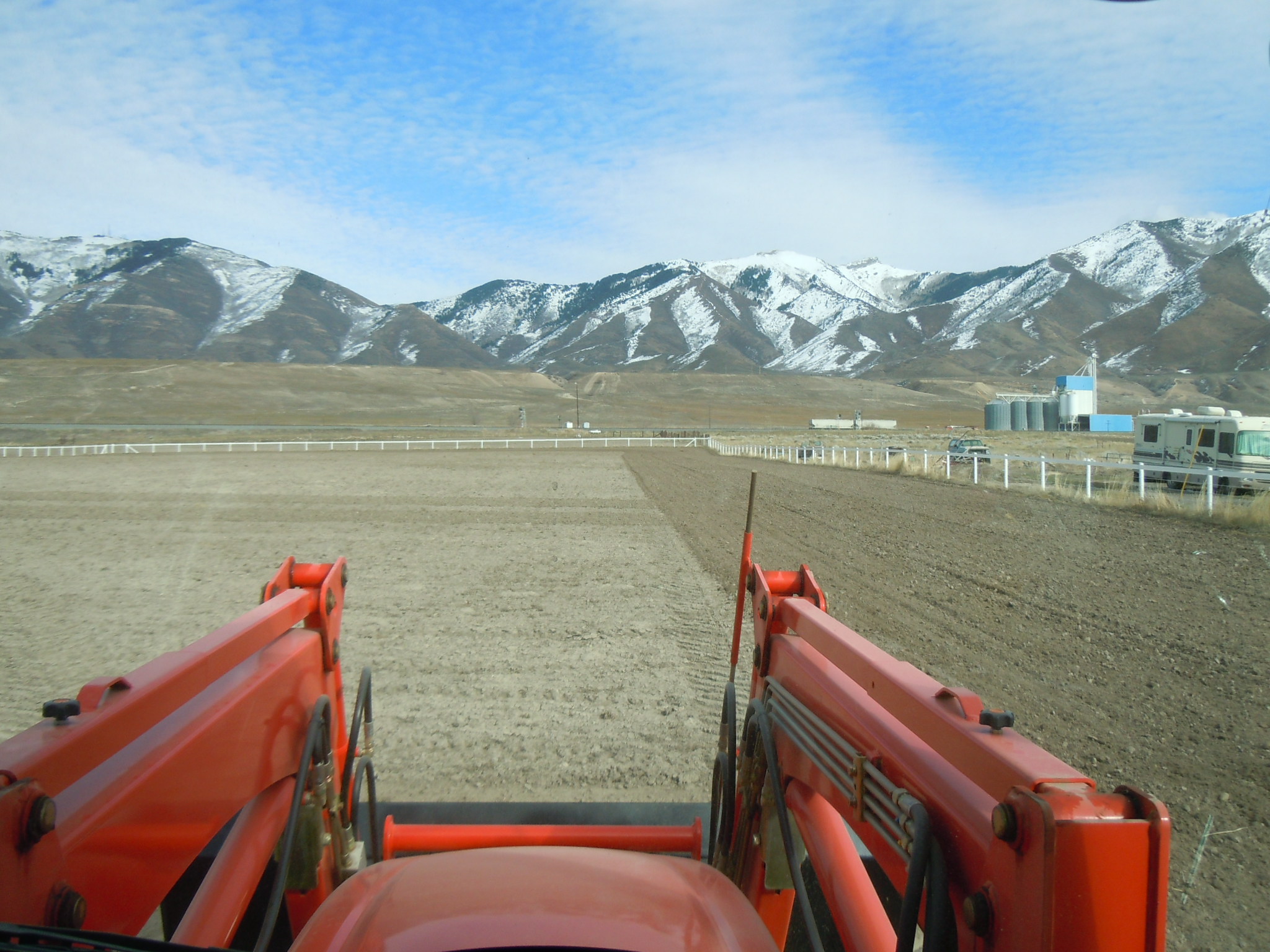

Once you have the soil worked up like you have in the picture with the weed seedlings, I think a large land plane might be your best bet. It would slice off small weeds and redistribute the soil into a nice flat/smooth surface.

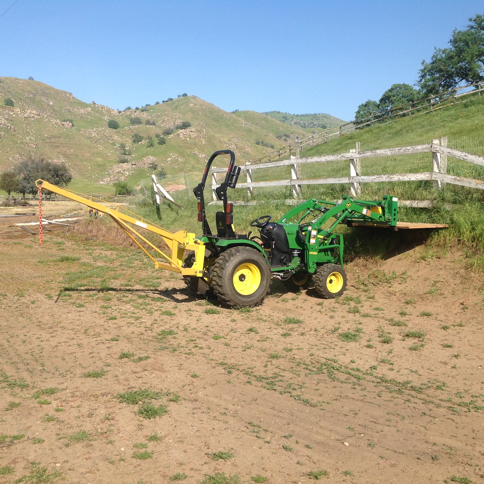

Your Chain Harrow should gather a lot of the debris. You can improvise a Chain Harrow Lift cheaply.
LINK: http://www.tractorbynet.com/forums/...c-countyline-tarter-boom-pole.html?highlight=
If you cannot burn, I suggest bagging the seed rich debris, then storing bags until you can later burn, or deposit bagged debris in a land fill.
