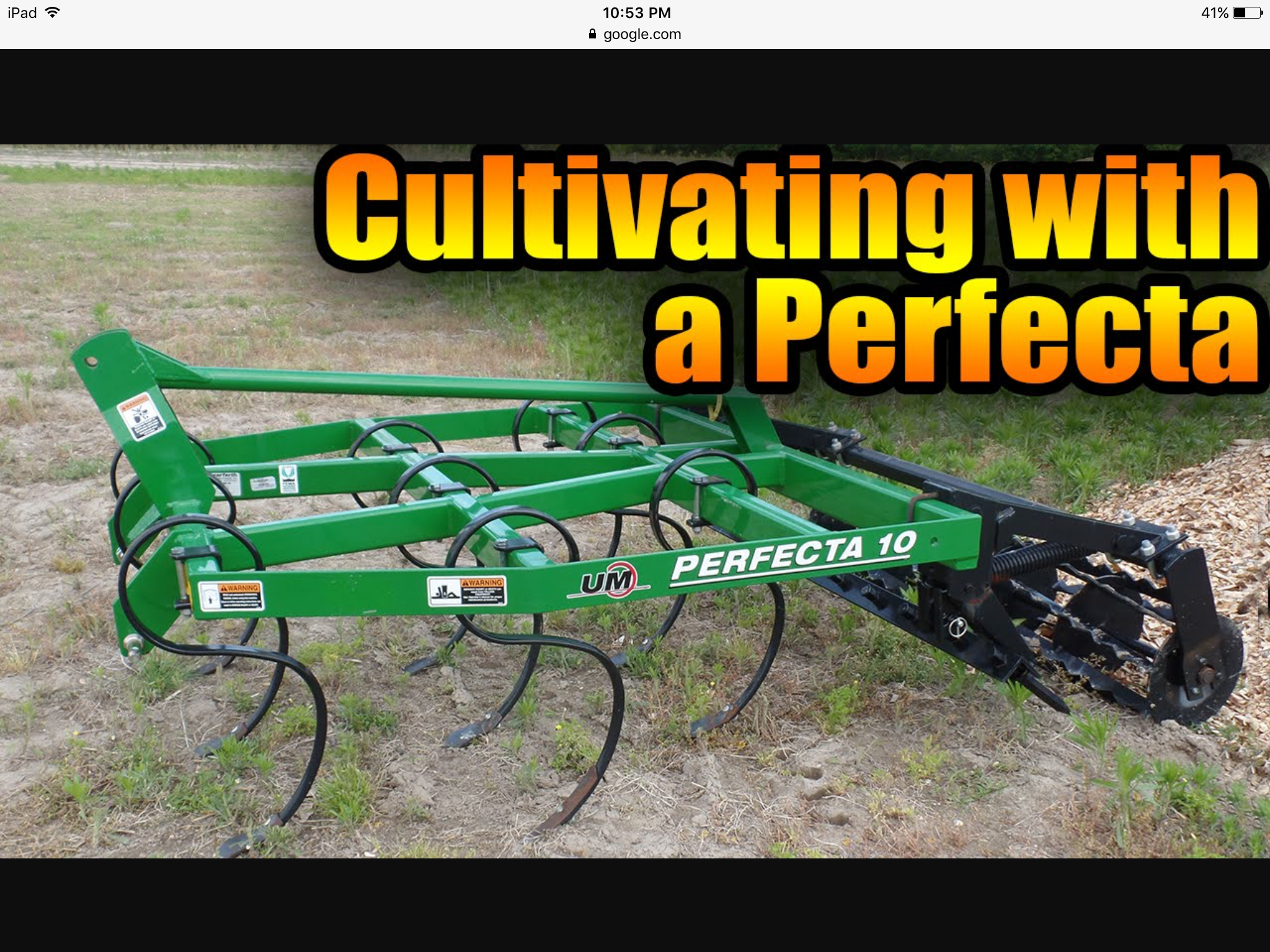

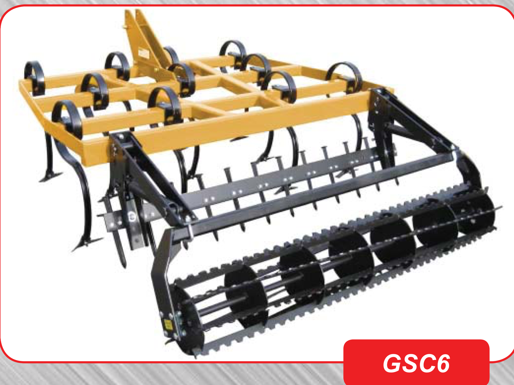

I am looking to purchase one of these two models of Field Cultivators to control the weeds from growing, the yellow one is a Gearmore built out of Chino California and the other is a UnverFerth - Perfecta built out of Kalida, OH. I will be purchasing the 5' wide model, pictures below are stock photos. Does anyone have any first hand feedback on these units, or any suggestions on the style of S-Tines to choose, there appears to be three different styles of tines and three or four kinds of tips. If you own this style of implement please share your operating experience or tine selection. Thanks

The weeds will always grow unless you have something else growing there. Make sure you have a plan in place. I grew up using a 12' S tine field cultivator with sweeps. It did a fine job, but we were planting into the tilled soil each year. You can't use it every year and expect 'good' grasses to establish. Every time you run that through your soil, you will kill BOTH weeds and grass. And the weeds are more resilient.
   / What implement works best for controlling weeds, foxtails. #80
You ainta gonna kill either with steel. Takes chemicals and considering the trillions of seeds a field of either generates, pre emergent every year would be necessary.
The STEEL under consideration by the OP in Post #78 may do it.
OP will still need to grow something else to prevent noxious weeds from taking over again.
<$3,000 for the train of Gearmore implements OP is contemplating.
I will never tell your Wife.
GEARMORE GSC6: http://www.gearmore.com/gearmore/do...l_Conditioners/BL0015-08_Soil_Conditioner.pdf
http://www.gearmore.com/gearmore/files/SoilCond_GSC.pdf
