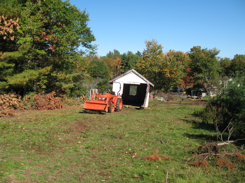

I've looked at some neat pictures of building moving on the Internet. It's incredible what has been moved.
Recently, I finished moving a 10' x 10' shed on our farm. I jacked up the little bugger and slid a couple of 4" x 4"s underneath. Under this arrangement, I lashed together a travois type of drag and chained it to the drawbar. I went about 150' up a hill, in a pretty much straight line and then turned it and backed up around 25'. The move went off without a hitch..err..with a hitch...err, well, anyway it worked, and worked well.
I was wondering what other folks have moved with their own rigs. What have you moved, what kind of tractor and equipment, method, distance?
Just wonderin'.

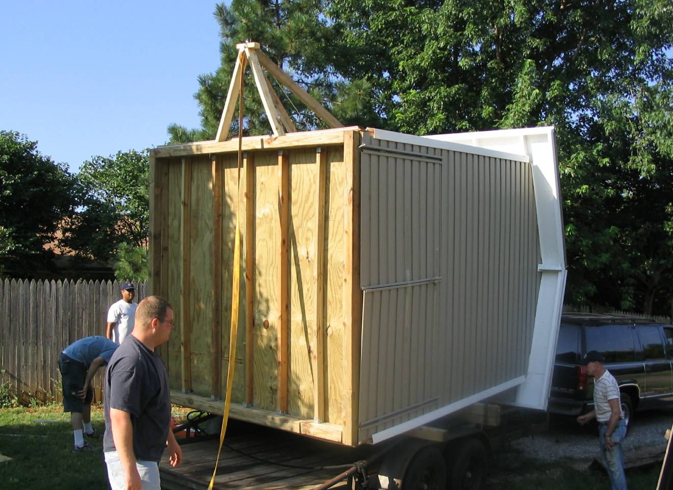

When we moved to our existing house, we moved a playhouse that I made for my doughter. It is 8x8 and roughly 12 feet high, it has storage underneath. I put a heck of alot of work in this thing, and I was not going to leave it. This was my pre-tractor days, so I built an a frame of the base, and I used some aircraft cable atached to the roof (on both sides). I set some heavy duty pipes in the ground and started tipping it over with a come along, once it got to the point of wanting to fall I used another comealong to control it's decent. On the back side the A frame I made helped keep leverage for the come along, this also helped tip it off the trailer. At our new house I reversed the process. All and all VERY smooth. It traveled about 5 miles no problem.

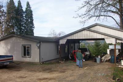

On a personal note, I am going to figure out a way to move this pole barn / carport around 40 feet. My neighbor who erects steel buildings wants to bring up his crane and just move it over. I am thinking of dragging it (in an engineered sort of fashion).
Anyway, have to set the footings first.
