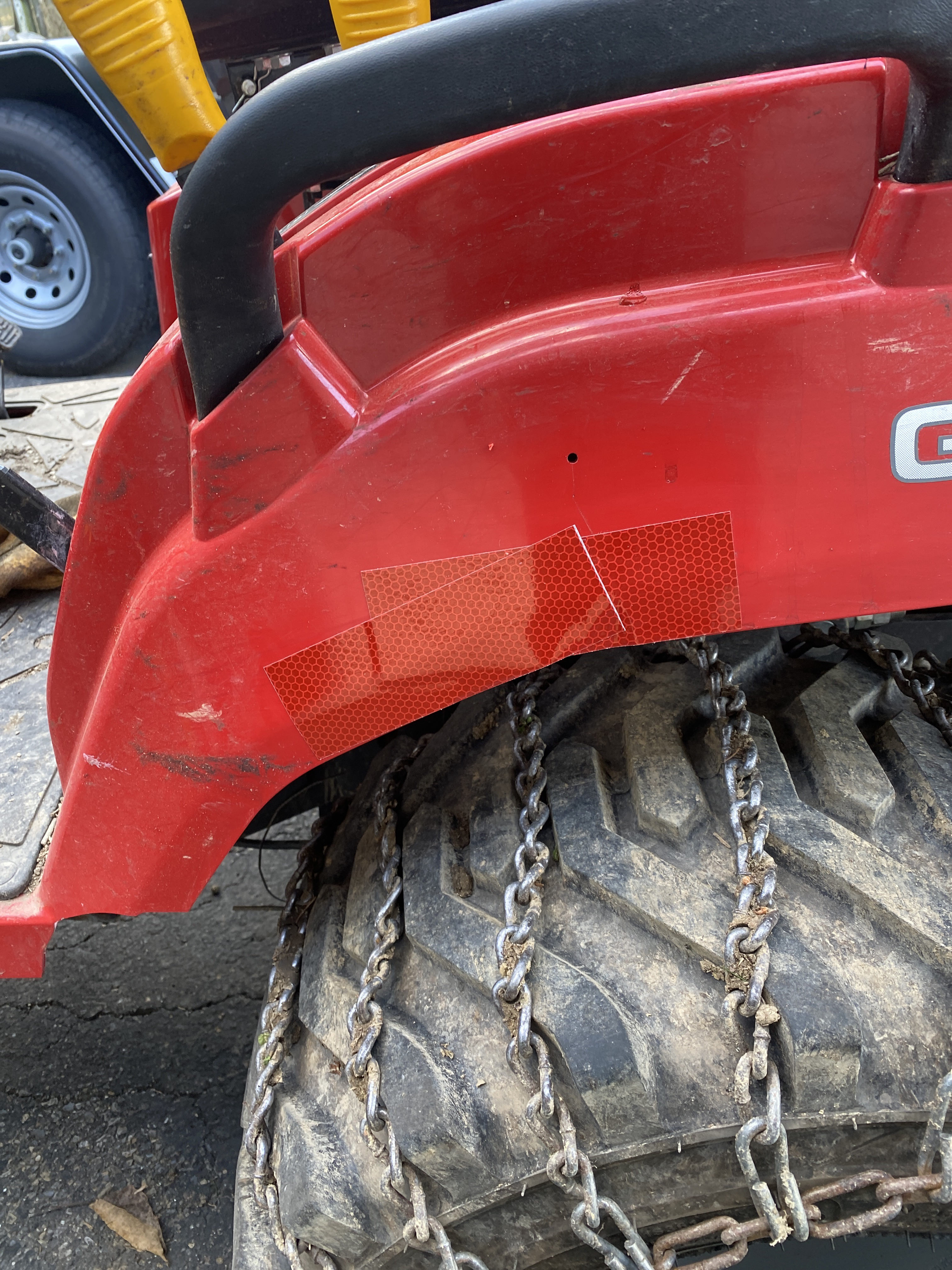

   / What have you done with/to your GC Series 2300, 2400, 1700 Tractor TODAY
#774
If I had the pieces I would glue and then zip tie, and so it goes.....
Ouch !
If it were me I'd probably purchase a 12" x 12" red anodized aluminum about 0.032" or 0.040" thick and cut a patch for both the inside and outside and use long pop rivets to sandwich your missing chunk fender.
Also the aluminum could easily be formed to match any shape on the fender that is not flat.
It looks like you have a vertical crack in your fiberglass fender, if so I'd drill about a 3/16" diameter hole at the top of the crack so that the tractor vibration does not extend the crack.
Good luck,
KC
   / What have you done with/to your GC Series 2300, 2400, 1700 Tractor TODAY #775
I do like the idea of flared wheel arches, but then you would need to get spinner rims.
Could maybe put something on the inside that fiberglass won't stick to and fill in, sand and paint?
Or a big sticker .....
   / What have you done with/to your GC Series 2300, 2400, 1700 Tractor TODAY #776
Temp fix
Not worried about the bottom (no cracking)
When I get roundtuit I’ll plate it with aluminum and rivit it in place.

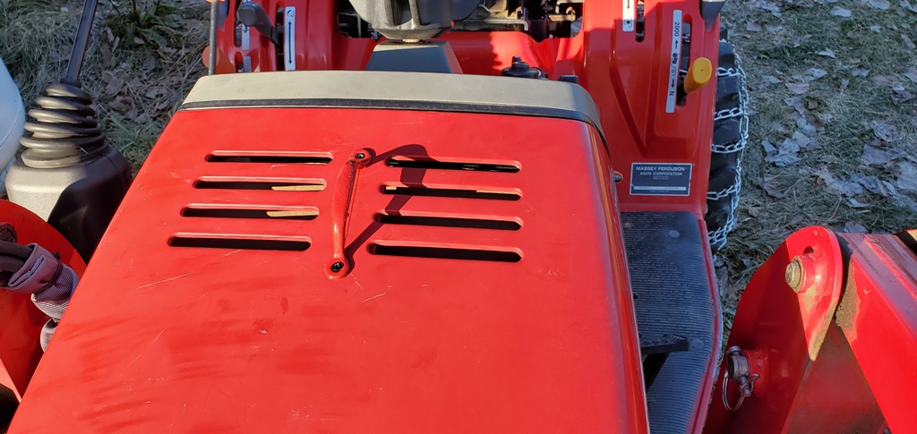

not sure but the boss plow red rattle can looks very close to massey if color matching an issue. its just expensive can though. will experiment on a worn spot on my 2400 as I need to warm up a spot on v plow and hit it anyway.
I just added a grab handle for hood (ignore bad paint job org was oily and its 20+ mph wind outside wind chill 6 deg) and the boss plow paint can is VERY close match.
Touch-Up Spray Paint (12 oz.) | BOSS Snowplow
expensive though but is a decent quality paint
