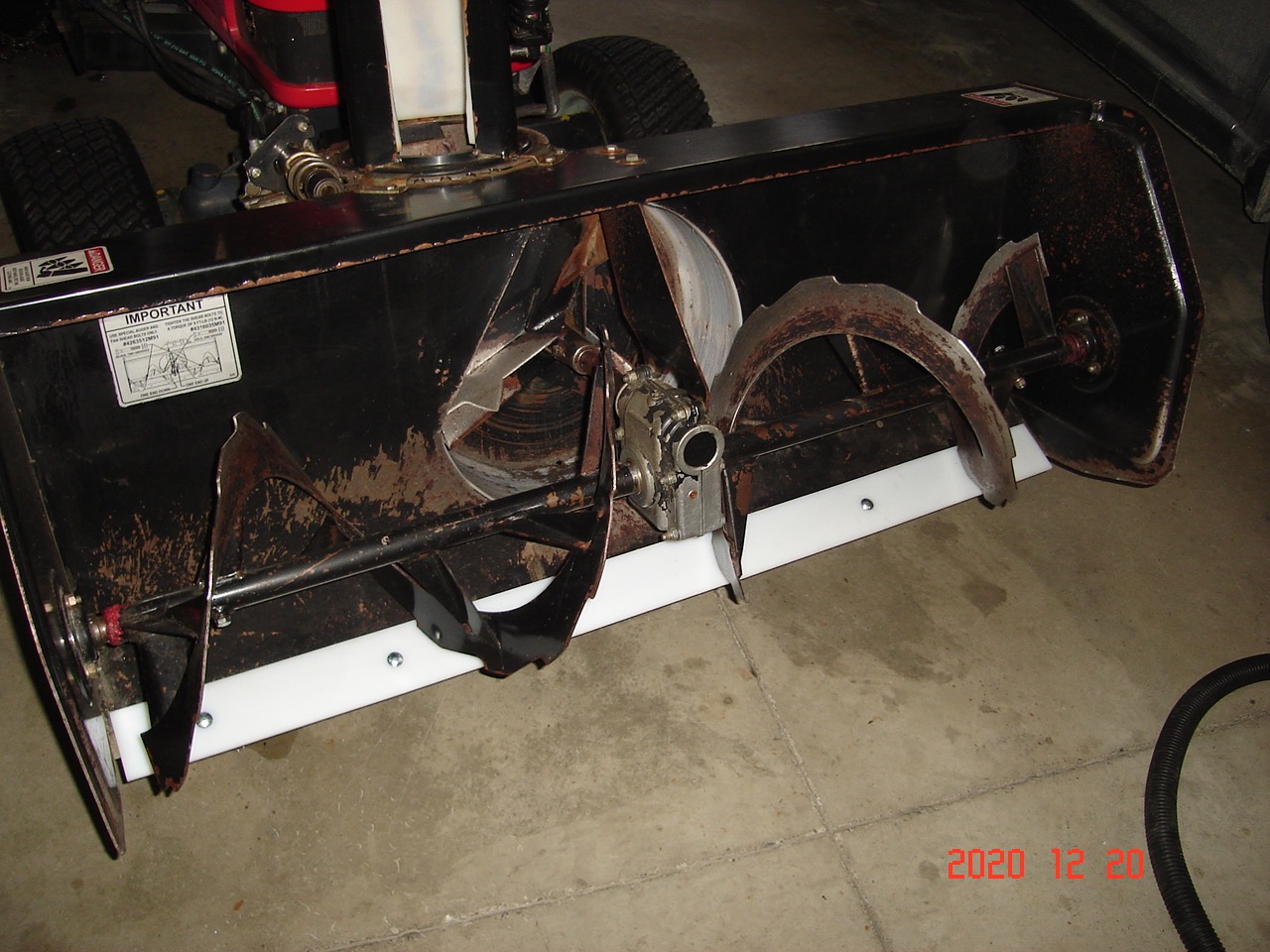

OK, I'm finally FINISHED with my new UHMW skid shoes for the Dozer Blade !
Today I installed the skid shoes onto the Dozer Blade and adjusted the height with the existing spacers to the height I was plowing with the OEM existing skid shoes.
There was about 3"-4" of snow on the driveway, so I tried out the new shoes and they worked a lot better than the old shoes.
All the time I was plowing, I was using the float position and never had to raise the blade while plowing, and it's nice not to have to make adjustments from the float position.
With the old shoe I would of had to raise the blade many times in order to not dig into the gravel driveway, because this last week in December has been quite a bit warmer than normal.
Not enough to melt any snow but enough to soften up the ice that's normally on the driveway (sort of like late March or early April during the spring thaw).
Here's the final 2 pictures of this project:
Previous post for this new UHMW skid shoe project are #671, #672, #675 #678, & 681 & #701.
KC

Gonna hafta get me wunna those, KC.... We had a little less snow (23-24") where I am, maybe 30 miles north of Pixguy, but still had to go over areas twice due to snow "rollover." How did you fasten that to the blower (maybe pics of the outside)?
irvingj, I think I used 10-24 machine screws with nylock nuts and fender washer (just thru bolting with materials I had on hand) and in the 90 degree corners on the outside is just a light gauge aluminum angle to thru bolt the risers (again I just used the parts and pieces I had on hand).
If anyone wants to know the specifics, I can take some measurements, but I'm sure all of you can improve on these risers (like a 90 degree bend in the riser corners) ?
I do think that the cutout for the snowblower discharge chute is a generous opening if I remember correctly.
Thank you to everyone for the kind words on my new skid shoes fabrication for my MF 2340 Dozer Blade.
And Gene, for a old 70's man that cannot see the welding puddle for crap anymore (I now weld mostly by feel these days), you do know I am selecting the best for the pictures, ha.
Here's a picture I have showing some of the outside of these risers:
KC

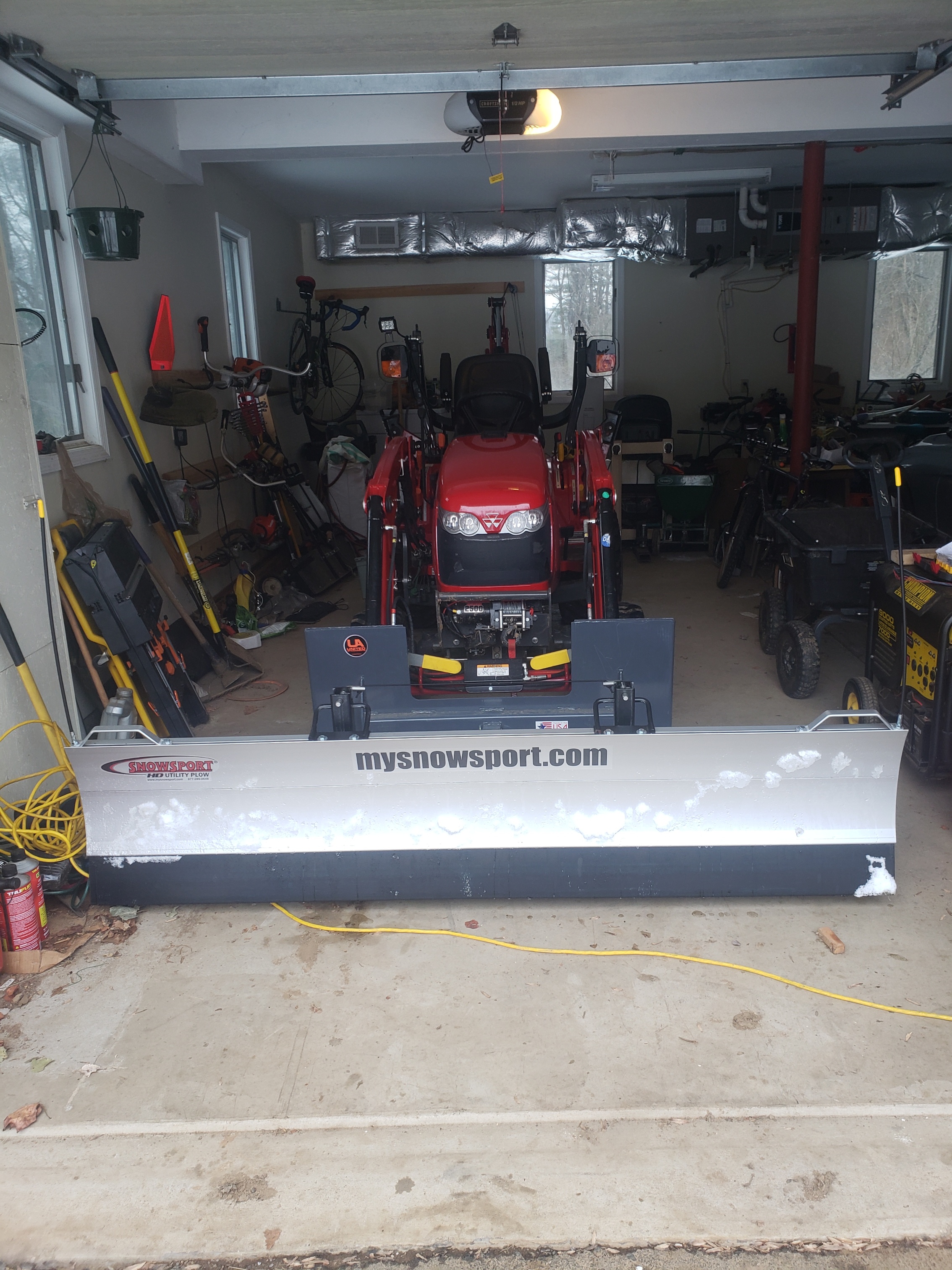

This is the blade I use, had float ends which I removed as the snow would stay on the blade and not shift out to the side.
Was worried it would be too big, but so far it works well in 4WD. Not so well in 2WD. No chains needed so far, but do slide down a bit on sideways bottom of driveway.
Still jealous of you with the snow blowers, but had this plow already and for about $150 adapted to the tractor SSQA, so only takes a minute to swap out to bucket.
Nice not have to lift anything to attach.
   / What have you done with/to your GC Series 2300, 2400, 1700 Tractor TODAY #719
Holy.... How wide is that blade? 7'? The thick and heavy snow where I live would stop my GC dead in its tracks with a blade that size.
   / What have you done with/to your GC Series 2300, 2400, 1700 Tractor TODAY #720
I thought so too, When I angle it, no problem. Would not try to move too much straight on !
