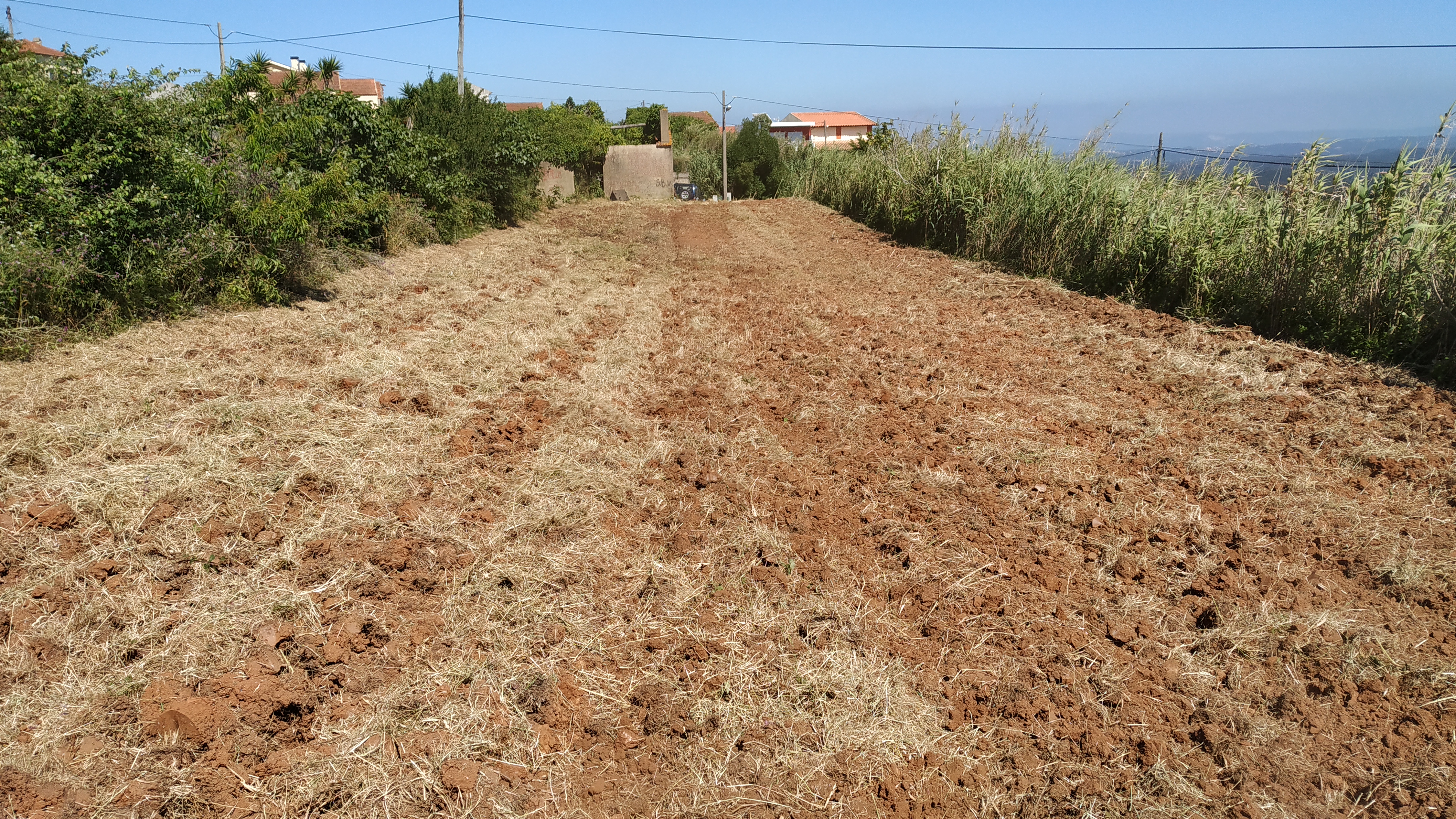

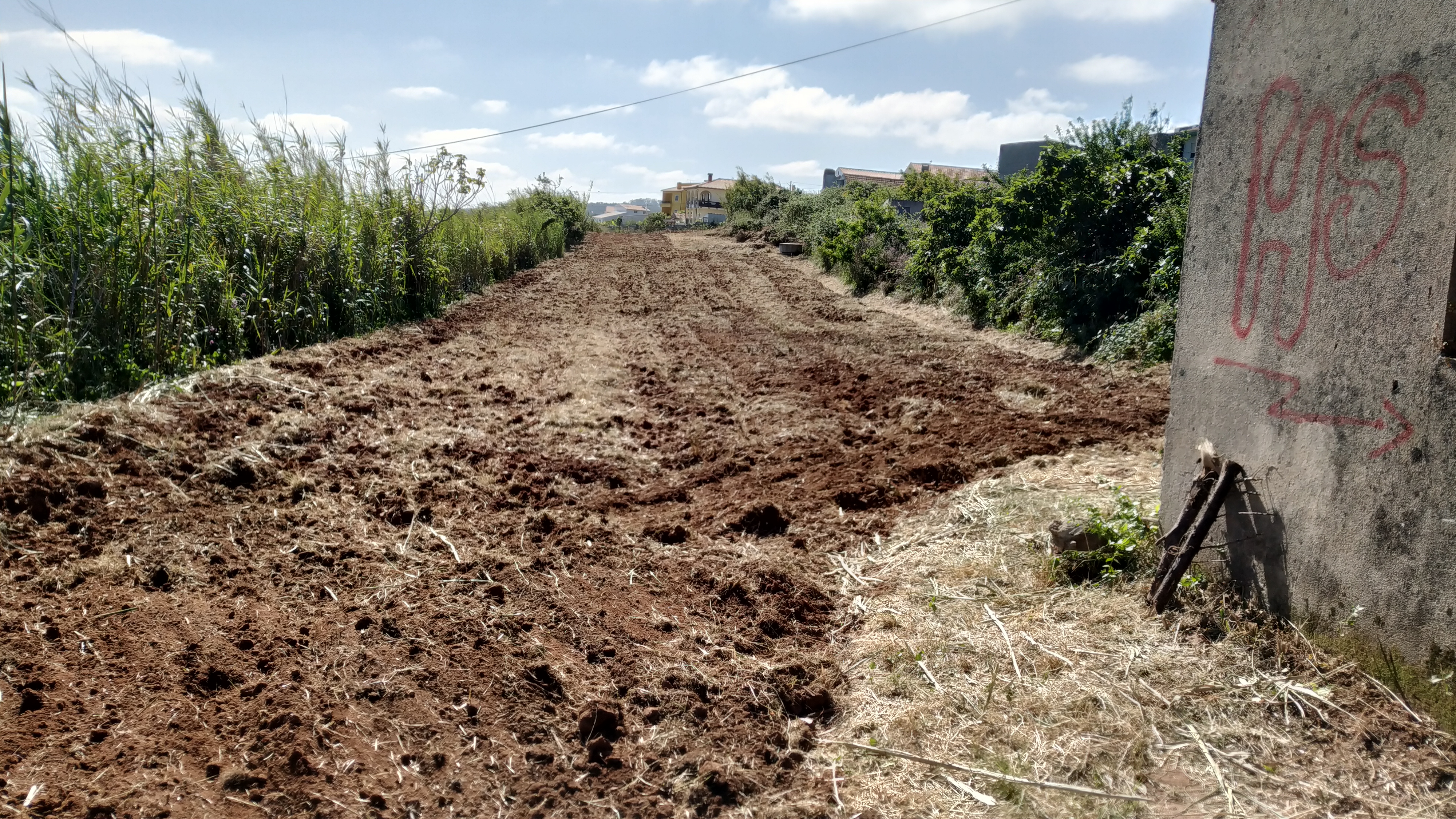

Last Friday, I used a less common/known implement to loosen up the soil on a field that I had previously mowed. The plan is to grow olive trees sometime in far the future, so this was a try to weaken the brush a little bit.
The implement is called a Spading machine. Spading machines are agricultural machines designed for loosening and breaking up the soil.
The principle is the same as that of digging by hand with a spade: blades are driven alternately into the soil, clods are lifted and thrown backwards, and the surface is leveled off by the action of a bar or rake.
If you're interested in learning more about this machine, you read it here: SPADING MACHINES
This field I worked on, haven't been touched in 30 plus years. It's an already very hard red clay, that got even more compacted through the years. I also started mowing every year since 2010 or so, which compacted more.
First time I dropped the implement on the ground, I almost jumped of the tractor. The spades had a very hard time trying to dig into the ground. The machine goes about 10 inches deep, I had to go 5" at a time and do a second pass on full depth. The spading machine kept jumping and banging in the back of the tractor.
It was the hardest task I ever done to a tractor. 6 hours with a 660lbs implement bouncing in the back and throwing a 4400 lbs tractor around like nothing but the Branson is a strong and robust tractor and handled it like a boss! No damage at all other than a bent PTO shield that can easily get fixed. I almost lost the big metal guard on the spading machine as it lost all the bolts that hold it on the left side but I had some spares on hand.
A tiller wouldn't do anything on this soil and the huge 16" bottom plow I have it's too big for this tractor, so I don't think that would work either.
Here are the pictures of the final result. On the left picture, you can notice the difference between first pass (left side) and with two passes (right side). The right pictures, it all done.
And a little clip of it running. It was the second pass, which was less violent and I could finally grab my phone without the risk of dropping it. :D

Looks like it did a great job! Interesting implement, thanks for sharing!

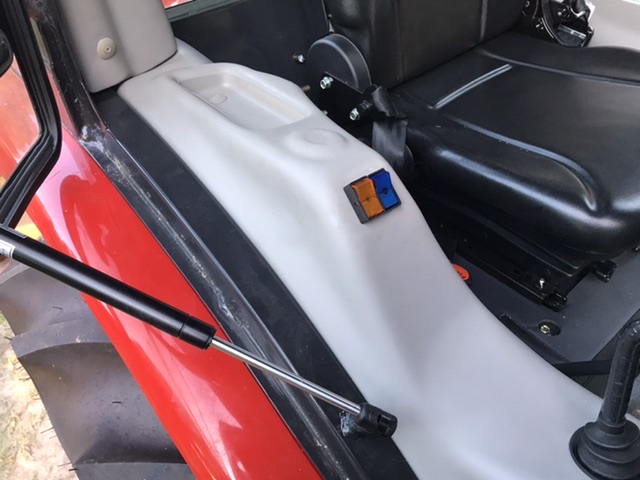

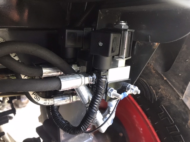

I have a ditch bank flail mower coming this week and decided I wanted to add float to my rear remotes so the head can follow the contour of the ground.
When I ordered my 4815C, they said float option was not available for rear remotes on the 15 series. So I added two, 2 way solenoid valves to tie the ports together on each spool.
Turned out nice and works well! Now all I will have to do is flip a switch and the cylinder will float.
That's a nice clean install K5. How much does the flail weigh?
