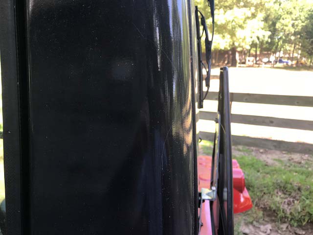

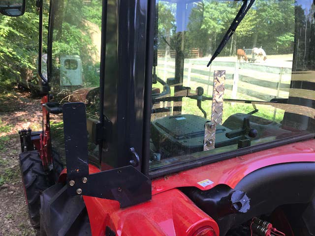

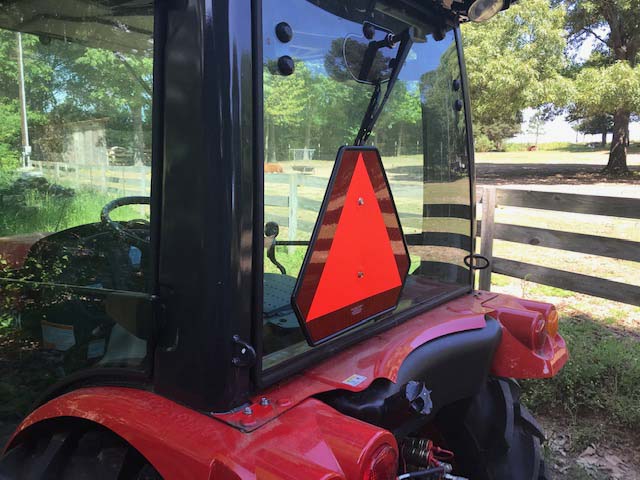

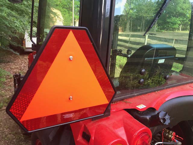

I never liked the way the SMV sign on my Branson 4815C mounted. It protruded beyond the footprint of the tractor. Because it was on the left side, I could not get close to the fence without it hanging. My finish mower discharges to the right. See picture below.
I noticed there is 2 window mounts not being used for anything so I turned them around and made a new bracket for the sign. I had a scrap piece of aluminum diamond plate that was rigid but light weight. I put a Z bend in it to clear the window wiper.
I am happy with the final result! Now I can mow without worrying about hanging that thing all the time. It could not be in a better spot on the window as it doesn't interfere with my vision of things at all! Perfect!
Just finished mowing and it sure was nice to mow close to the fence line without worrying about the sign. I watched it closely and never saw any vibration or it move at all. I think we are good to go! :cool2:
