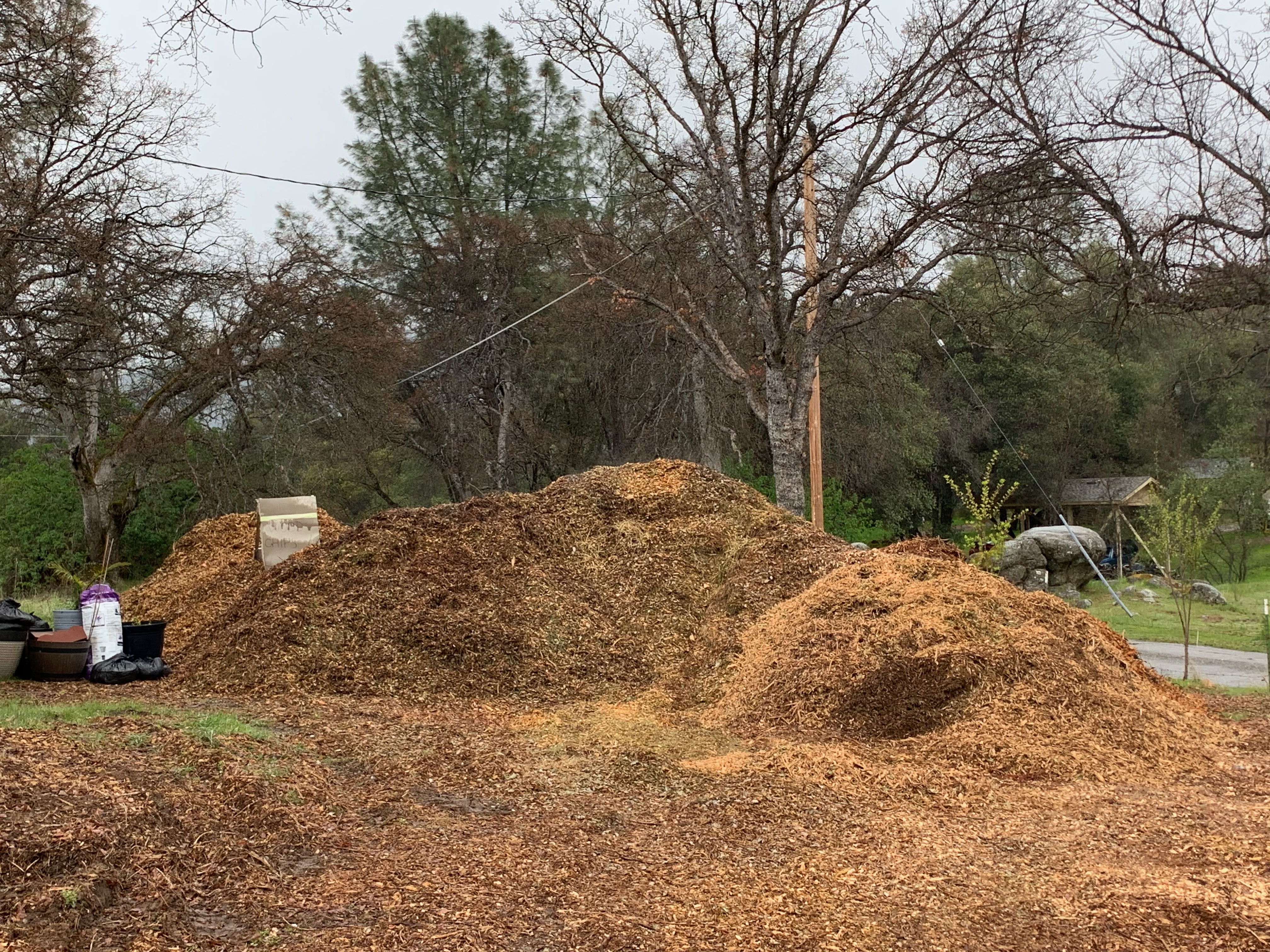

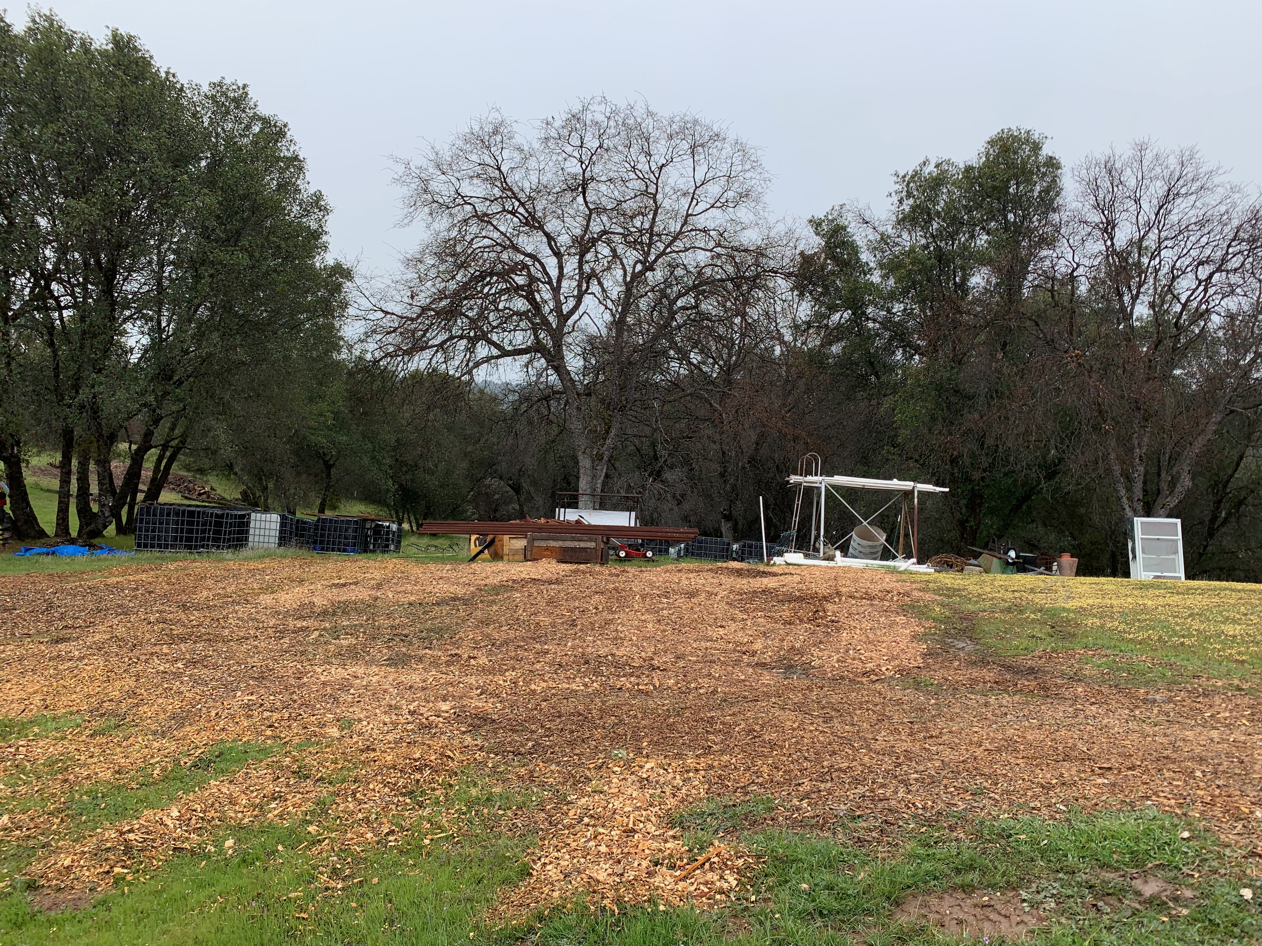

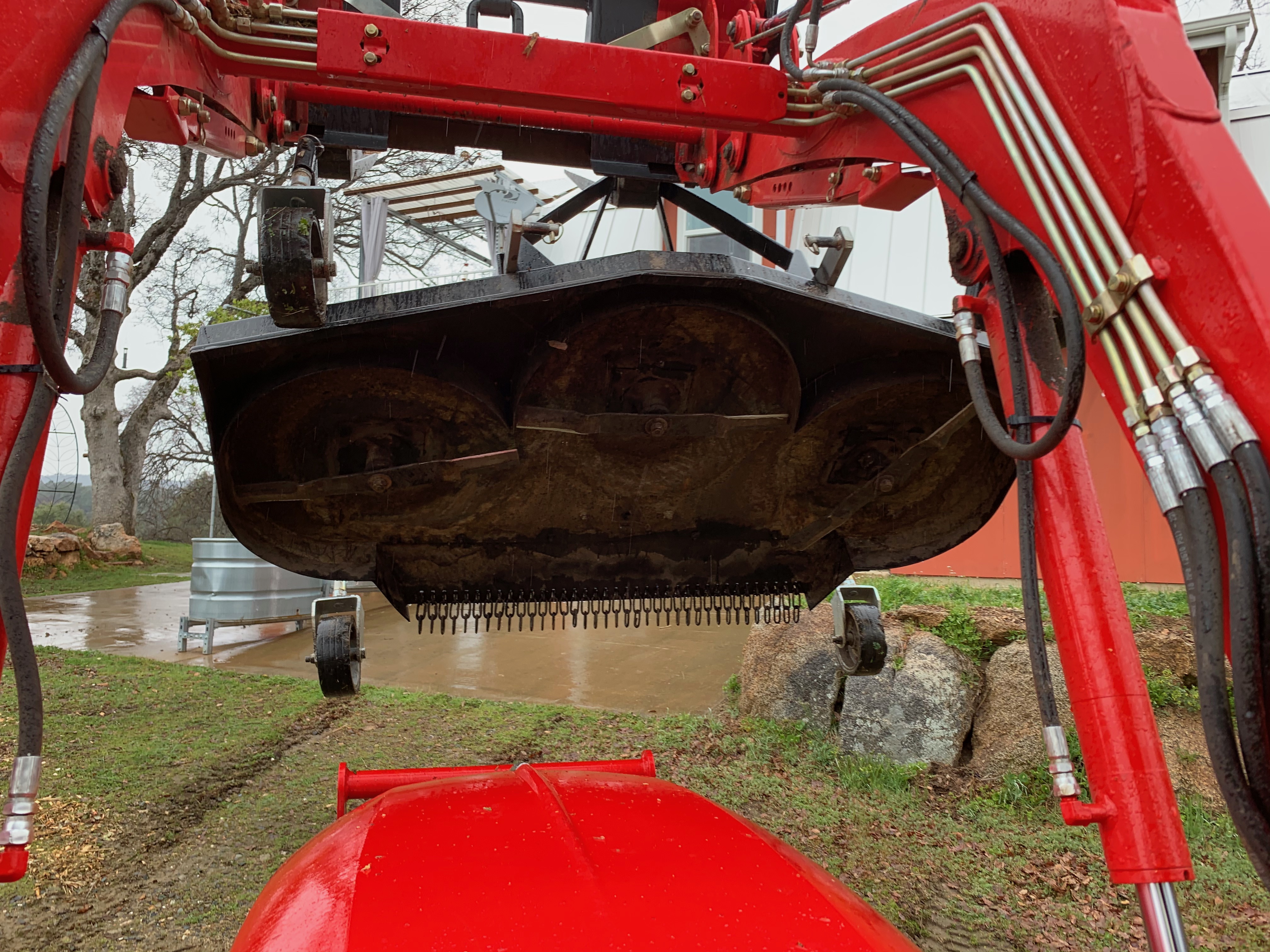

It's raining here the last few days but I used the forks and a sling to bring the finish mower into the shop for some overdue TLC... sharpened, lubed, etc. Also moved wood chips from the chip pile to the laydown area to manage the mud.
