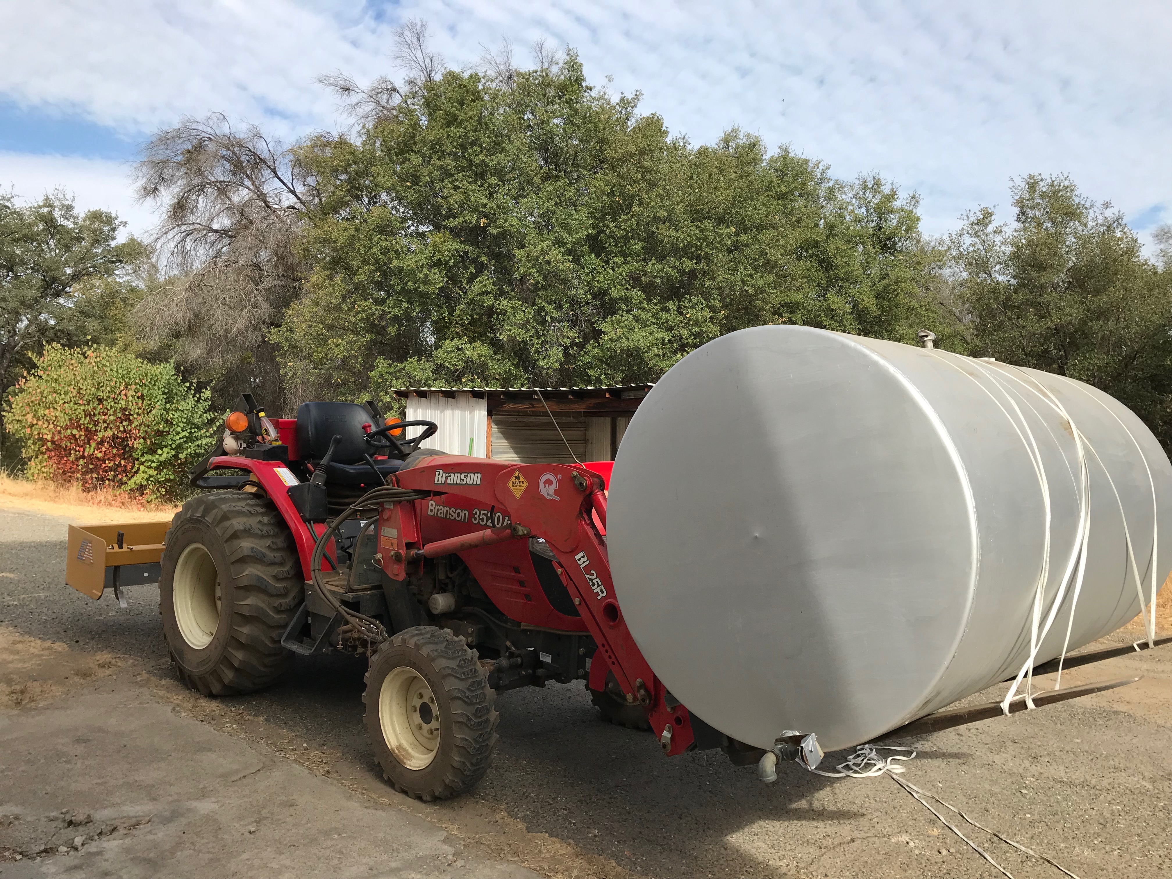

Bought this old diesel tank from my neighbor. Moved it and the stand over to my property.

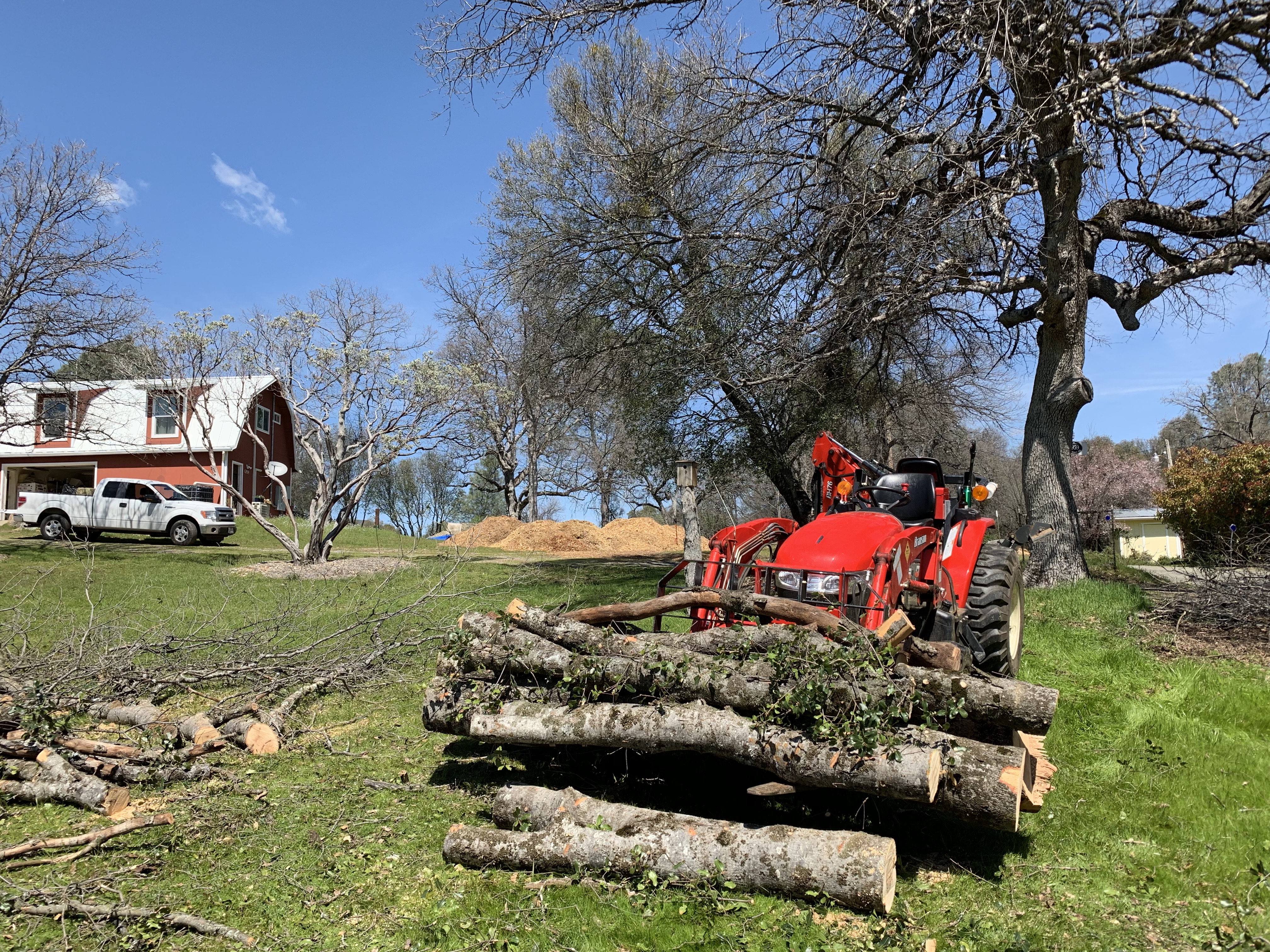

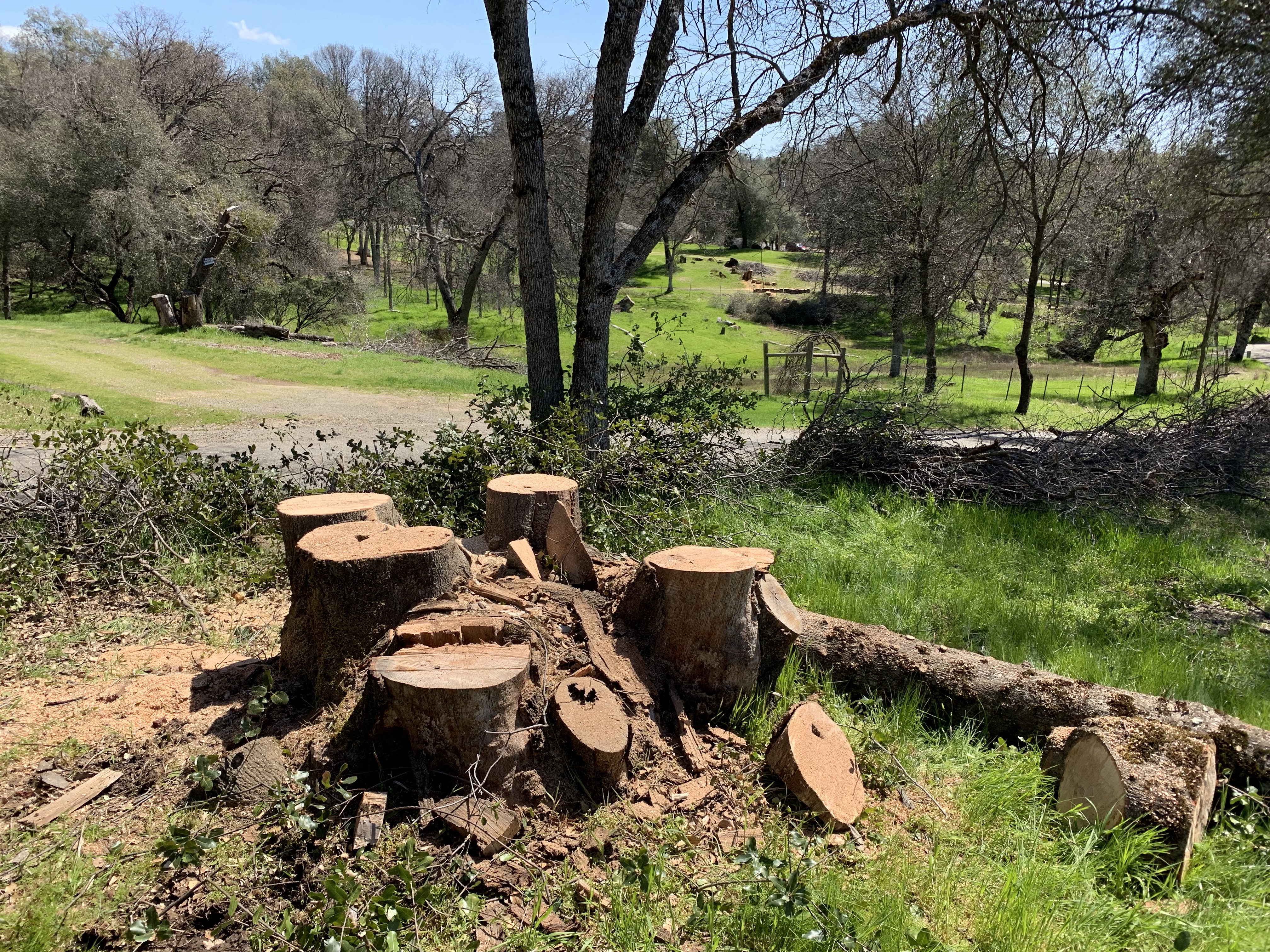

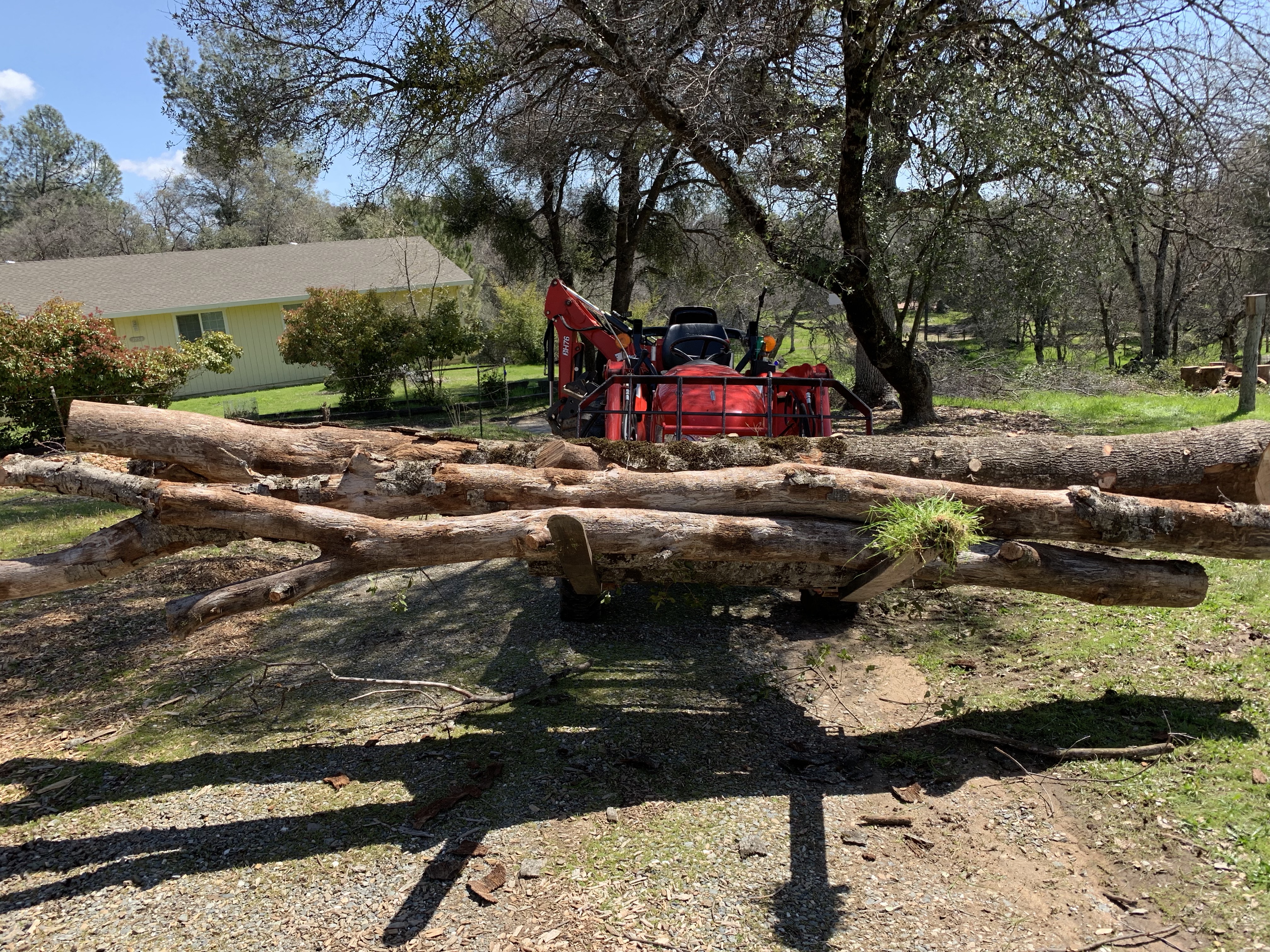

I attached my backhoe because I have to dig the footings for the new carport. I really struggled with the hydraulic connections. I then took down an old dying multi-trunk oak. I wish I had a grapple but make the most of my pallet forks.
Wow, Bob! If you fill that tank with diesel, it will supply your Branson for a few thousand hours of service. Do you have to put in a containment pad?
   / What have you done to your Branson today? #328
I've wondered about that and have seen others without containment but I have to get definitive word from the building department. Minimally it was my intention to build a nice pad for it.
   / What have you done to your Branson today? #329
To prevent you from having even more work building a pad, you can drop it at my place and fill it up :D
