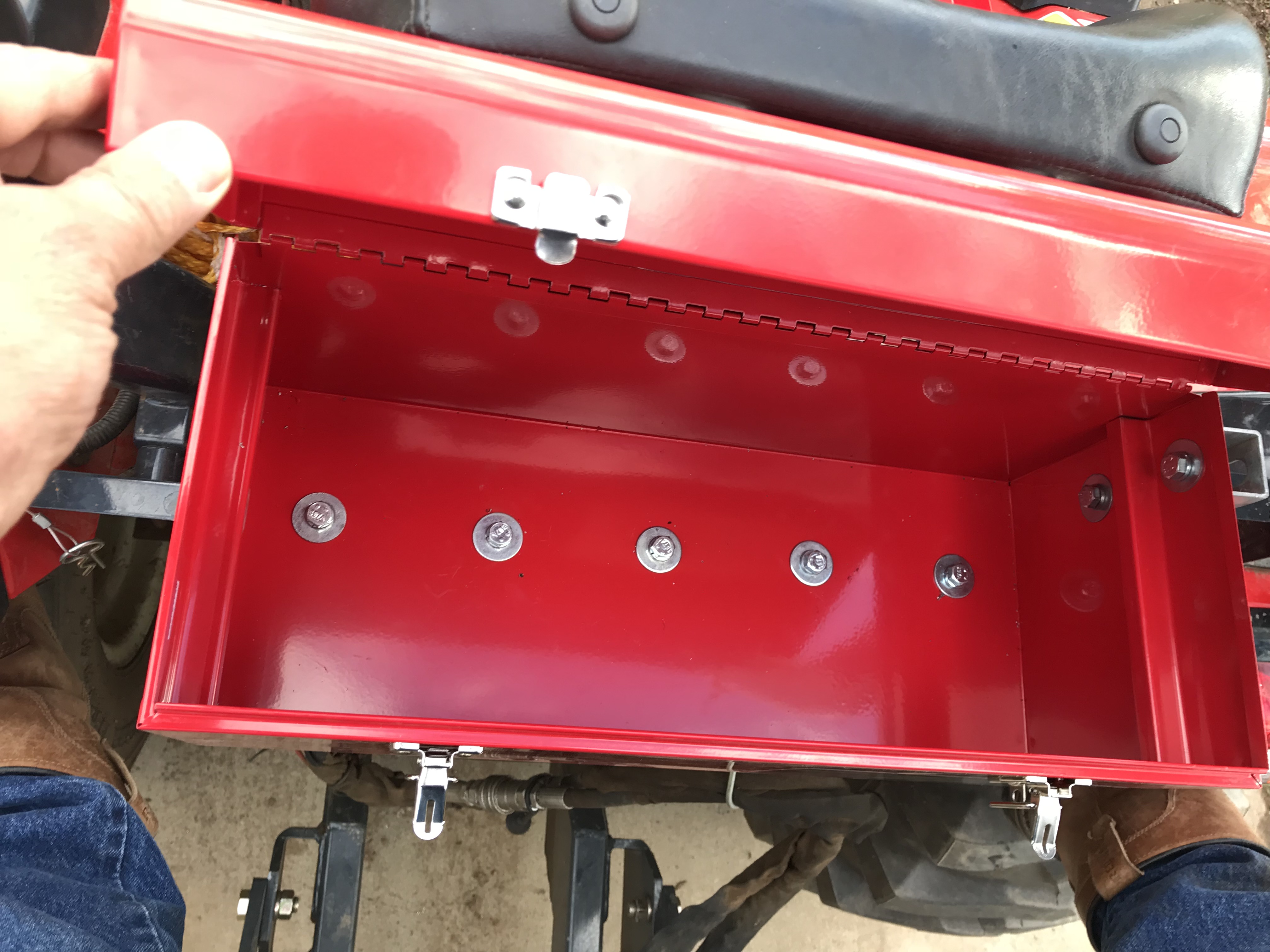

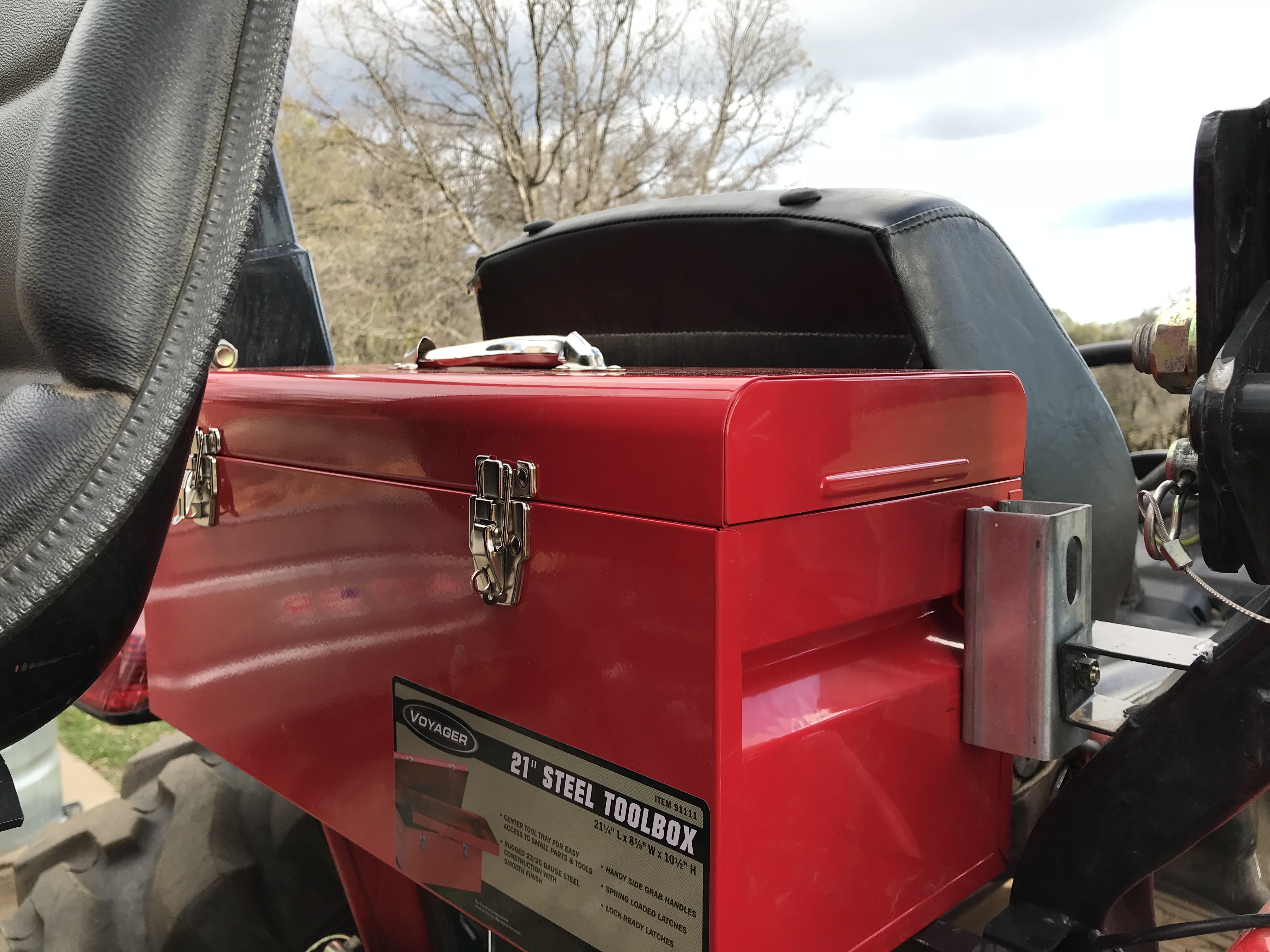

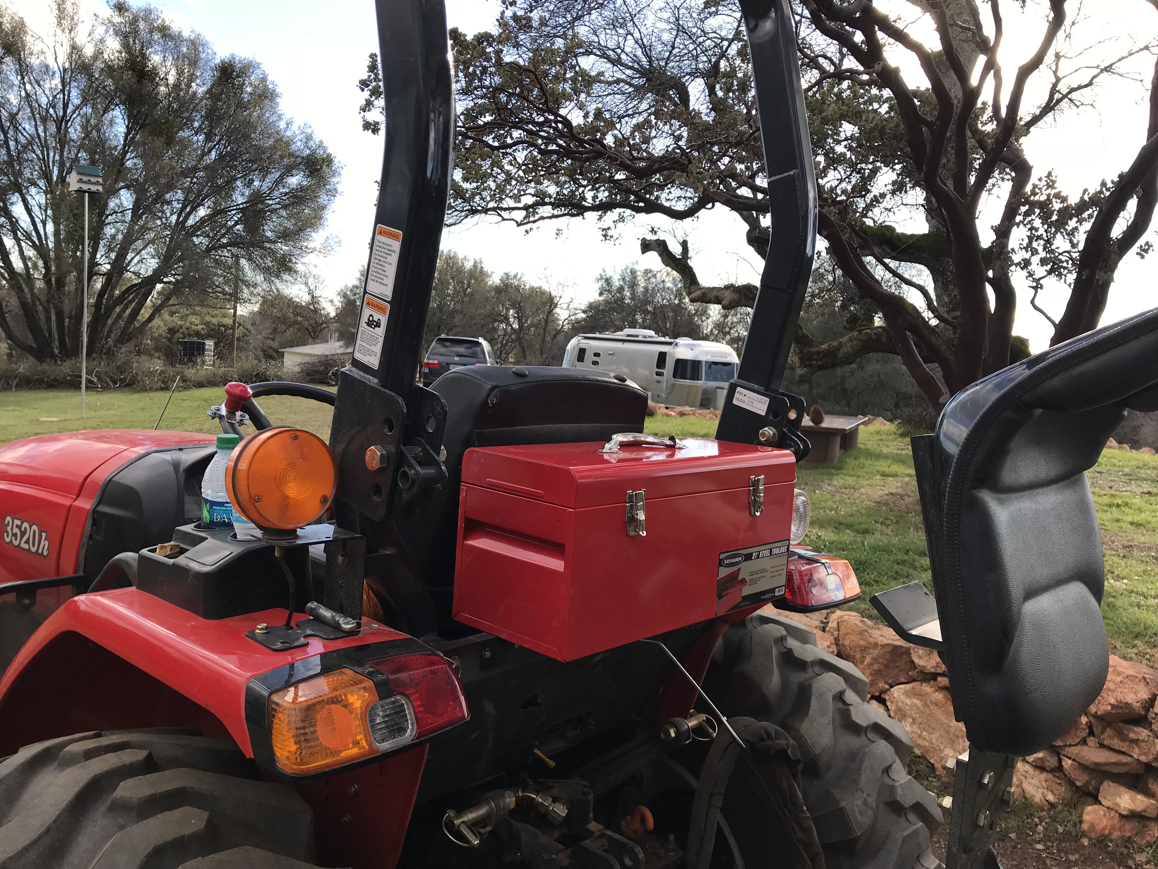

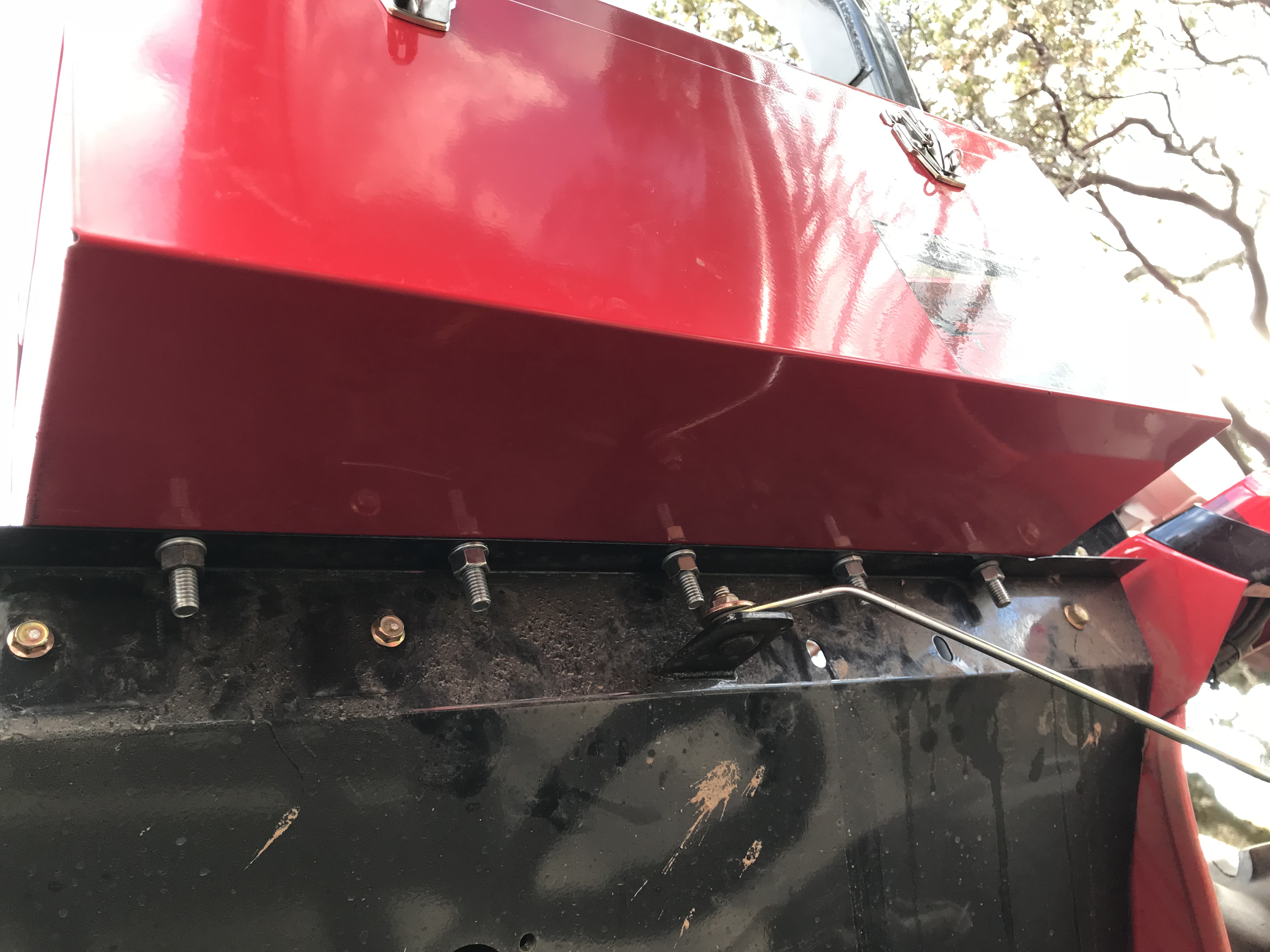

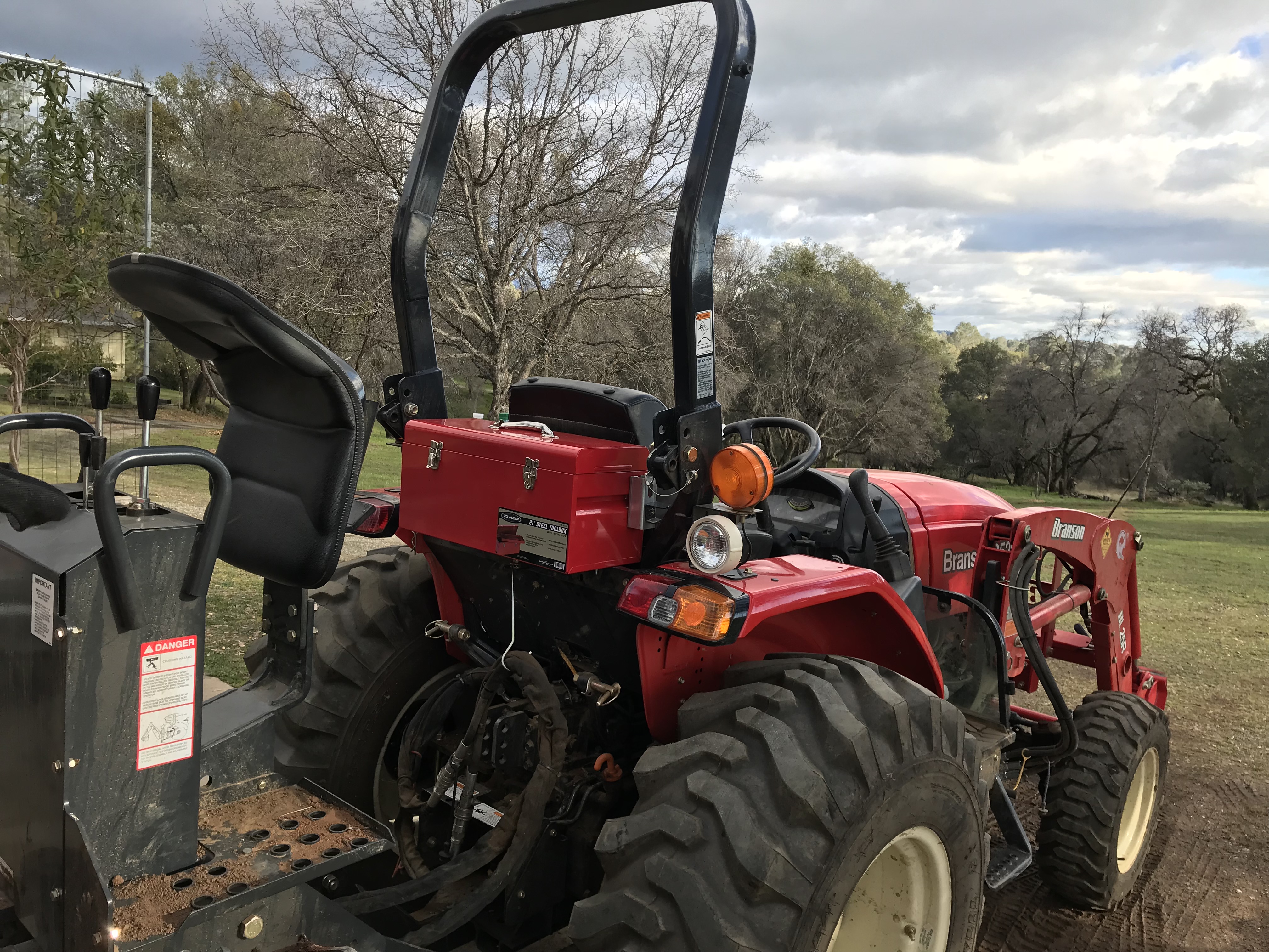

Tool Box Install:
Harbor Freight 21" Tool Box, 3/8" stainless hardware, strut and strut nuts. It's long enough for the longest metric wrenches needed on the tractor.

It's plenty sturdy but I'll probably add a sole plate the same footprint as the toolbox to minimize any racking when the box is full. But it's good as it is right now. And it's a perfect match for the Branson red. :thumbsup:

Thanks very much.
I'm happy with how it turned out. I've got two pretty long lengths of 3/8" chain and two large combo wrench sets in there as well as some other stuff. It all fits well and the box isn't flexing at all.
To my "slow moving vehicle" triangle I attached some rare earth disc magnets and stow it behind the seat. If I take the tractor on the streets I just slap the triangle on the ROPS and that triangle ain't going nowhere. I'll post some pics when I get a chance.
I also moved the small work light over a few inches to make room for the toolbox.
