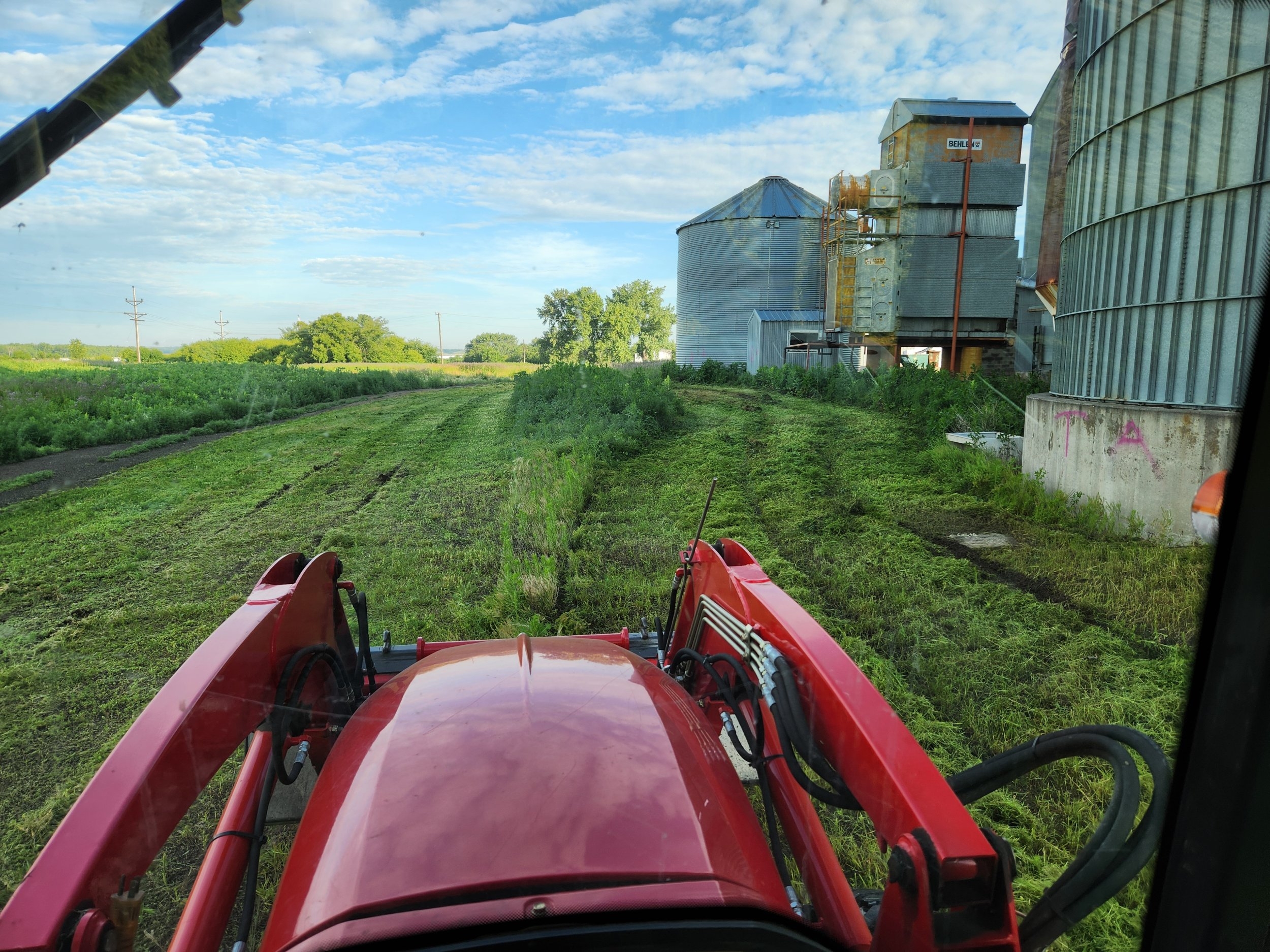

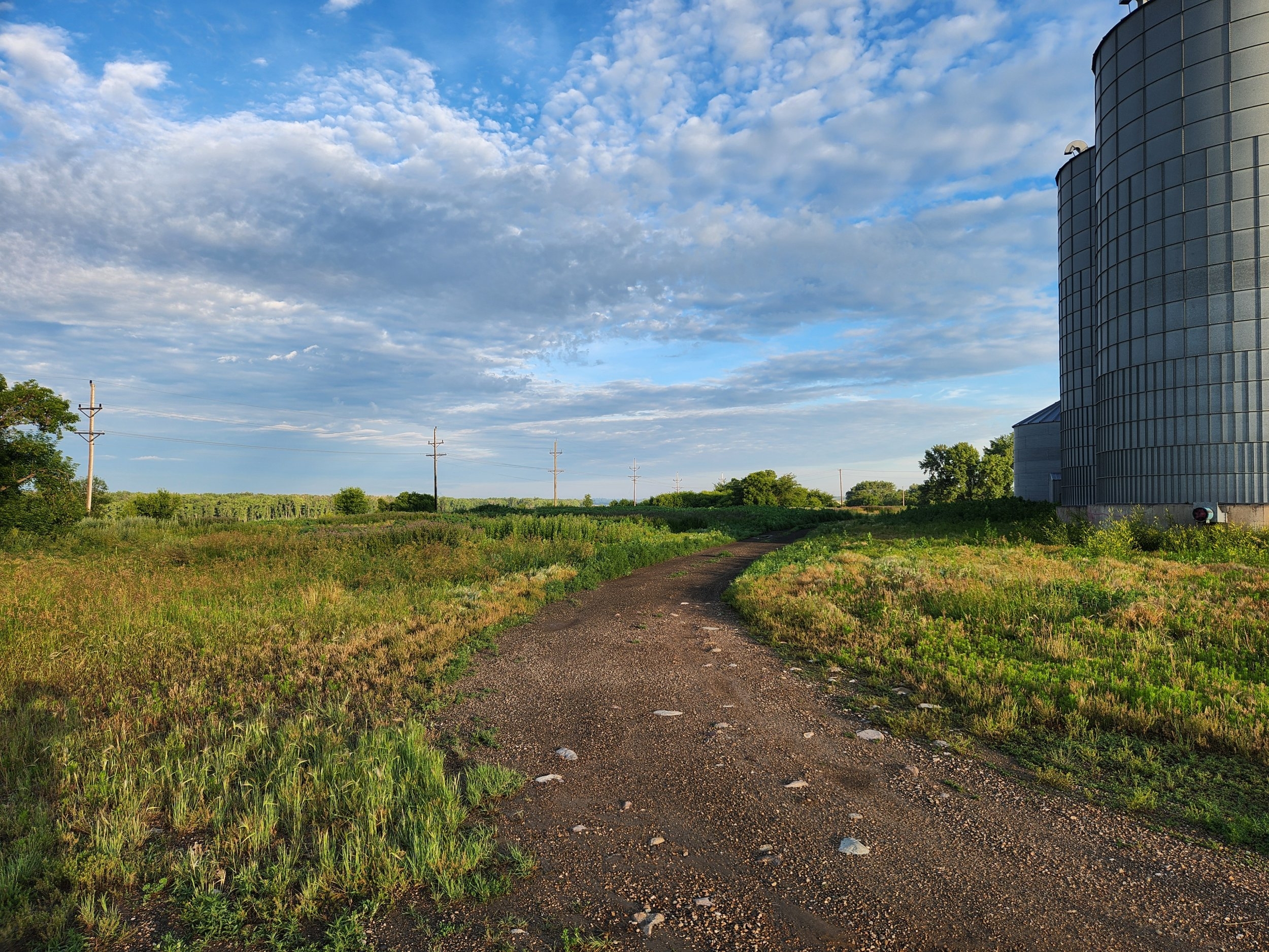

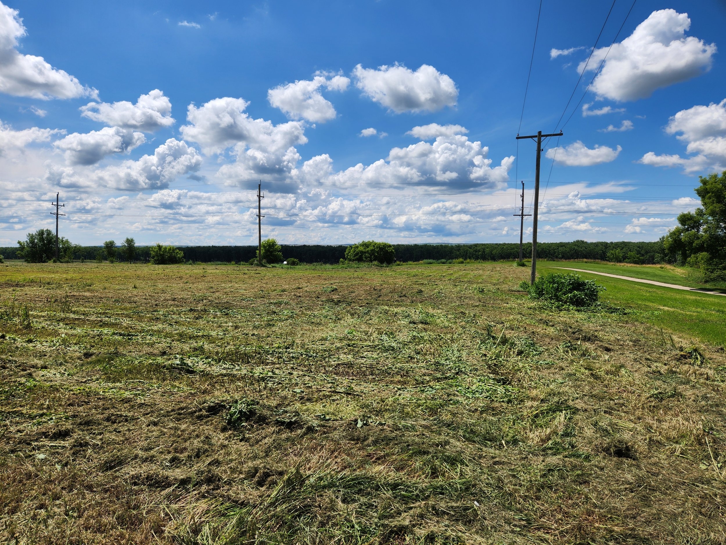

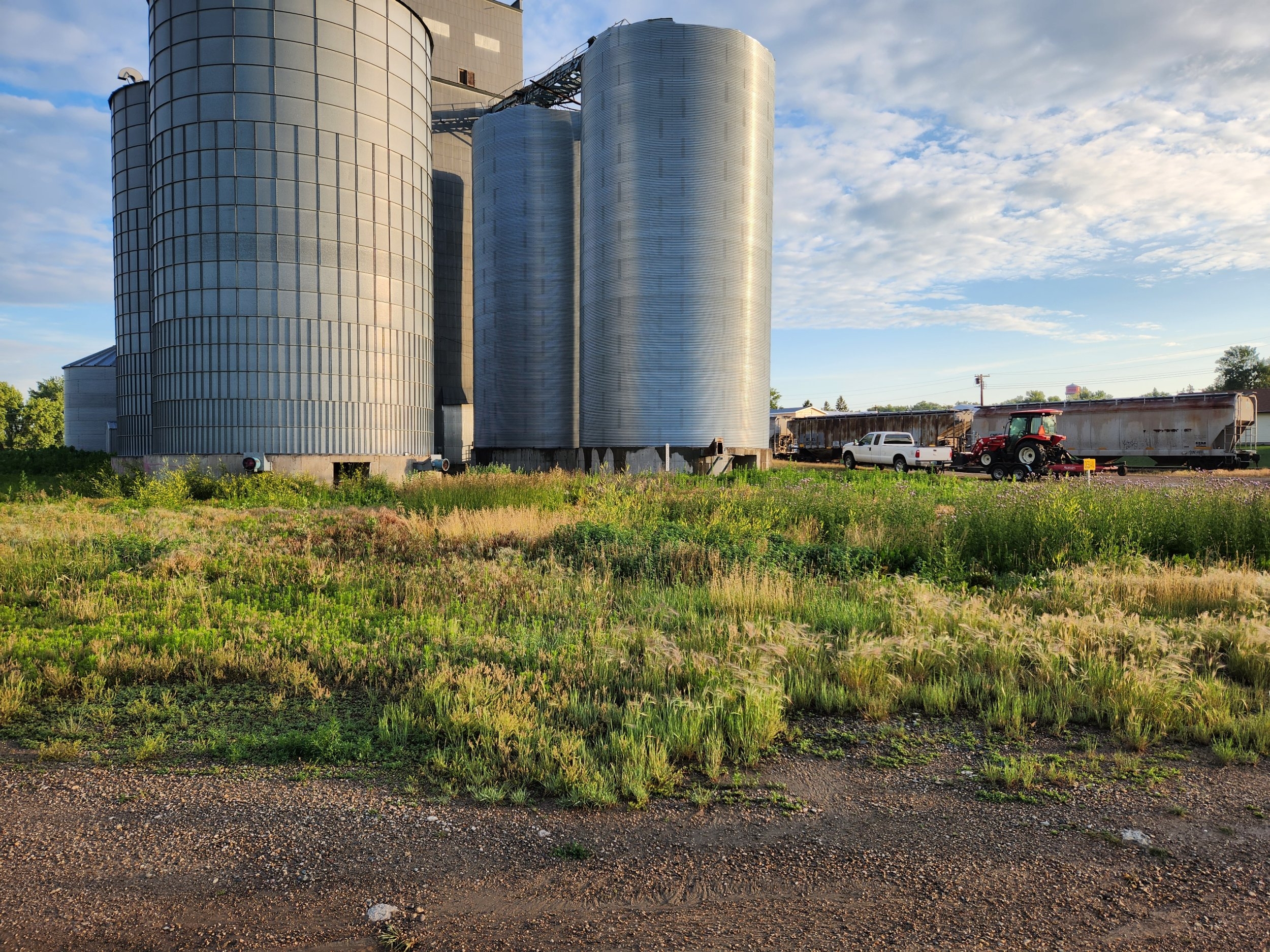

Took care of a small mowing job today. This was a site I first did 2 years ago, the one with the "ten foot tall weeds". They called me to come back this year, and also wanted me to schedule them to come twice a season starting next year and just put them on my permanent schedule. This year the weeds were only up to six feet in places, so not bad.
A few "before" pictures...
Did the trimming around the silo's and buildings first...

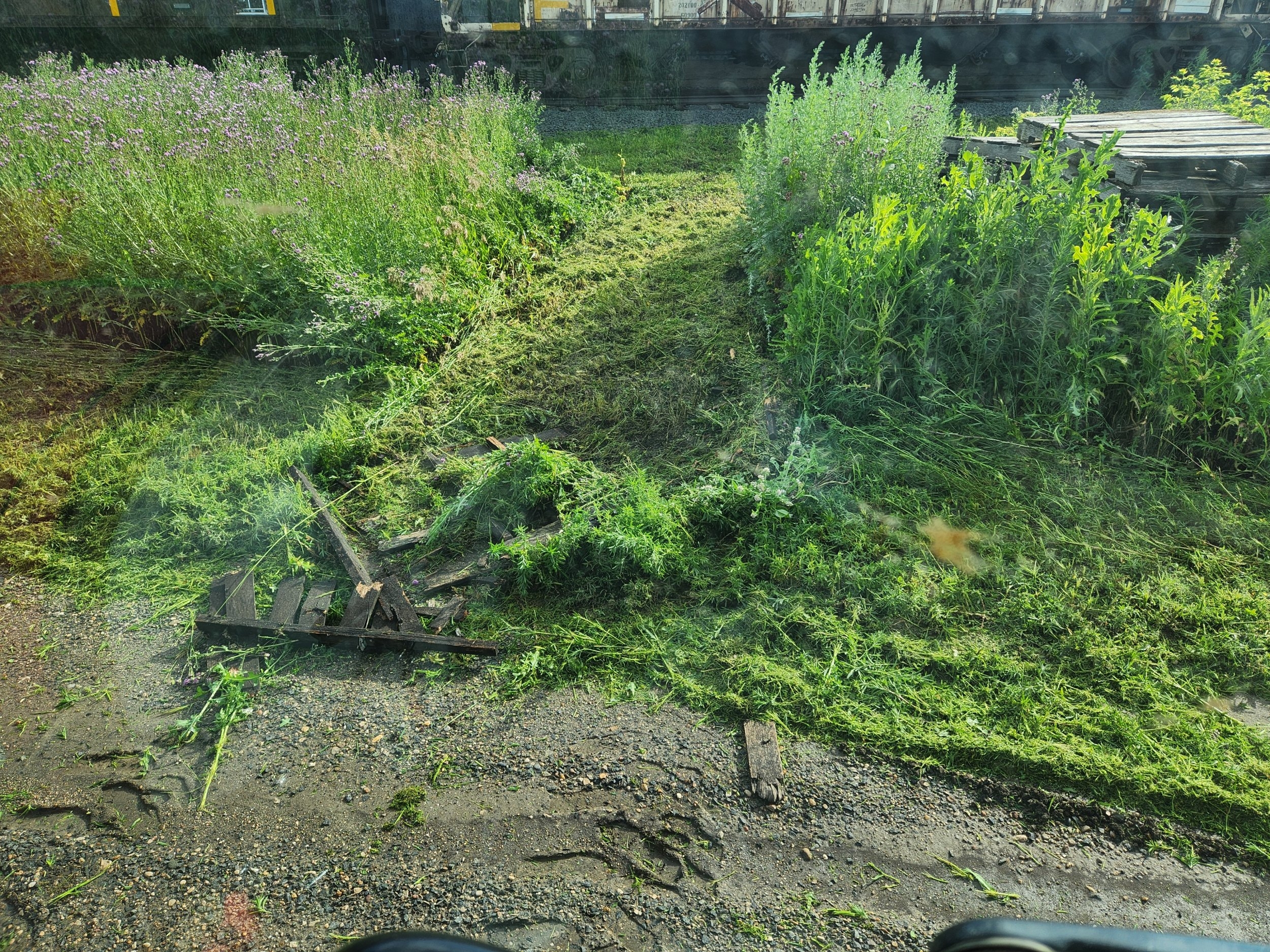

Only broke one shear pin, on this piece of concrete. You can see where it had been originally laying in the bottom center of this pic, and where it landed after being swatted by the mower blades...
Found another pallet in the weeds. That one used to be on the stack to the right, but "fell" (or was pushed) off. Bucket went right over it, but the mower found it. That was a bit noisy for a minute.

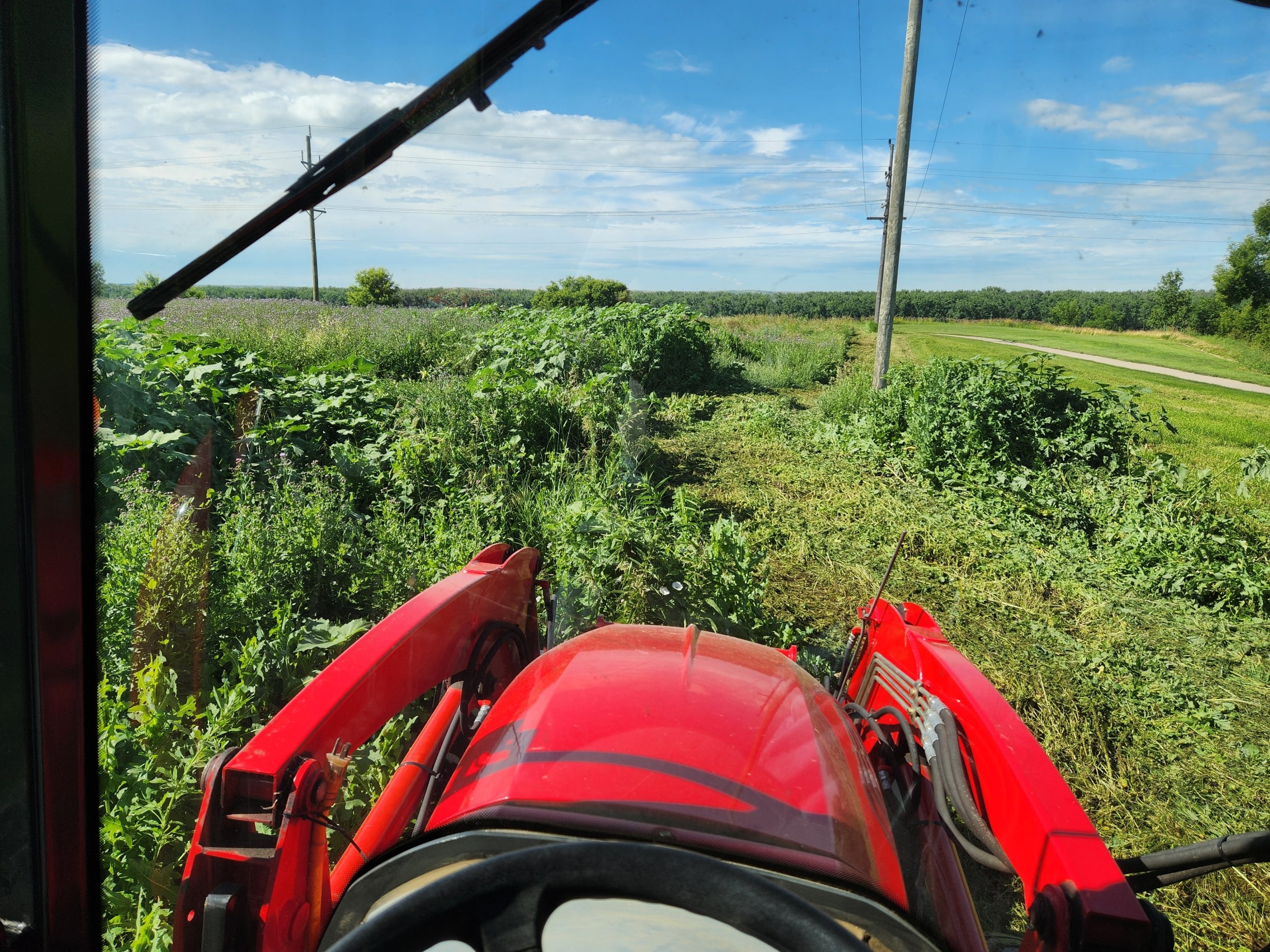

These weeds up ahead are hovering around the 6' height mark... (they were the ten footer's 2 years ago)
A couple of "after" pics...
   / What have you done to your Branson today? #1,673
That was a 5 acre site, and I burned just over 6 gallons of fuel cutting it. Everything was soggy-wet, which actually helped keep the chaff down to a minimum.

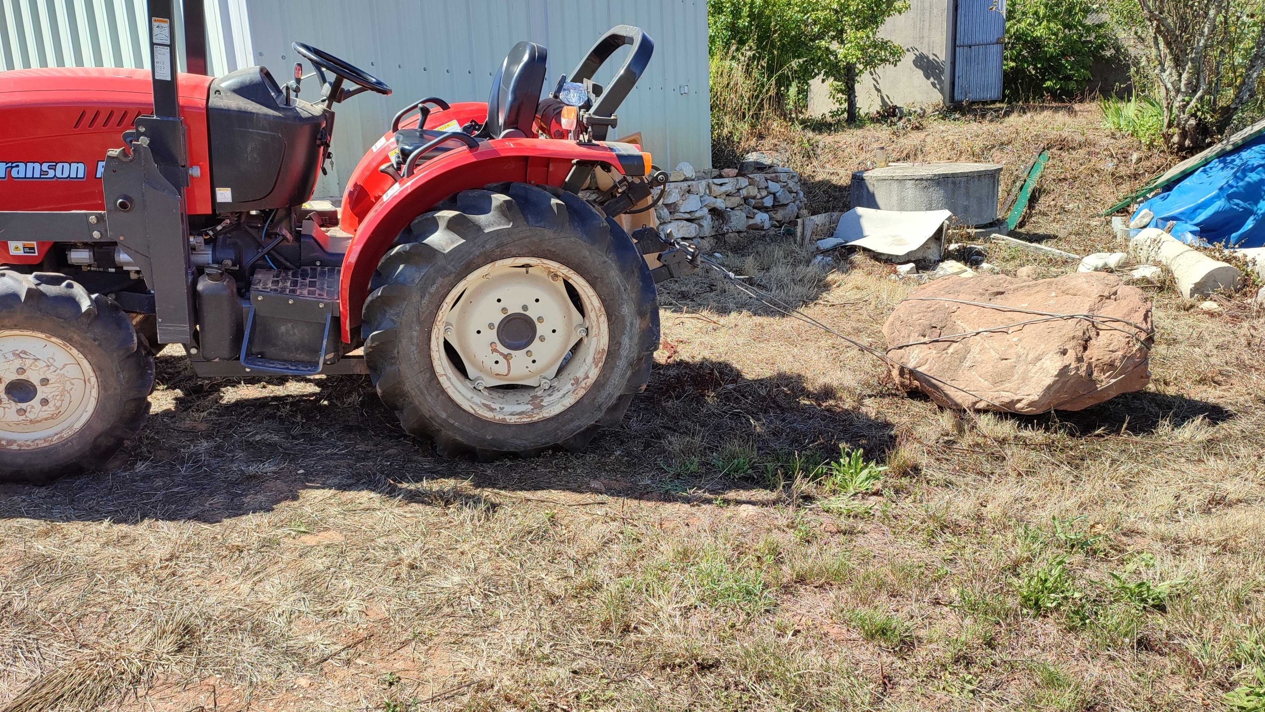

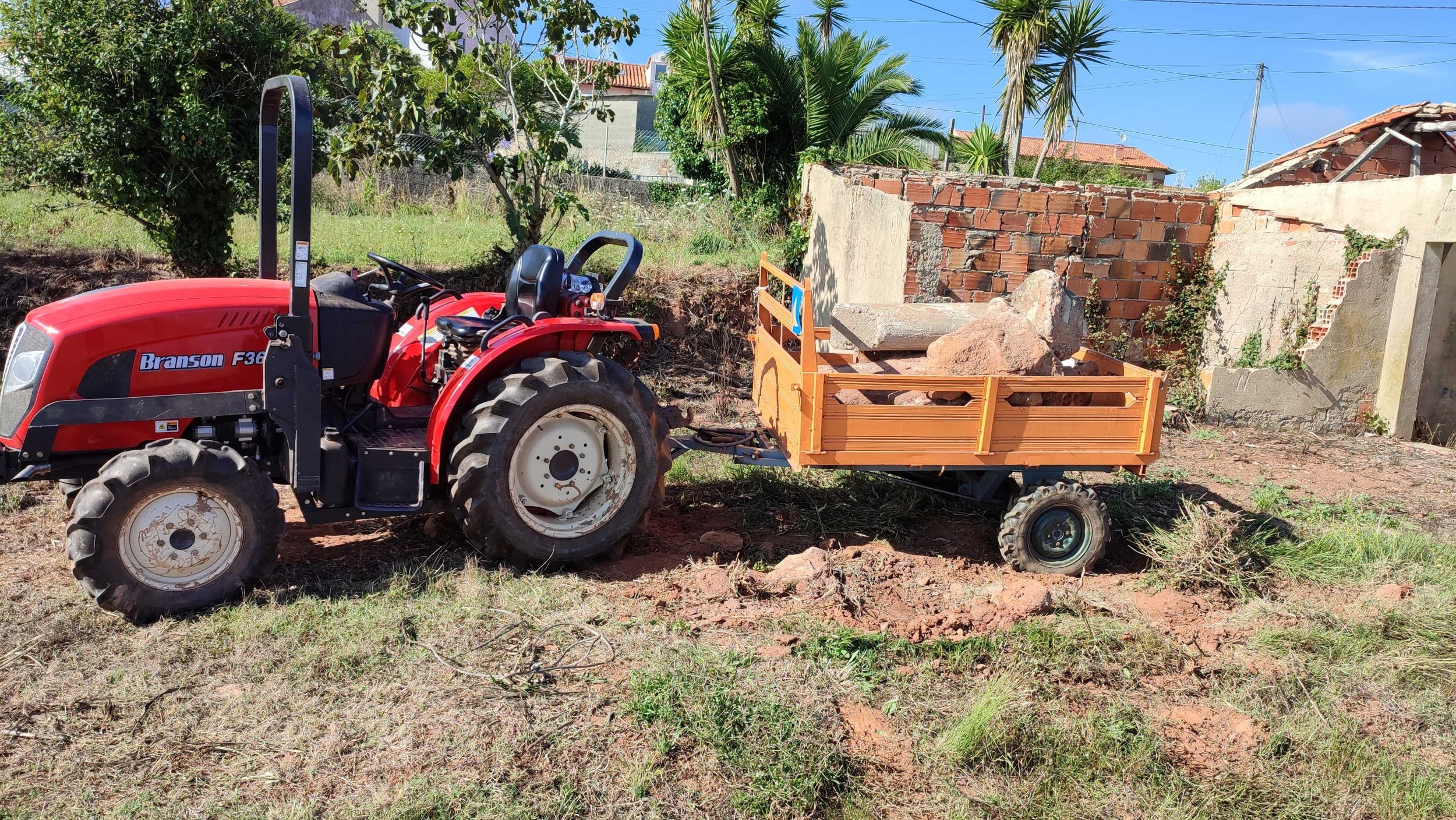

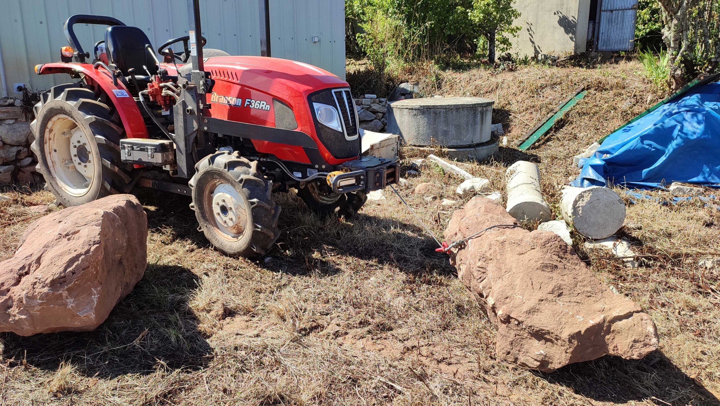

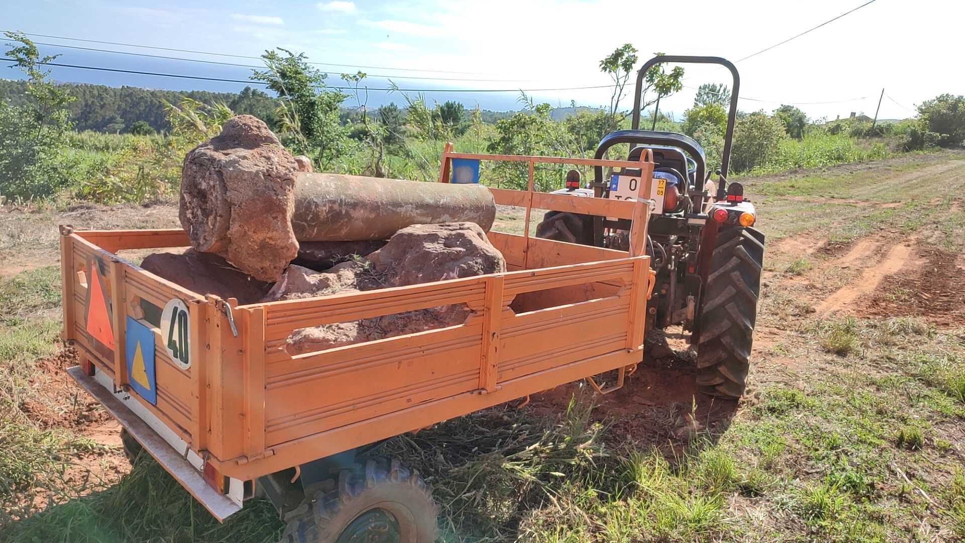

Today I started by moving (more like dragging) a big rock:
Then a smaller one:
Then the biggest one of the bunch. This tractor just pulls so hard. It's hard to see but it's slightly uphill, the tractor just pulled it very nicely, just a tiny bit of tire slippage.
And finally, the rest could be loaded on the dump trailer with the backhoe since it was able to lift those.
