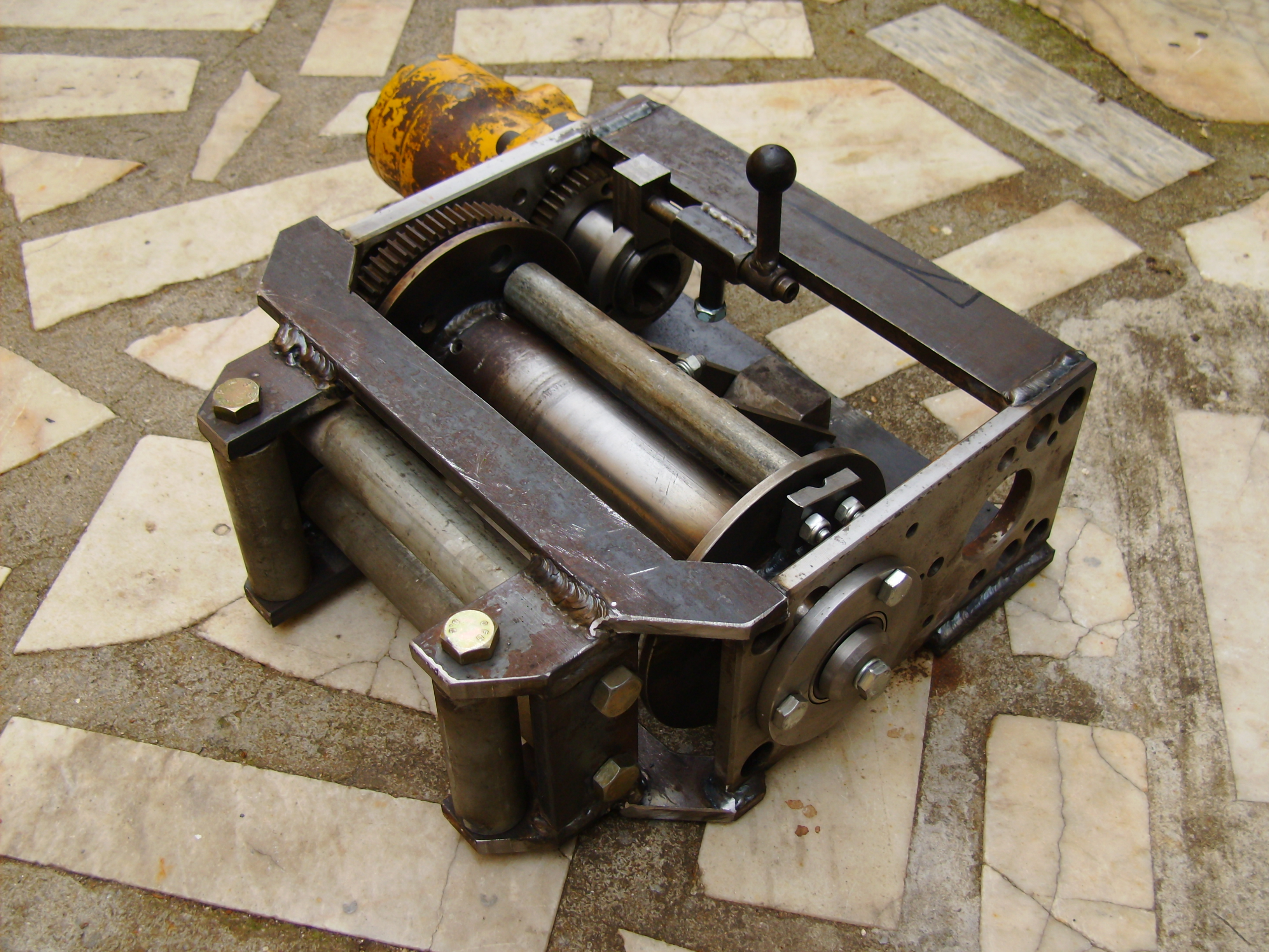

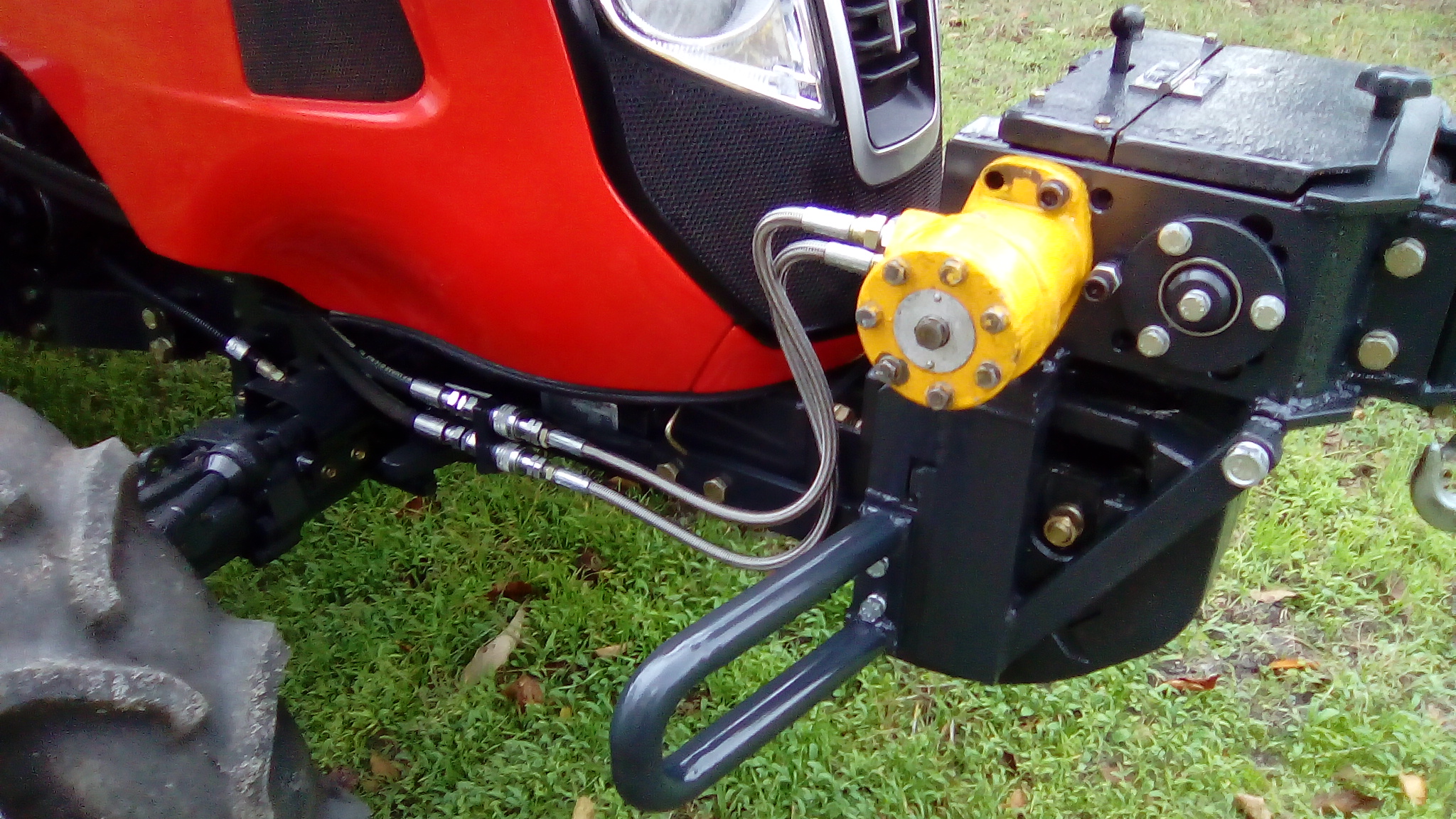

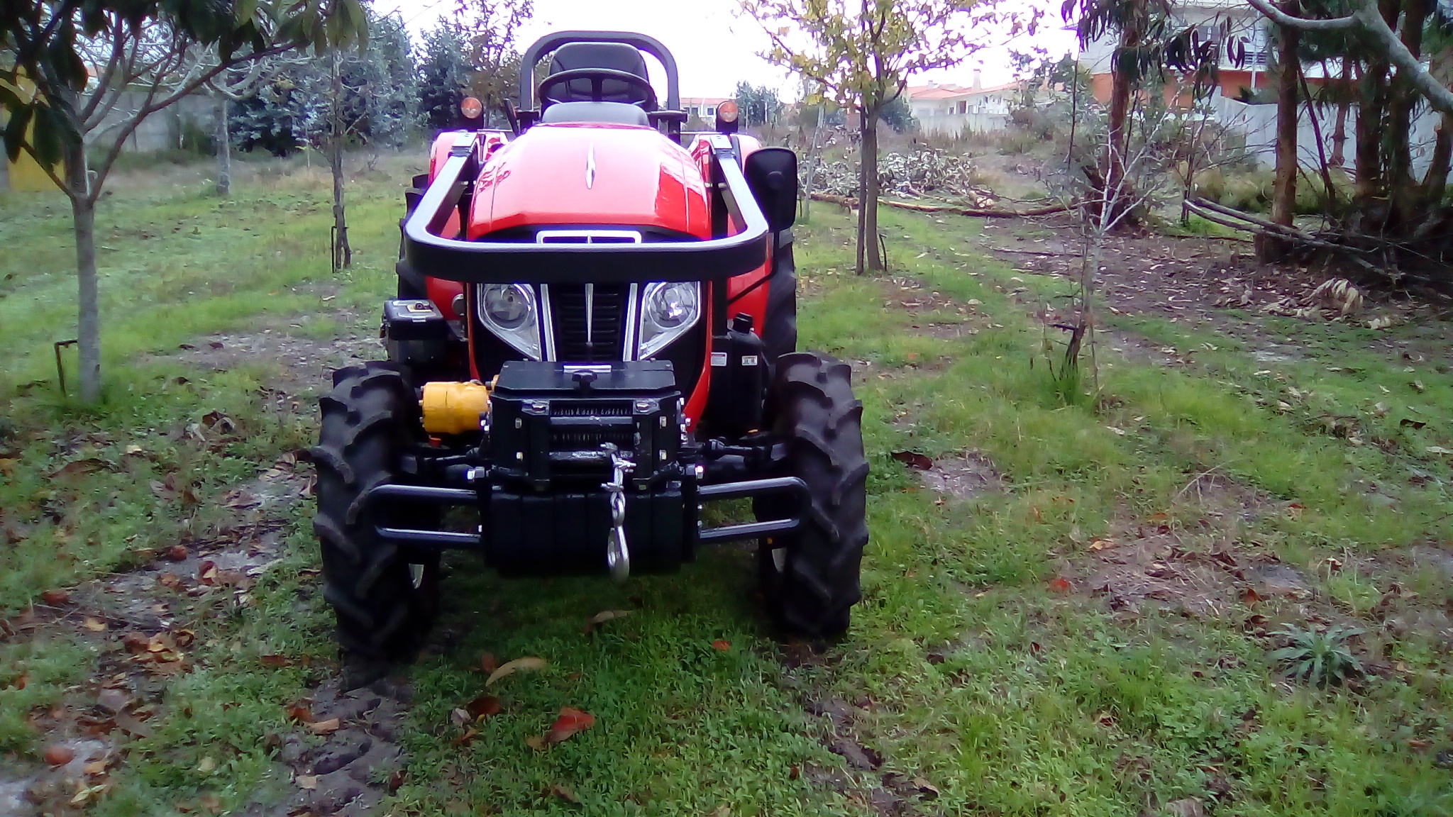

Today I've assembled a 6000lbs hydraulic winch that I made on my Branson. I built this winch mostly to have as a backup plan. Since most of my work is done on some steep hills with some hidden holes and such, I find my self on situations that requires a lot of diff lock work and I've been getting away with it but I want to have another place in case the diff lock doesn't make it.
I've also mounted a toolbox on the tractor. It's probably the most requested item that any Branson owner has. I'll post some pictures of the winch. I need to take some better ones of the toolbox, winch and tractor but the weather is not cooperating.
