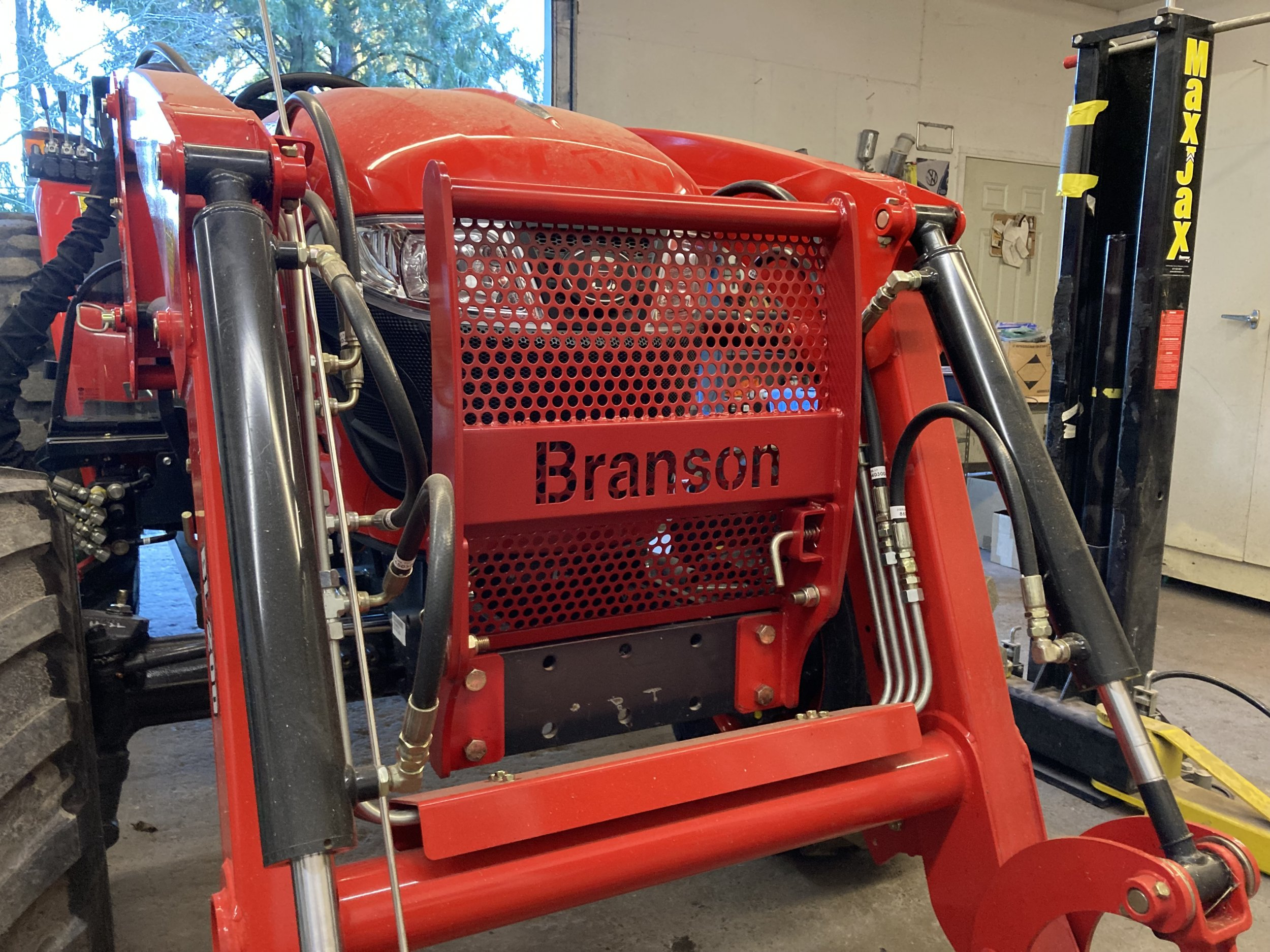

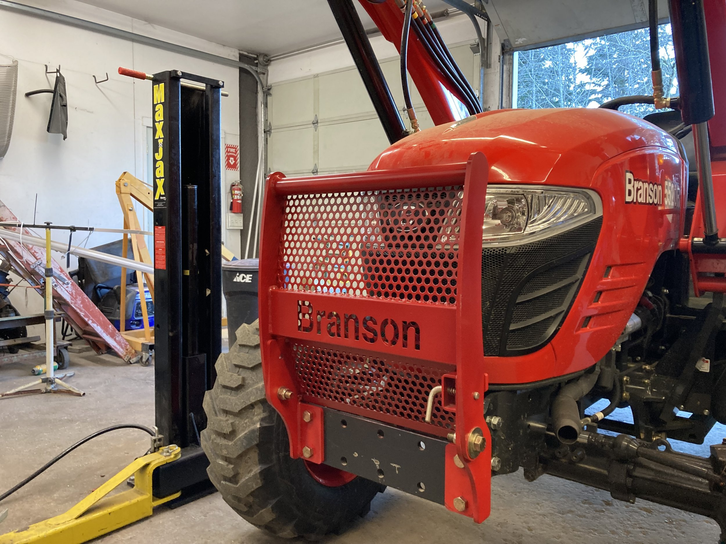

Last Spring I was burning some very large brush piles. I was using my pallet forks to re-stack limbs and small tree trunks as the center of the piles burned out. The factory grill guard while being a stout unit has some rather large holes in it. I took a large spruce limb directly to the steel chin just under the plastic grill. The damage was too severe to make a proper repair and get the hood to properly seal against the lower bulb seal just in front of the battery. The replacement piece was $100 by the time it arrived at my door.
So rather than have a repeat this spring when the burning begins I decided to fill in the grill guard buy welding a couple of pieces of perforated steel to hopefully prevent this from happening again.

Been there myself.....

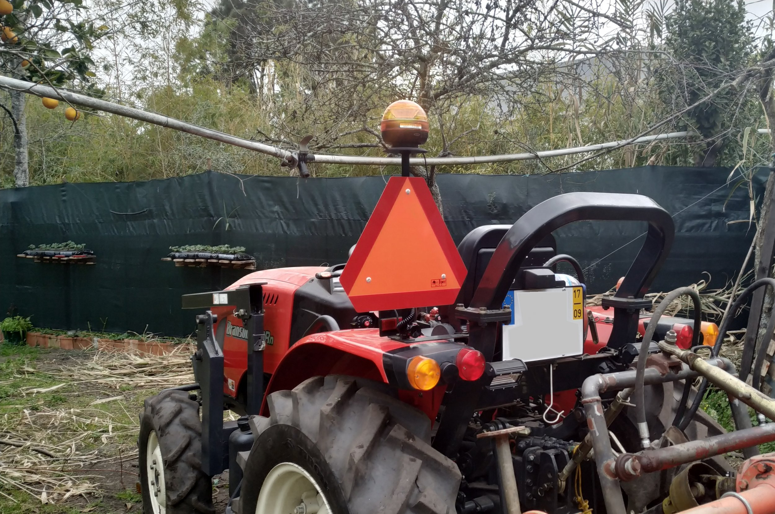

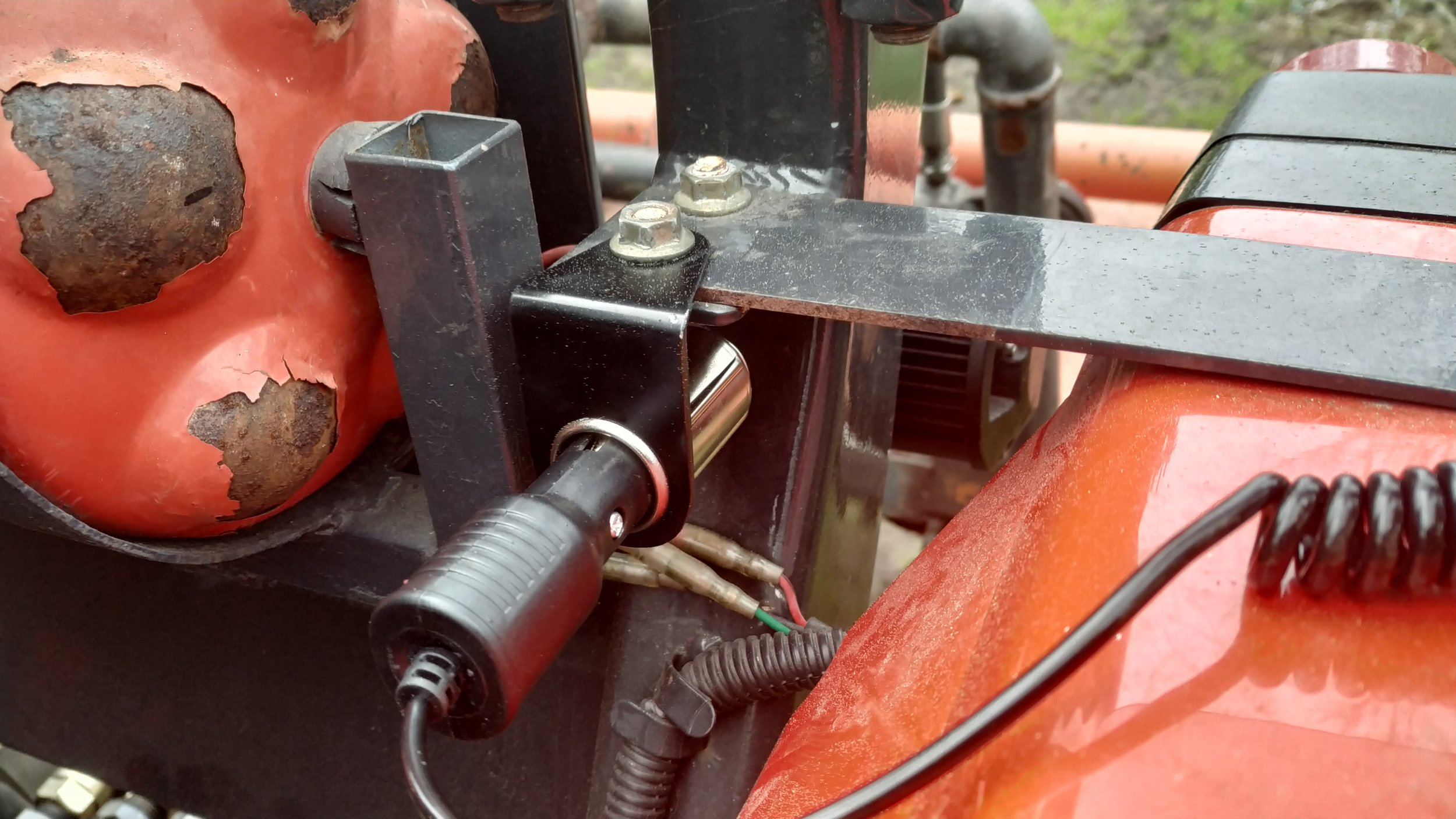

Bought and mounted a LED magnetic beacon and SMV sign the other day. Just had to fabricate a support and machine a stub for the support to mount on.
Made the support removable otherwise so it doesn't get destroyed when working near trees. Also added a 12v socket near the left rear light, close to the beacon and there was an ignition On wire already there from factory waiting for it.

Very nice install! You always do great work my friend!
   / What have you done to your Branson today? #1,019
Good job! (on the install and the post!)
I would probably start having seizures if I had to see a flashing light all day. I should rarely need to go on a road and property is on a lightly traveled county road...
   / What have you done to your Branson today? #1,020
Thanks my friend!
Thanks! Yes, you're absolutely right about the flashing. I felt the same way. The beacon has three flashing modes and I did change to the rotational pattern right after the pictures, it's much easier on the eyes as it doesn't light up all the LEDs at the same time.
